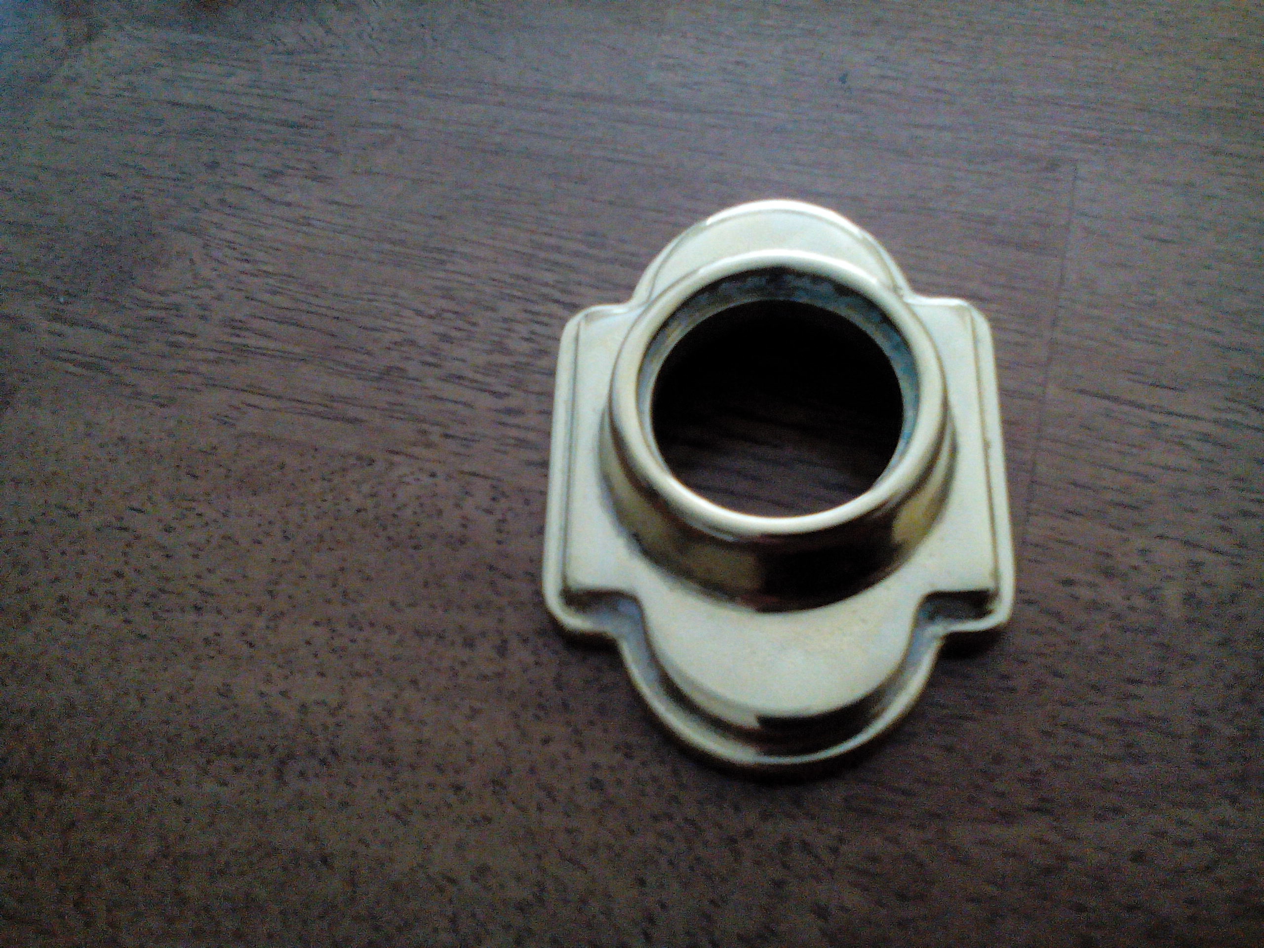

I decided it would be easier for me to remove the entire arm, cut the torn bushing out and utilize old entry door hardware( I borrowed off of a friend who had recently redid their house)that allowed an inset for the protrusion on each end of the bushing and a couple bucks for the threaded bolt, nut and 4 large washers.For some reason, Lowes, home depot, ace, etc.didn't have anywhere near the correct diameter pipe flanges that have been listed in the write ups, so I got creative. Worked like a charm. Didn't even faze the brass hardware. I love repurposing Lol.

Awesome!!PS78 wrote:I decided it would be easier for me to remove the entire arm, cut the torn bushing out and utilize old entry door hardware( I borrowed off of a friend who had recently redid their house)that allowed an inset for the protrusion on each end of the bushing and a couple bucks for the threaded bolt, nut and 4 large washers.For some reason, Lowes, home depot, ace, etc.didn't have anywhere near the correct diameter pipe flanges that have been listed in the write ups, so I got creative. Worked like a charm. Didn't even faze the brass hardware. I love repurposing Lol.

Truthfully it took about the same time to remove the bolts securing the arm and complete the repair. I was considering just having a shop press the new bushing in, but then I concocted my method. Removing the arm also allowed me to cut the old bushing out without creating debris in the engine compartment, as I did the cutting with newspaper underneath and simply discarded the remnants.I like your method and if I had been in possession of the set you mentioned for tile I most likely would have utilized it also. A lot of members have attacked this task with creative and sometimes unorthodox methods and its cool to see individual ingenuity at work
