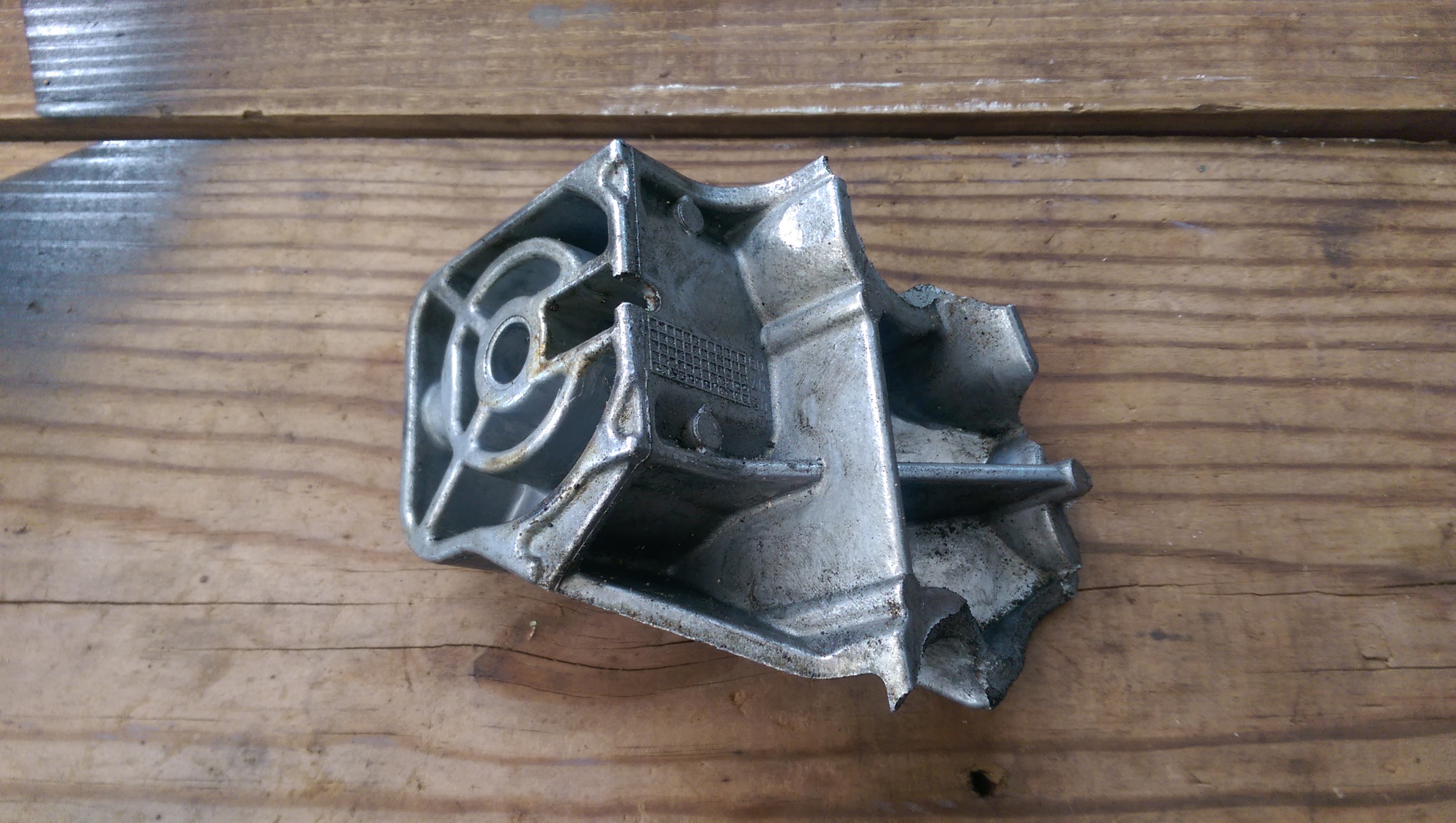

And she came back to life!
It was the front E Mount which was broken and was touching the wiring around the starter- every time a Volvo comes back to life you get the ultimate satisfaction- the insurance people were trying to put you in the Junk yard, but you are going back to life, to the busy streets, to transport our precious children!
