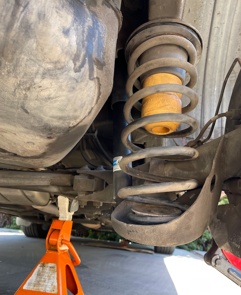

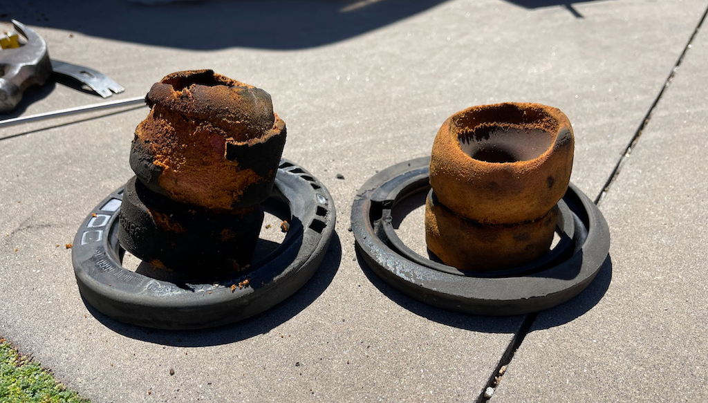

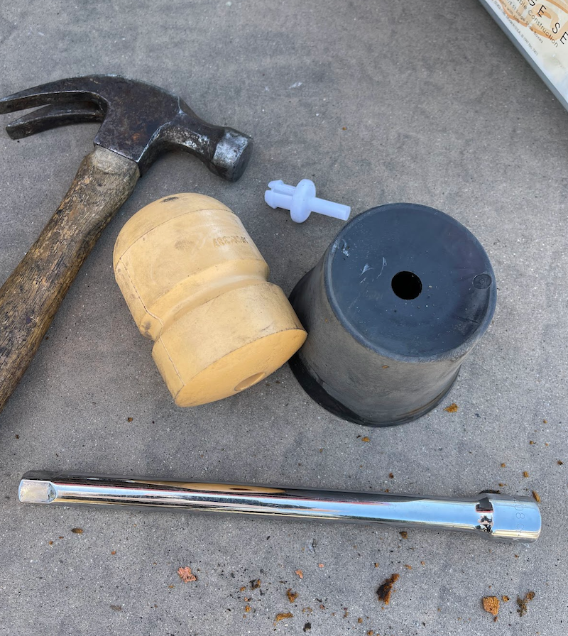

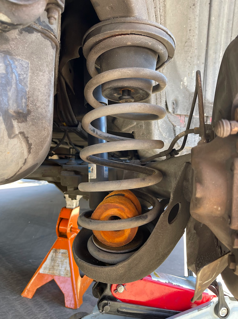

First, here is what I saw when I went under the car to do some brake work. The stop had fallen and was just banging around the spring. The new stop is easy to install once you get the spring off. Loosen the rear shock, remove the nut on the lower mount, and then you can lift out the spring. To install the new stop, I used a socket extension to bank on the pin of the clip, which expands the other side and fastens it. Here's the new stop installed in the spring. Here's what got replaced. I'd say over 23 years is way beyond the expected lifespan. As you can also see, I replaced the rubber spring seats. May as well while I am doing this work. I think this took me all of an hour to do and I was going slow and taking pictures.
