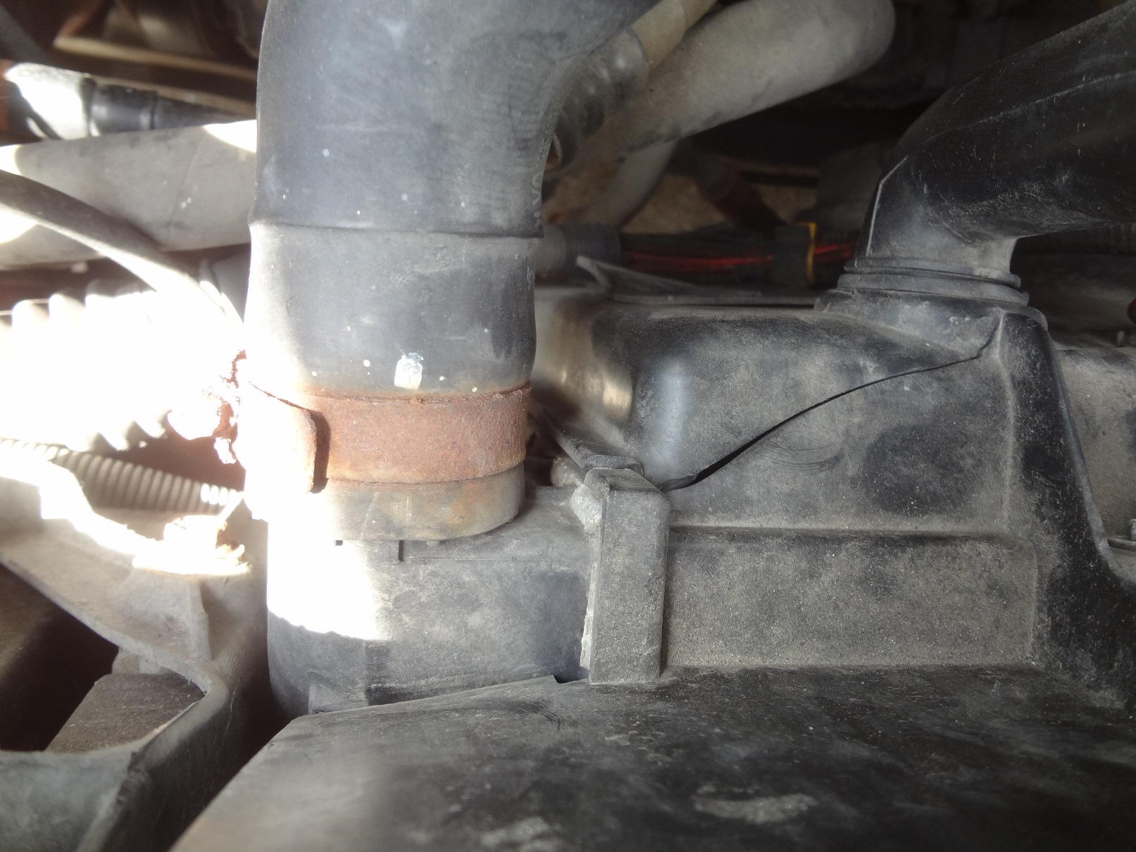

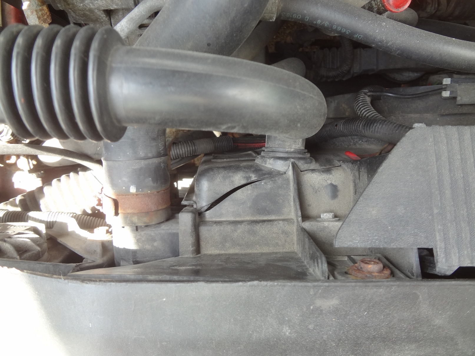

Can someone please identify this part (I'd call it an air box)? I'm still getting codes for an O2 sensor, which I replaced, but I'm wondering if this cracked part is causing a vacuum leak that is triggering a code for the O2 sensor. Any suggestions on how to repair this thing? Thank you! Todd

That's actually part of the radiator fan shroud. And it wouldn't cause an O2 sensor code. As for fixing it, replace it or tape would do the trick.

It simply vents air over to the ECU box

It's basically an air box, all it does is send cooler air from the front to the computers. Won't set any codes but should be fixed/ taped to get as much cool air to the computers as possible. Will end up a bit more costly then just some CEL code.

Disconnect what you need for access, clean the area around the crack and use a good epoxy or other adhesive to seal the entire breach.
