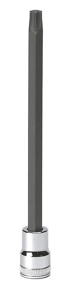

I used one of these:
https://www.amazon.com/Gearwrench-Skt-T ... +t-40+LONG
Attached to a 3/8 breaker bar, with lots of PB, and heavy and even downwards/outwards pressure. Bolts came off nicely. I replaced them with my own water pump housing bolts.
