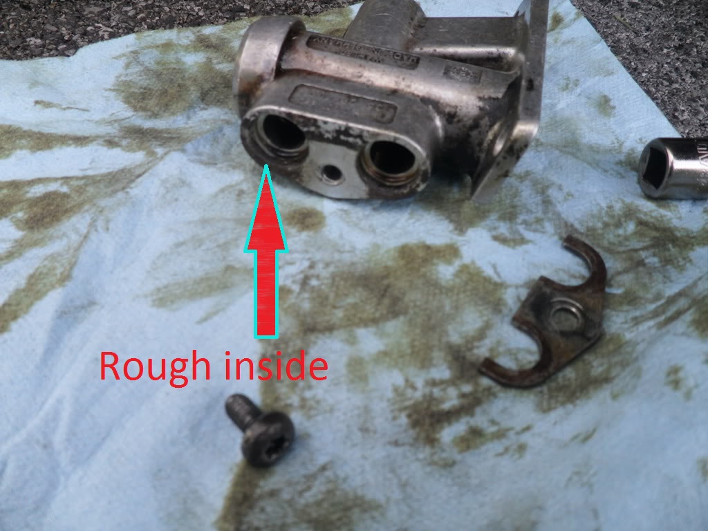

Update: I removed the oil lines and both green o-rings were torn and they were brand new! I noticed the 'lead-in' for the o-rings was rough due to some corrosion, i filed it smooth. I think the issue is when the o-rings are getting pushed in, they got torn.
Questions: has anybody inserted the green o ring into the thermostat and then pushed the lines into the thermostat. I tried but I couldn't do it! This would avoid any rubber o ring failure?
For those who insert the o-ring onto the oil line, does the bracket and screw fully seat the o-ring, or are you able to do it just by hand.
Did anybody notice any corrosion and sharp edges on the thermostat like I did?
This stupid thing is making me mad. I also ordered a new bracket 3528200 because it wasn't allowing me to insert the lines with it installed, when I removed it I got the lines in. I'm hoping a new one will cure this, I don't want to waste any more time on this, I think the Volvo gods are trying to punish me for the curse words last night

I sanded the lead-in area for the o-rings to prevent them from getting damaged. The thermostat is aluminum I believe so it doesn't take much force and make sure you use a fine file or sandpaper. It appears to have worked, there is no leak. Because it sits low and is exposed to moisture, a rough surface develops not only on the lead-in for o rings but also the mating surface for the bracket, I also sanded it smooth.
I think that is why others have complained, the o-rings get damaged upon installation or they have a leak after installation. You can't see the damage to the o ring unless you remove it and look close.
I also purchased a new bracket which I highly recommend as they start to bend and weaken after repeated use, it was only $5. The bracket sits nice and flat and has no bend to it.

And like mecheng (post above mine) says, the thermostat cleaning took me a solid 2 hours. Brake clean - nope. Baking soda/vinegar - nope. Easy off - nope. Gunk grease remover - nope. WetandDry sandpaper (2000 grit) - nope. Finally gave in and got out the emery cloth and even then it took me an hour to smooth out the entry to the thermostat for the O Rings.
Like I said though - no leaks so hopefully same way in a week, and a month, and a year etc.
