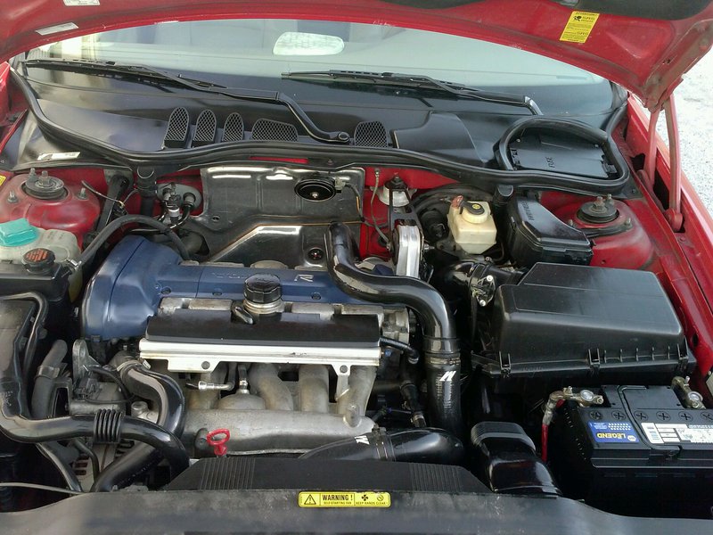

I have their intercooler hoses and they are tight but if you trim the inside layer to a conical shape with a sharp razor, they give in and slide over the piping. You won't have much luck if you don't trim unless you put them in hot water minutes before installation which I didn't try. I also reused stock clamps without issues so far (12psi).
Oh, and by the way, oil the lip of the hose either a drop or spray a bit of WD40 to make the job easier.
EDIT: I saw the previous reply from PolskaMafia talking about cooler hoses but anyway the silicone hoses I have are very well built so I wouldn't hesitate to get the coolant ones.

RigsPGT very nice engine bay!
