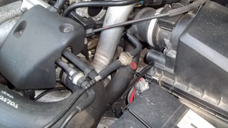

Now I remember. It's that little red cap attached to the hose in the center of the photo.
Lower rad. hose.jpg (61.87 KiB) Viewed 5666 times
Still can't help with the size as I've never had reason to remove mine. But maybe the photo will help somehow.
I'm curious why it was removed or broken? I've never had a problem with air in my cooling system. Maybe I'm lucky?
