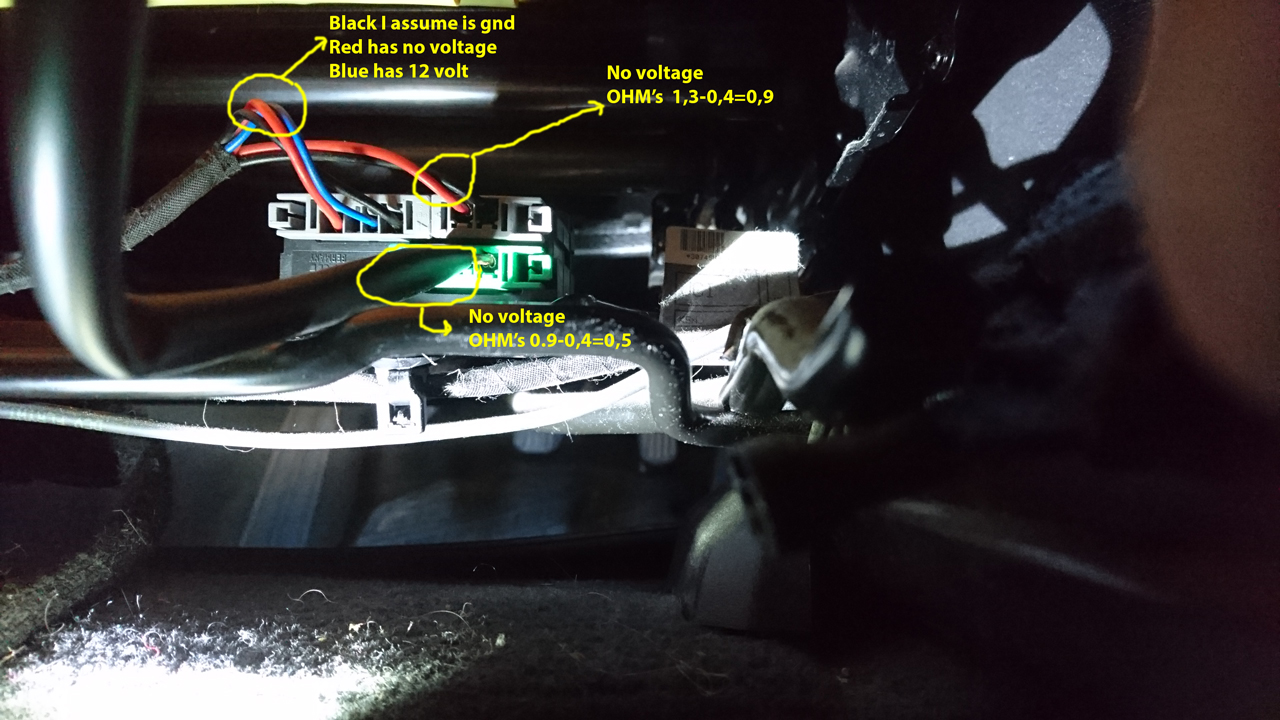

doublebug,do you think that replacing the seat heater control module might be enough to get the seat heater working again?

Seem so but after replacing CCM identification should be done via VIDA.

With this information can we surely say that with 99% chance it is the module since they are rather expensive.

These modules are often faulty and cause CCM to malfunction.

off cause you need to check power first :)
