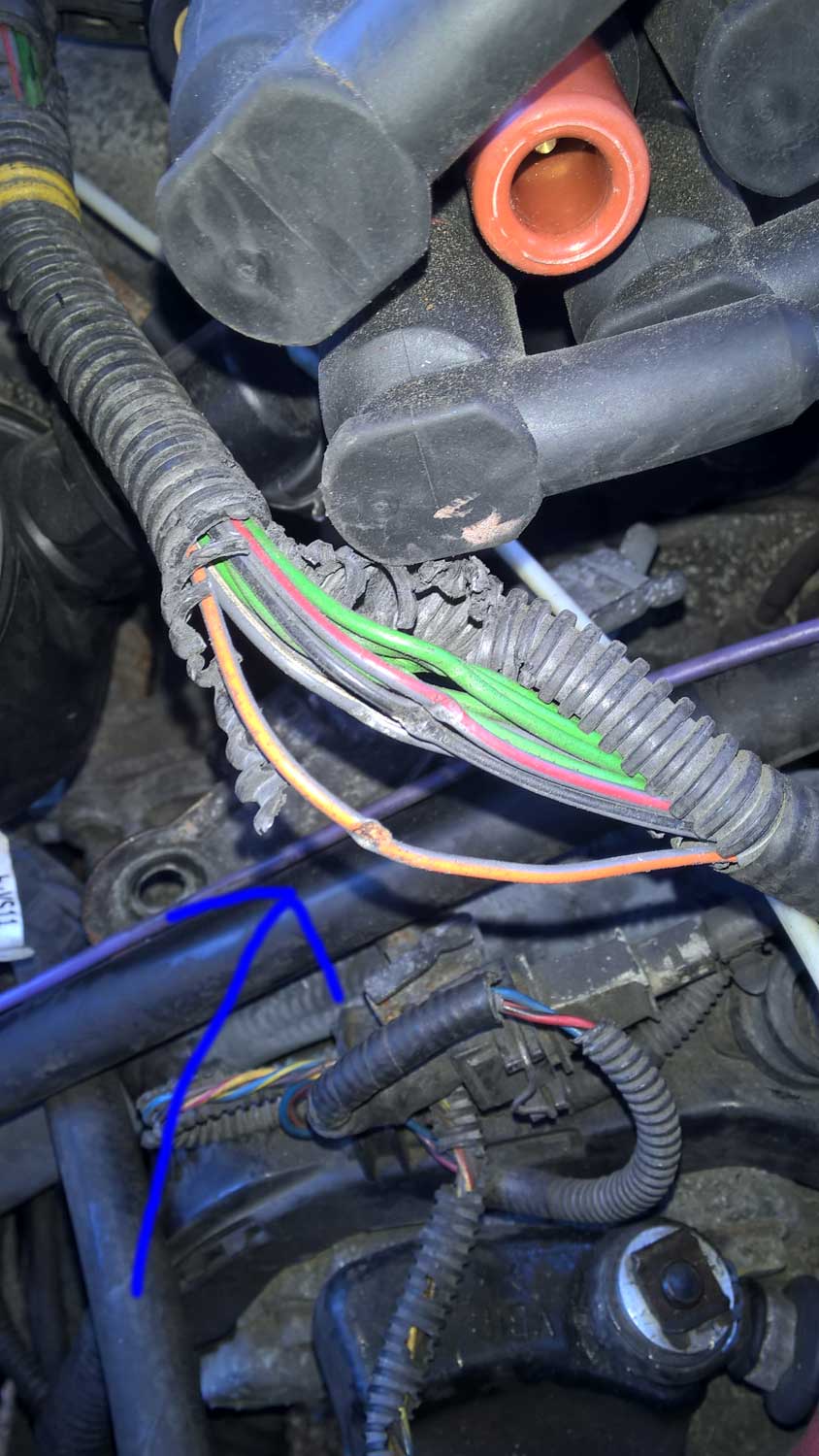

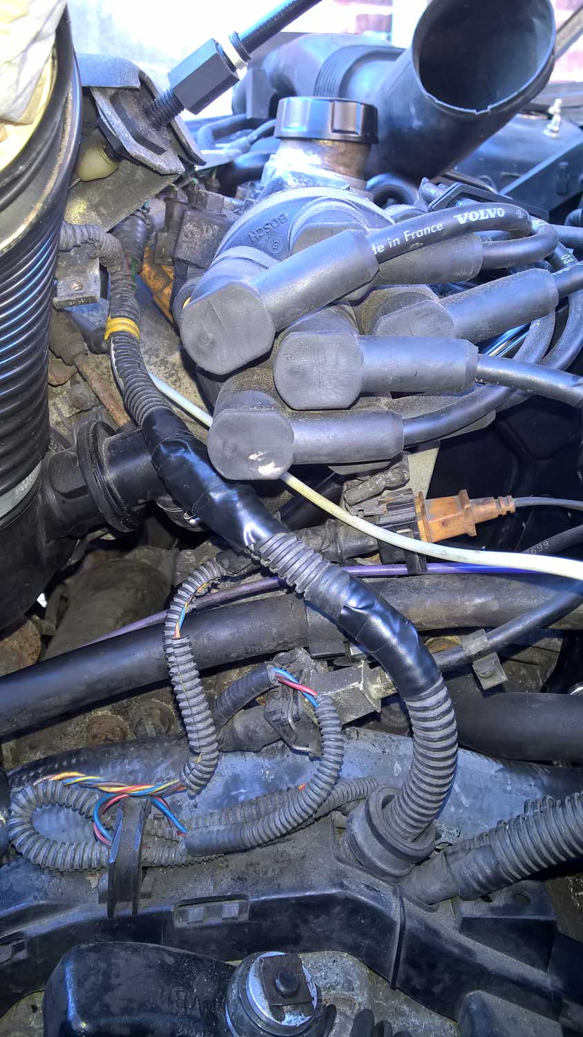

So I finally had the time to check this out...
When I had installed my new torque arm bracket, I noticed that I really had to push hard on it and the wires around it in order to get it to seat... Well, this was why.
I'm lucky I didn't sever any wires. I used good quality electrical tape around each wire, even the ones that hadn't been cut into. I know this might cause some interference issues down the line. But I'm going to wait on splicing and soldering wires for the time being. I was able to turn the car on after I separated the wires that had been cut into. No instant P0264 code. And the engine sounded like it's always sounded.
I did, however, get some smoking... Probably from extra fuel that was sent to the #2 cylinder that had the short? I drove it 5 miles to get it inspected and by the time I got to my mechanic's shop, it had stopped smoking...
If you look below, this is how the cables are supposed to be routed. Not under the torque arm bracket... :roll:
Thanks for the support, everyone!
