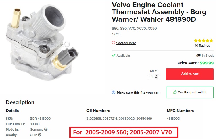

I have opportunity to buy brand-new 2004-2006 S60 stat for inexpensive price but browsing FCPEuro website etc., it looks like Volvo posted 2 separate PNs for Thermostat: 2002-2004 S60 vs 2005-2009 S60.
I put together photos so you can see.
Same engine, same 90-degree C tstat etc.
Does anyone know the actual differences are?
PS: I just want to get the inside tstat itself and ECT from let's say 31219205 and swap into my 2007 S60 car.
Just want to know the differences (other PNs). This is a good example that Volvo came up with so many different PNs for basically the same item.

The mounting flange to the block sure looks different to me

@abscate,
That is optical "illusion" from the photos.
The moumnting flange to the block should be the same bc the Metal Gasket PN 8636573, is listed for all 2002-2009 S60 and 2003-2007 V70 P2 cars:
https://www.fcpeuro.com/products/volvo- ... 73#fitment
