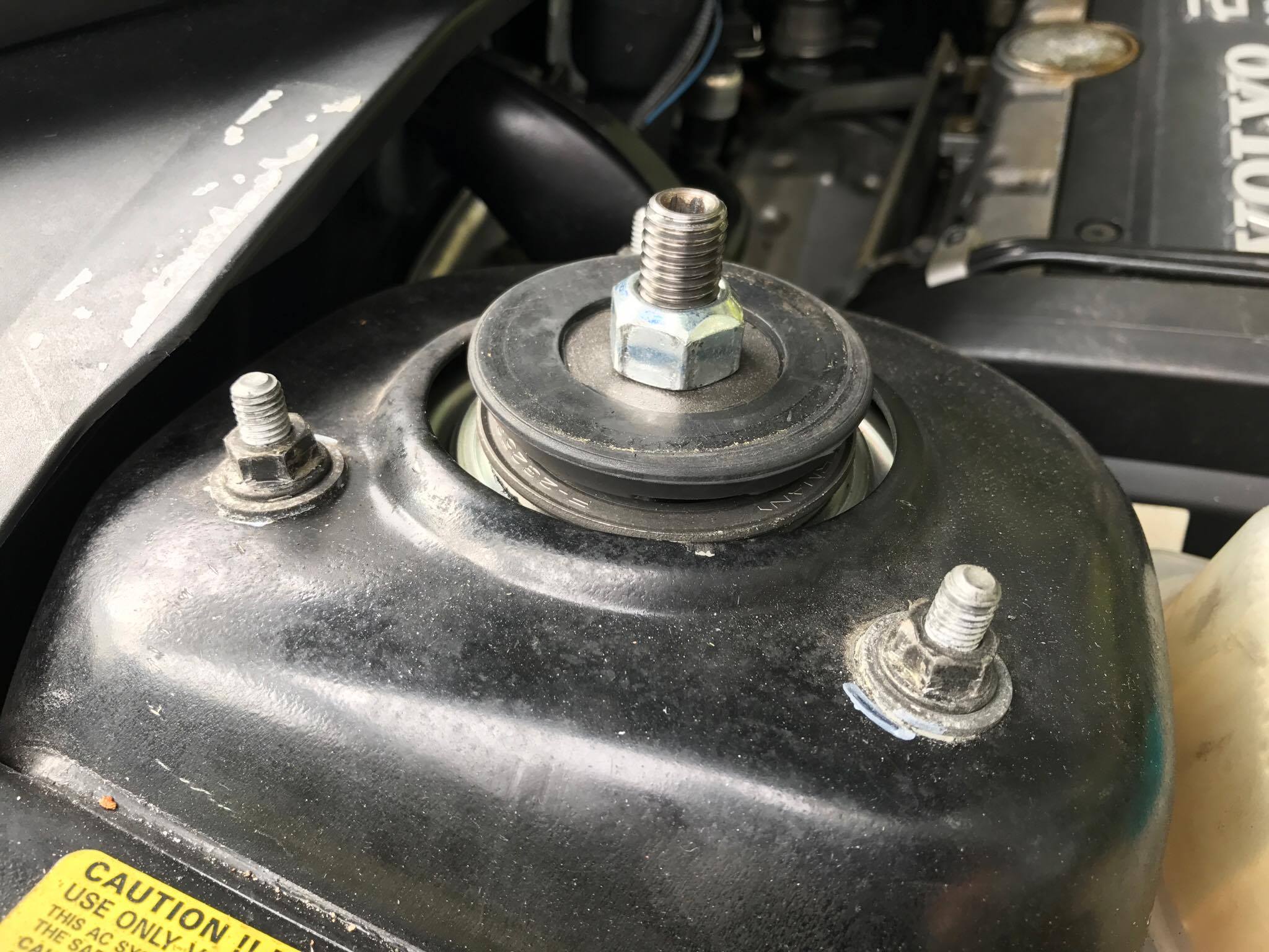

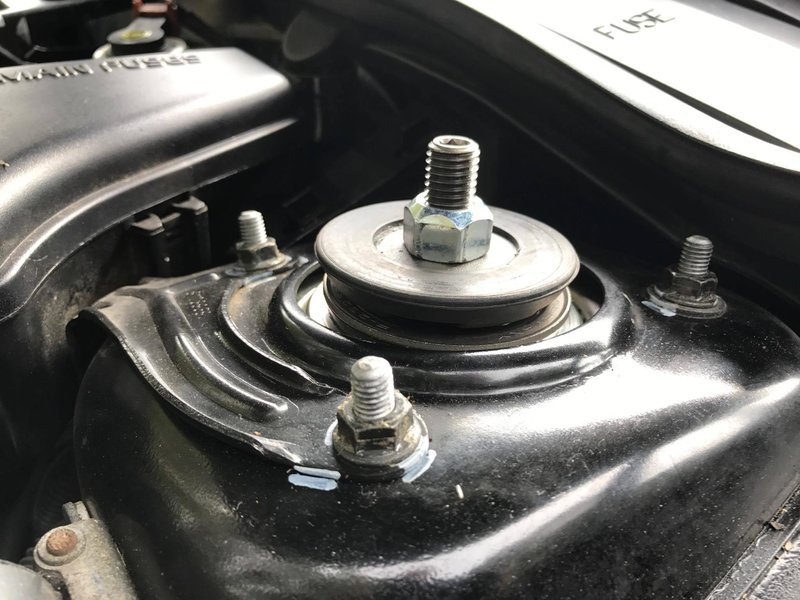

The cross nut is pretty easy to tighten with a pipe wrench or even big channel locks.
BackRoadSeeker
- Posts: 41
- Joined: 22 Aug 2016, 06:57
- Year and Model: 1998 S70 T5
- Location: Richmond, VA
They're close enough in my mind - maybe one thread or less of difference.erikv11 wrote:Is the amount of thread between the top nut and the end of the strut, the same on both sides now? If it is, I wouldn't sweat it.
