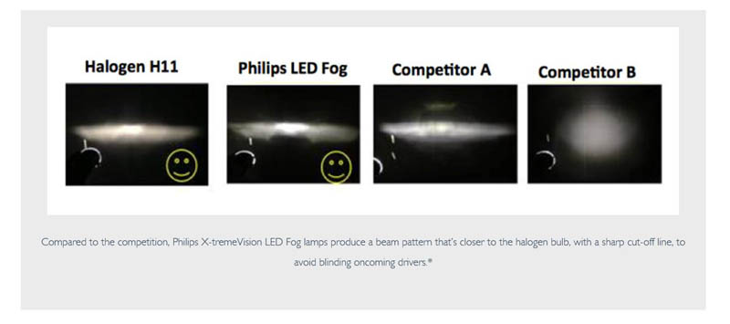

I'm not big on LED headlamp conversions on cars designed for halogens due to safety concerns (improper beam width/light spread blinding oncoming drivers). Only option I see might be the phillips H11 LEDs that bounce the light source through a lens to better replicate halogen light spread to the housing/reflector. But I'm not sure about 6000k (looks unnaturally blue to me at times). They're also not listed for the headlamp position on Volvos. I'm not sure if it's because of somewhat higher lux output or due to bulb monitoring (need a load resistor phillips doesn't sell or make: not a simple drop in).

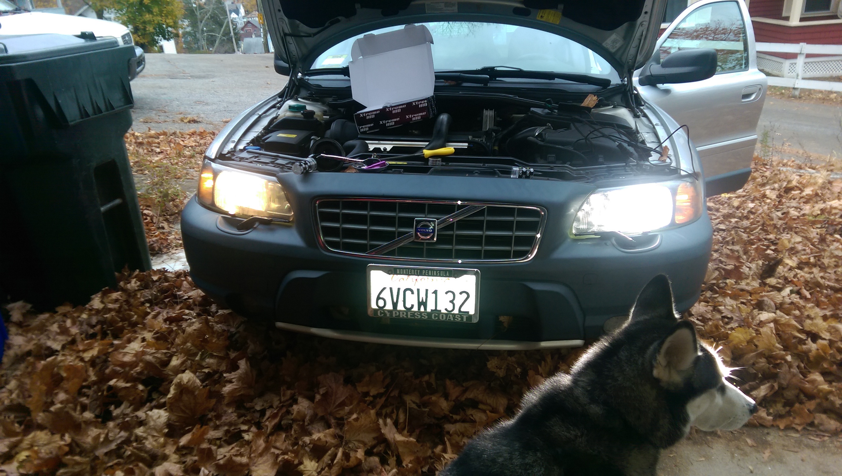

I feel you! I had the same problem and chose to try the HID replacements. I've had them installed for over a year and they've been trouble free, bright, and have a great pattern. I do not take it easy on them - I run them as daytime running lamps too, anytime my engine's running, my lights are on. They've held up great and I'm super happy with them.
They came from this kit: http://www.xenondepot.com/H7-HID-Kit-Xt ... /xt-h7.htm I have the 5000K temp, which looks pleasingly white to me - definitely not tending to blue.
The only downside is that I have a permanent low beam fault light on the dash. I did install the dummy load kit that's supposed to add resistance and kill the light, but it makes a lot of heat and the light's still on.
Overall, its totally worth it. (OEM halogen is on the left, HID on the right.)

Looks like Phillips largely solved the focus/spread issue in housings designed for halogen. But at 2300 lm those bulbs are a no go for forward low beams. That's why those ebay bulbs caught my interest: same physical design with light output more closely matched to a standard tungsten H11. If they're 1200lm at 6000k is probably an exact match to apparent brightness of tungsten H11 1350lm @ 3200k. These cars' housings do incorporate a bulb shield to reduce backscatter and direct filament glare - if the LEDs are arranged in the same 'shape' and position where the halogen filament would sit (they are), the shield still does its job.
