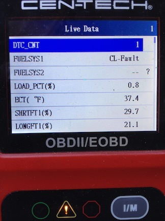

Let it sit overnight with the battery disconnected and then put a jumper between the pos and neg cables to be sure. Plugged into OBD and powered it up with key in position II. I thought my fuel trim would now be zero as there has been no run time. Oh, and the DTC is 1310
Follow up: Found a missing cap on the vacuum tree that was sucking air and fixed it. Took the car for a drive with scanner on live data and witnessed huge negative short term fuel trim numbers in the -20s.
- DTC.jpg (48.6 KiB) Viewed 636 times
