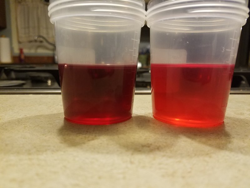

I use this stuff... I documented my last drain and fill here...
https://www.matthewsvolvosite.com/forums ... 08#p414808
Some good discussion there as well as a pic of the fresh valvoline fluid next to the stuff I drained. While the drained fluid looks pretty brown, the fluid on the dip stick was bright red.

Yes, both fluids are new. I have an email into Valvoline about the color and viscosity difference but I have not gotten a straight answer from them yet.
I did however do some research on the color and viscosity of trans fluid last night. The info I got back about the color is that it is red dye is that it is added to the oil to make it more distinct and set it apart from other oils. I also found that the viscosity index of the Shell fluid is 177 and the Valvoline is 174 and that the Valvoline has a greater change in viscosity with changes in temp than the Shell oil. This may account for the appearance of a thicker oil out of the jug but I am not a chemist and really have no real way of knowing. Anyway, my guess is that Valvoline uses less dye and their viscosity is less but within the set requirements for Dexron-III. Again, I am not an expert but I am hoping that it what is happening here.
