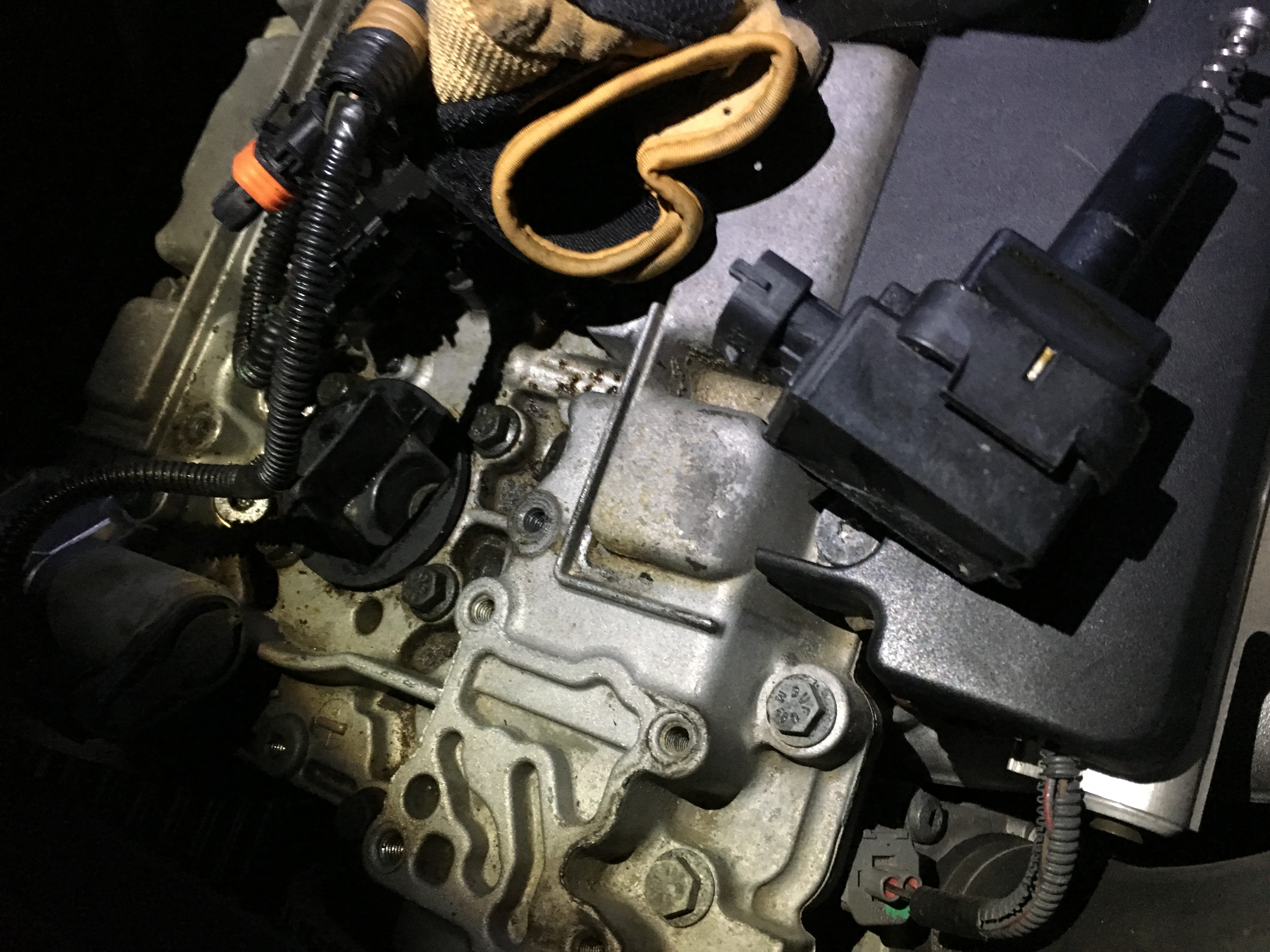

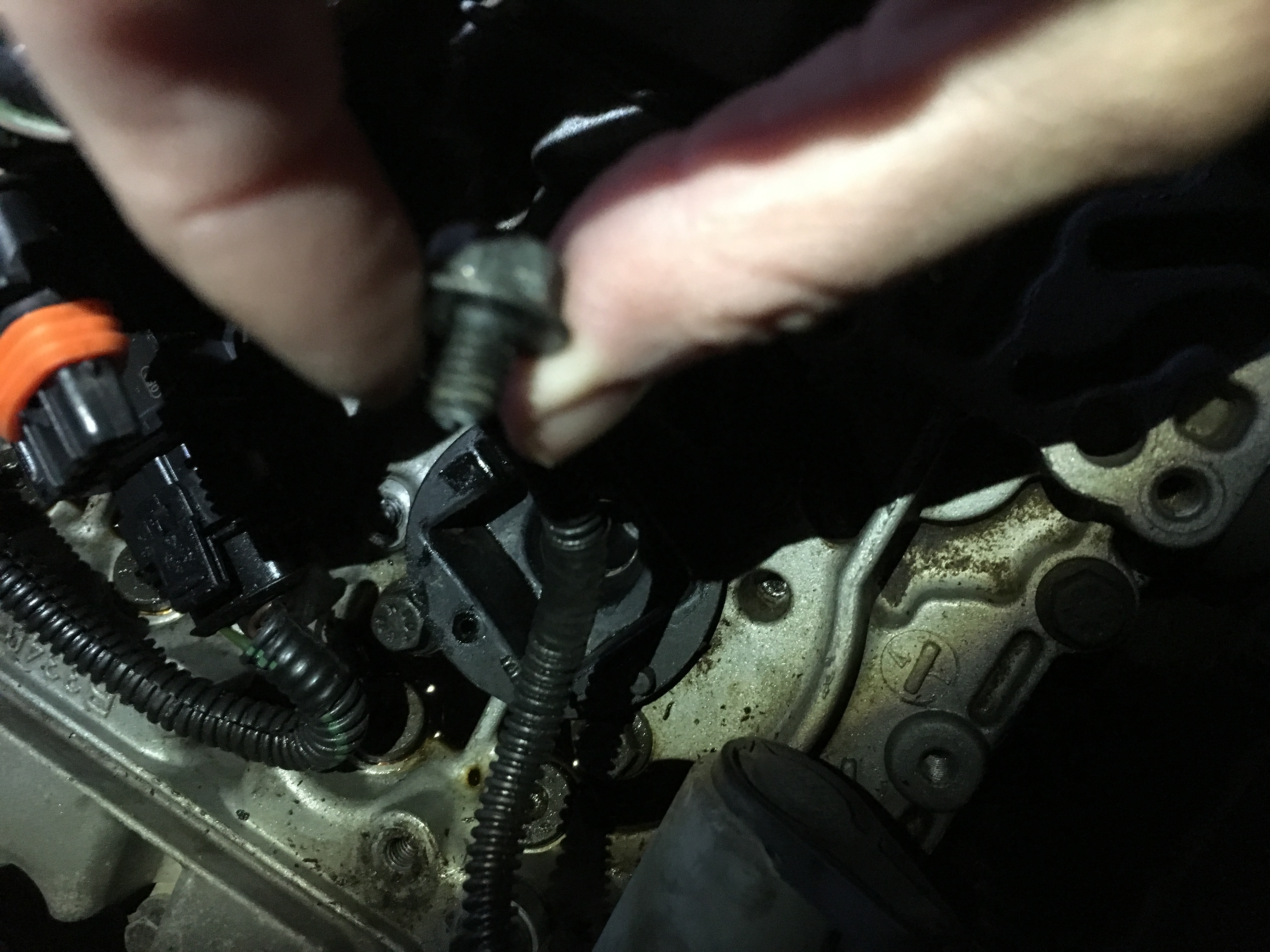

Oh my god. Oh my god. I was unscrewing the ignition coil and the screw broke. Then the ignition coil came out - but the rubber part stayed in! So there's just this spring thing on the end.

Just pull the rubber thing out. Grab it with some pliers. It's actually part of the coil but can be separated for cleaning and service. In fact AC Delco make replacement boots. The spring goes on the end of the coil; no big deal.
Look for hairline cracks in the body of the coil packs. If I see a crack in a coil pack I can be sure it will be the next one to fail. The spark can arc out of those cracks and cause misfires.
Oh and get yourself a code reader. All this feeling around in the dark is reminiscent of catching a blackbird on a moonless night.
