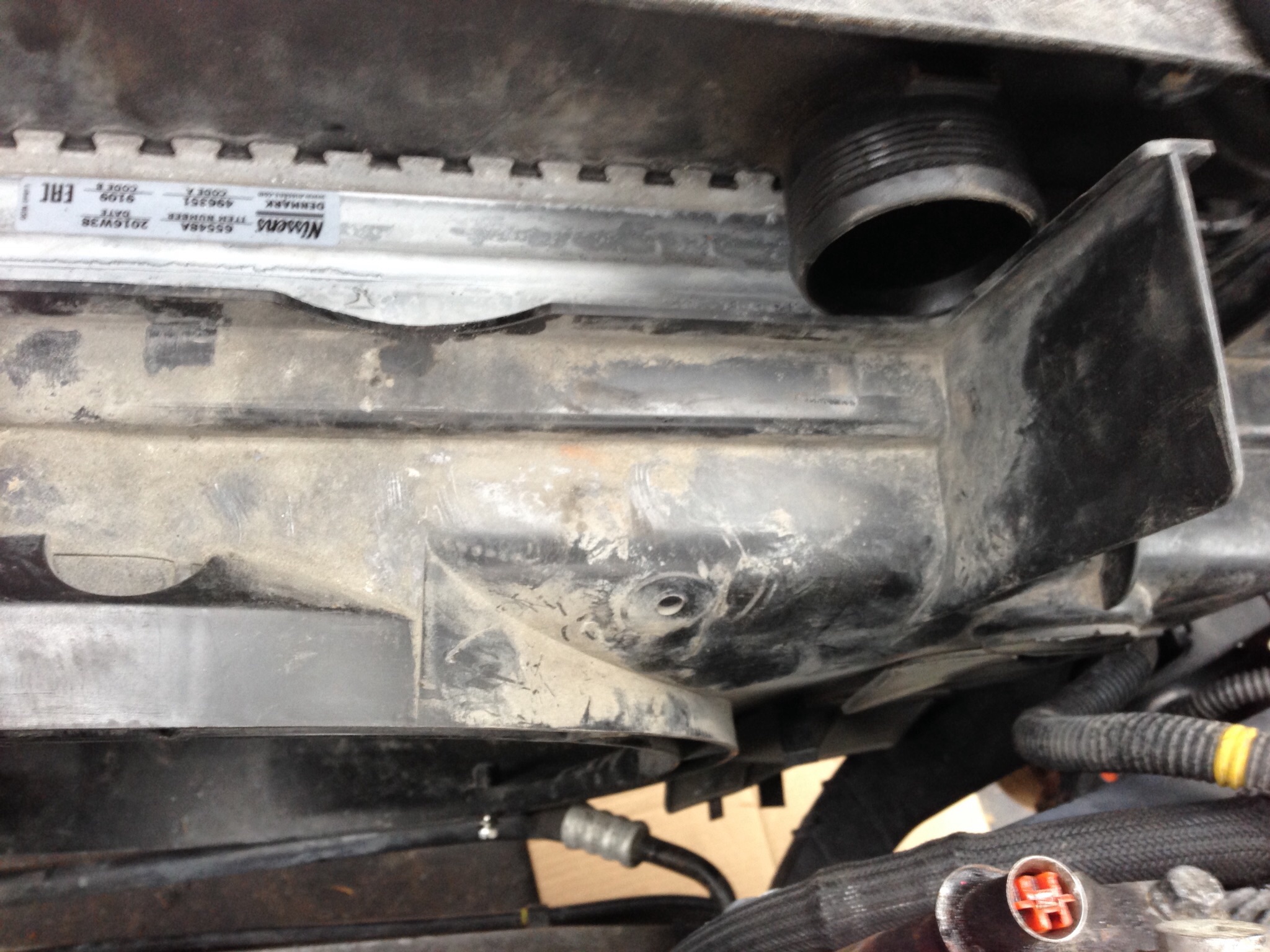

- Posts: 36145
I went to finish up the hoses and reconnects and got stopped here.
If yours looks like this, congratulate yourself, then redo the job putting the intercooler in right side up next time.
