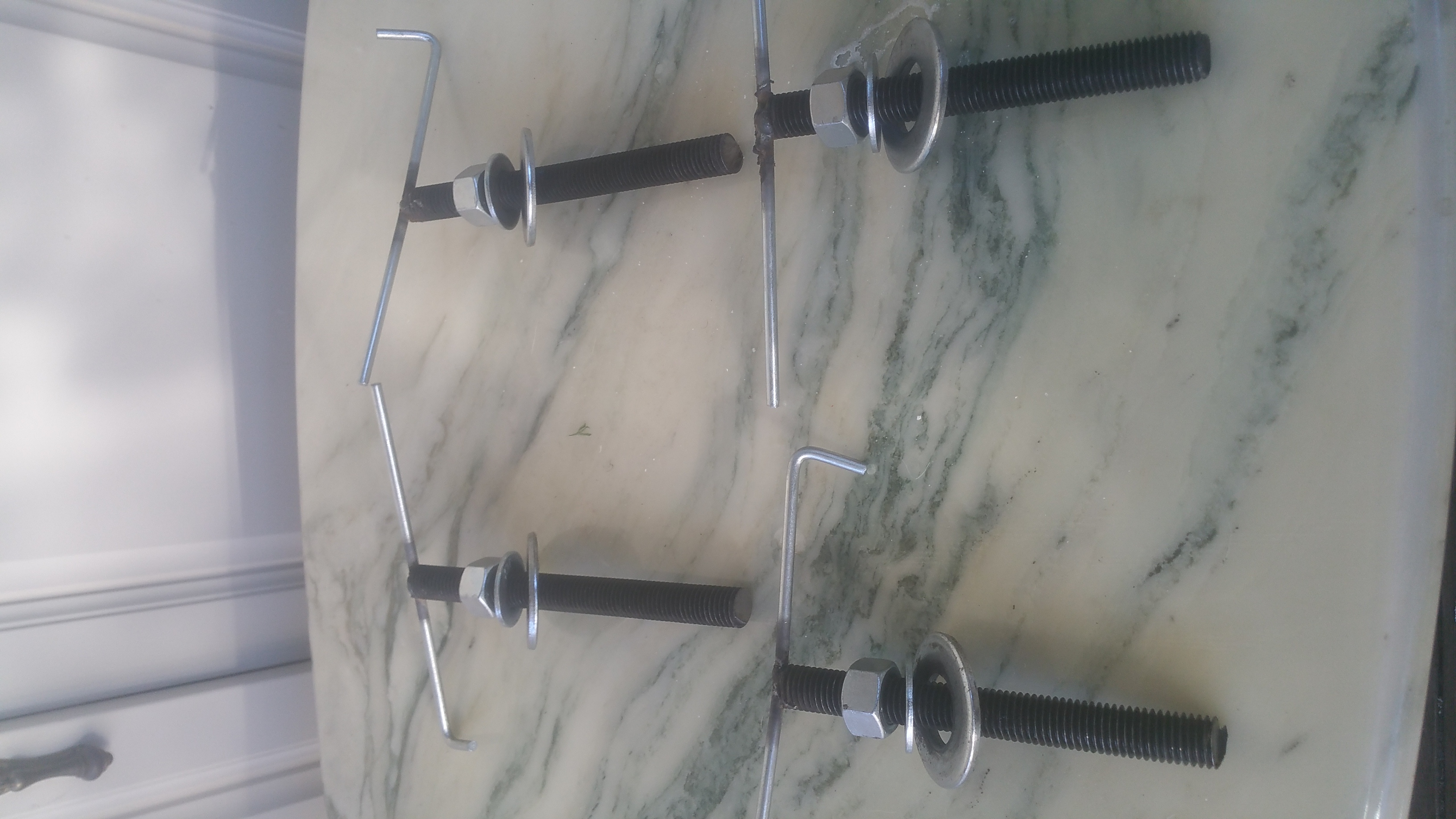

I recently fabricated some subframe droppers from high tensile M14 threaded rod as pictured so I could drop the subframe enough to replace the brake booster. Not that much to undo apart from the cross braces keeping the exhaust up high and one earth strap from the battery. You could do the same and avoid having to use an engine support beam. This would give you access to all the front mounted bolts on the valve body cover.
