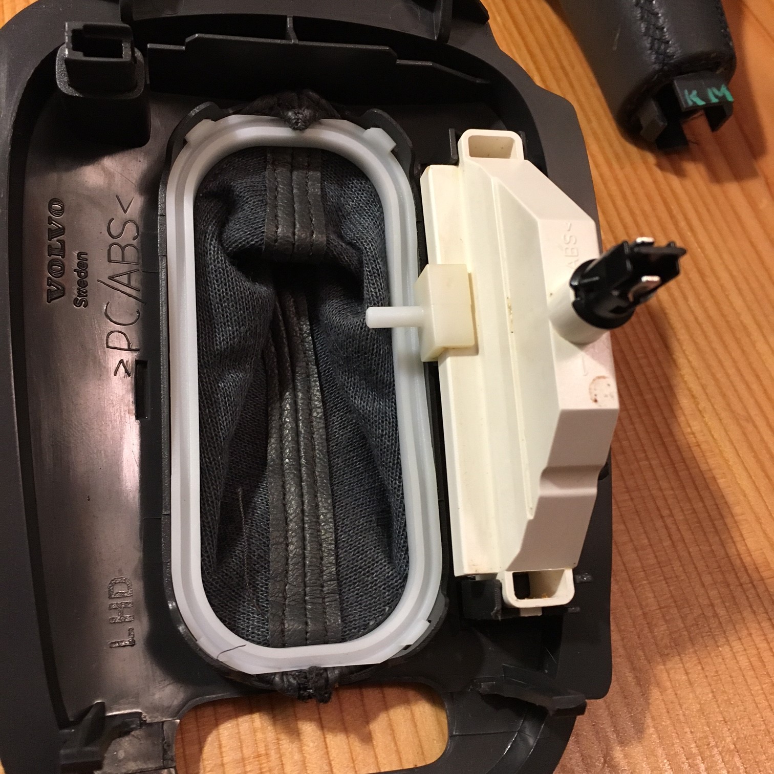

Some of you more experienced forum users have probably had this part of the car taken apart for one reason or another, so I post these pics of the various components in hopes that others who might be thinking of tackling this job might be reassured that it isn't too complex.
The shifter faceplate assembly is made up of the following parts:
* The plastic trim panel that clips to the linkage tower under the center console
* The leatherette "boot" that goes around the actual metal shifter rod (this part is removable)
* The white light box / gear selector slider (this is also removable but easy to break the plastic retaining tabs)
* A thin, flexible grey plastic insert with the gear designations on it
* A thicker clear plastic insert that separates the selector slider from the top piece with gear designations
Also included in this assembly is a foam ring that gives the boot some shape, and a black plastic square that clips to the bottom of the shifter knob from within the boot that holds it in place and prevents the boot from "bunching" up.

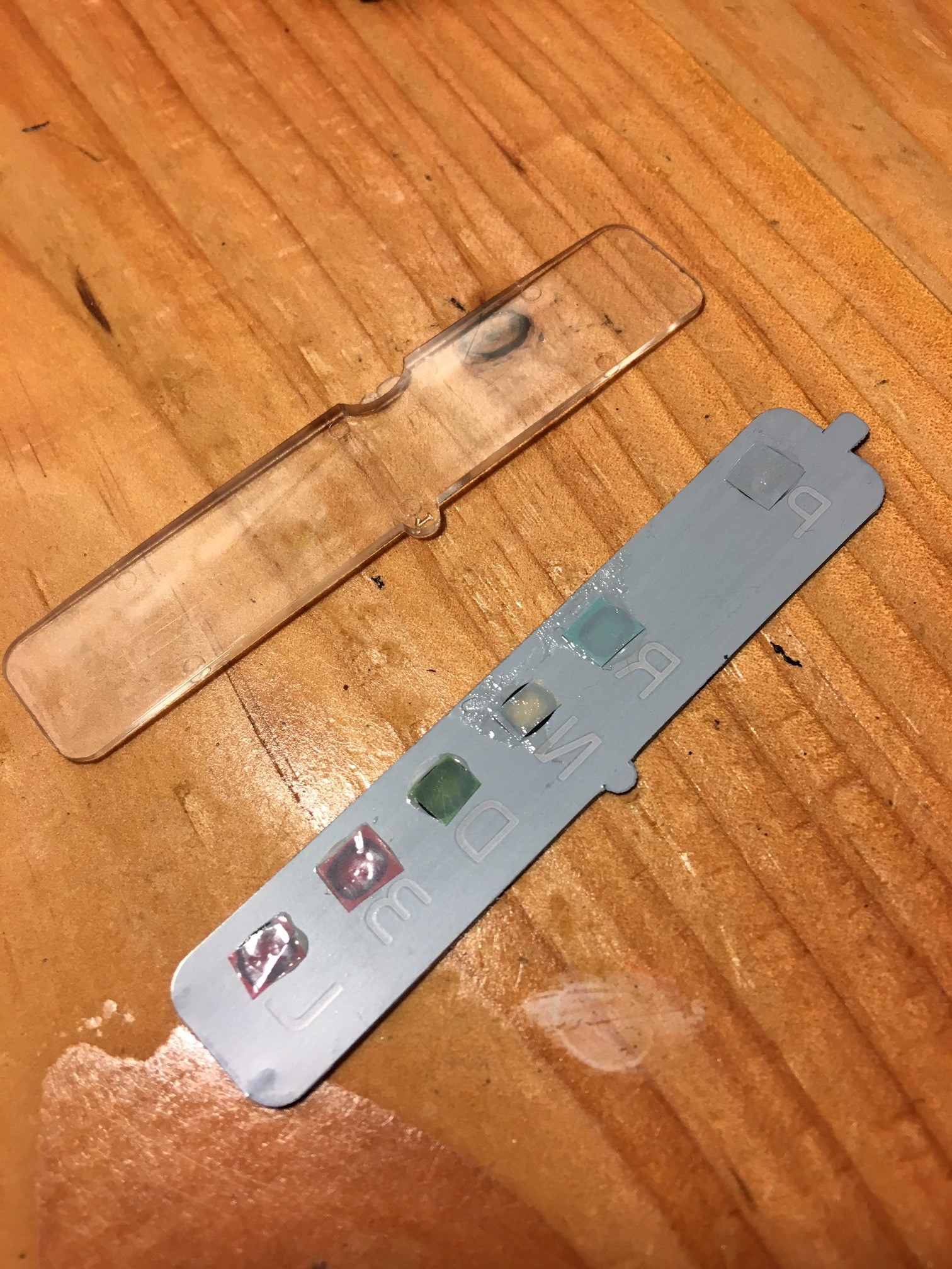

Since my shifter faceplate was so beat up, I bought a much newer and cleaner looking one and set to disassembling it. While I was happy to learn that the lightbulbs that illuminate this unit are readily available, I began to think that just plain while dots with a red selector dot behind them was a bit to boring.
Years ago, I had a 1984 XJ Jeep Cherokee and the numbers on the 4WD (2WD, N, 4H & 4L) shifter were kind of bland and wearing off. The 4WD selector faceplate was easy to remove and backlit from within the console. One night, I decided to see what I could do to enhance the appearance of the faceplate and I came up with the idea of shading the numbers. I soon realized that permanent markers applied from the inside weren't going to hold up, so I came up with the idea of epoxy gluing small translucent pieces of plastic to the inside of the faceplate. What did I use for the plastic inserts? Mainly clippings from food wrappers such as peanut bags, beef jerky bags and chip / snack wraps. By cutting the little squares and smearing them with epoxy, I was able to create a film on the inside that not only lit up different colors at night when the lights were on, but were easier to see during the day.
So, I applied this technique to the Volvo shifter. I think the blue "Park" clipping was from a little peanut wrapper, the red and green were from a beef jerky bag and the yellow was from a bread wrapper. The key is to use something with a little bit of thickness. Obviously, paper or very thin plastic wouldn't do for this application. The interesting thing about the way Volvo made this selector insert was that after gluing the little colored pieces on, I buttered on a layer of epoxy to the back of the selector piece and then sandwhiched it to the top of the thicker clear piece. So, the thicker clear piece protects the little colored plastic tabs from being peeled off by the sliding gear selector indicator below.
My theory for the color coding went like this: Green is for GO, so that had to be Drive. Red is for stopping or caution, so that had to be for 3 and Low. Yellow for Neutral, and light blue for Reverse, and a dark blue for Park. My girlfriend's Toyota Matrix has a similar multi-colored selector scheme but not exactly like the pattern I choose. I suppose if someone wanted a uniform approach, they could make all the letters one color. On R cars maybe all letters in the dark blue would look good since the gauges are blue, but who knows maybe R's already have a different selector faceplate.
