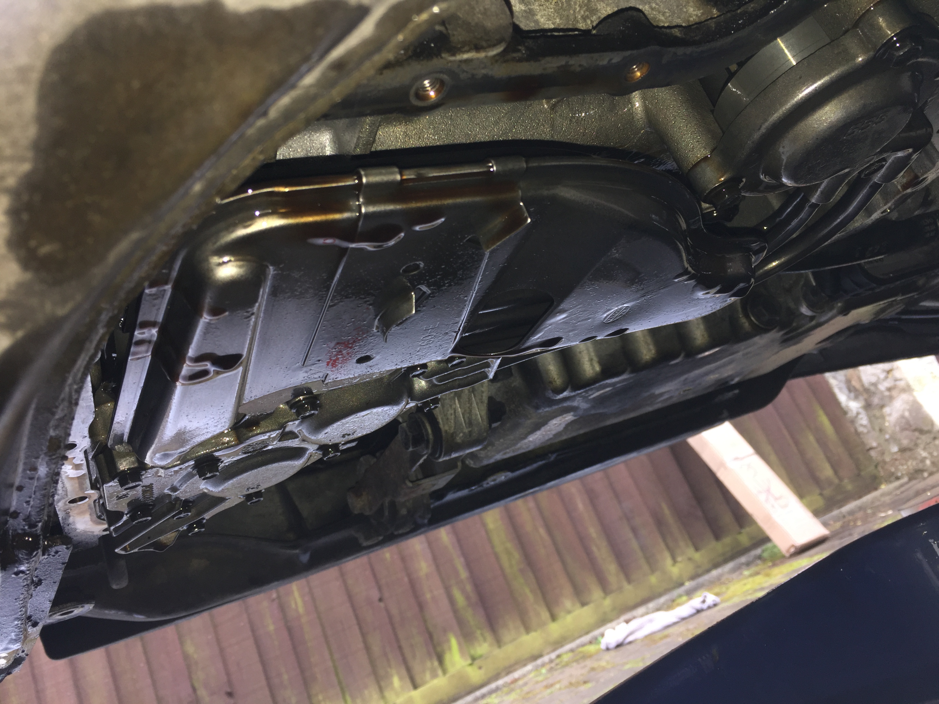

I proceeded to remove protection tray from beneath the gradually removes all the 10mm bolts holding the sump on being careful not to damage the gasket of course i needed few containers to catch the old oil which was dark brown and should be red.
I then cleaned the sump cove that had grey sludge cleaned the inner parts i could see using tissue.

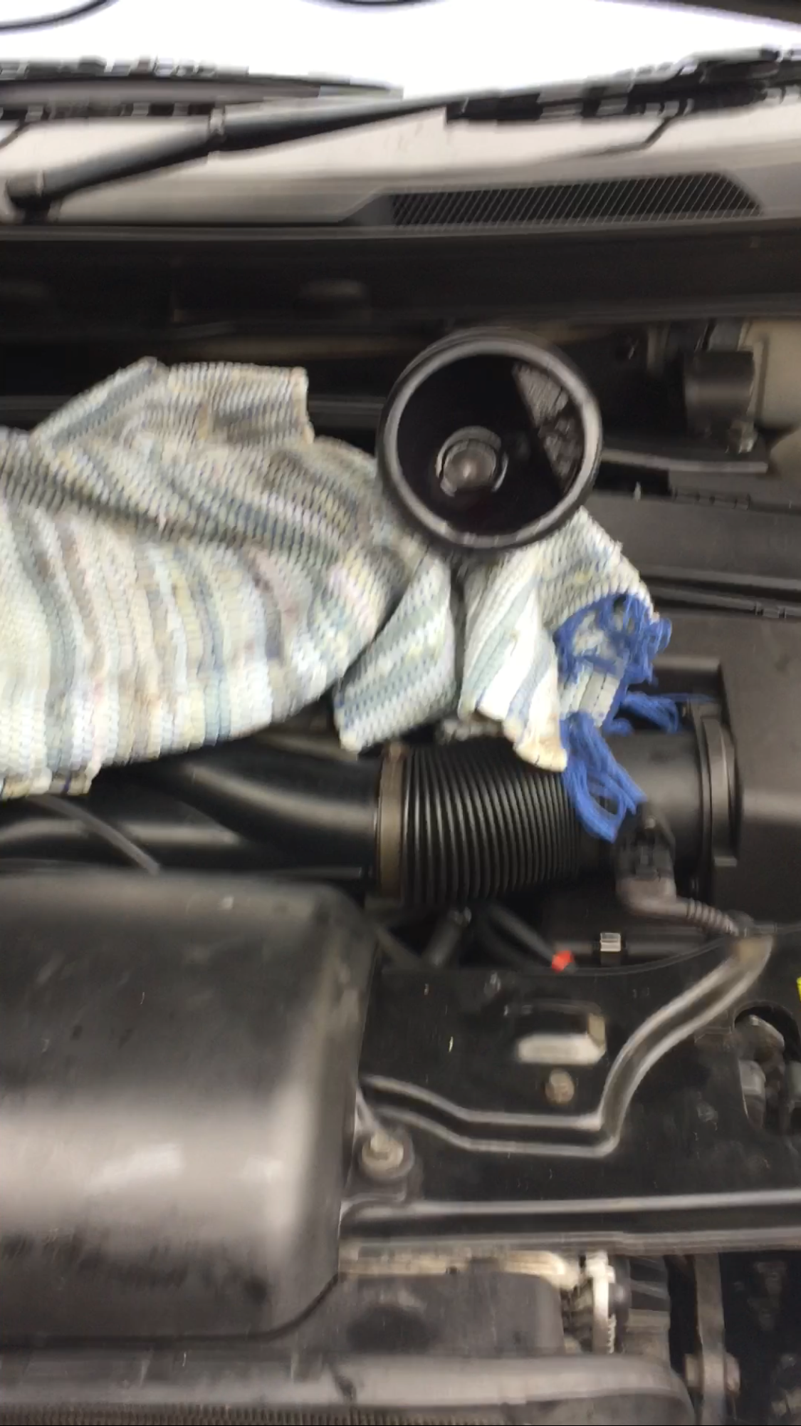

I then put it all back together and refilled using a funnel from the top easy to get too dip stick hole.
