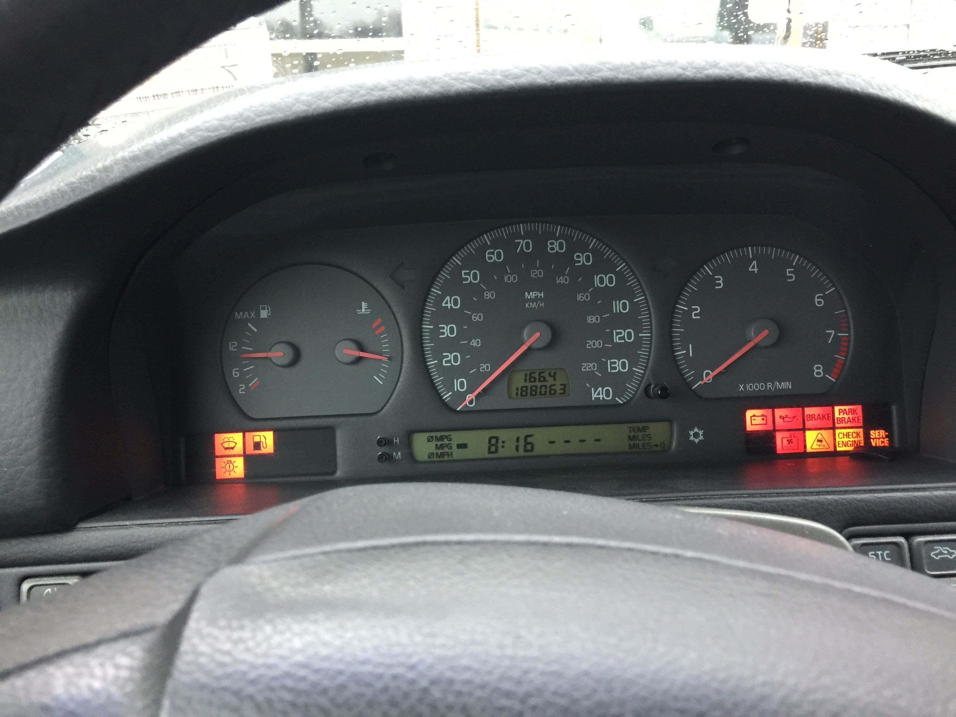

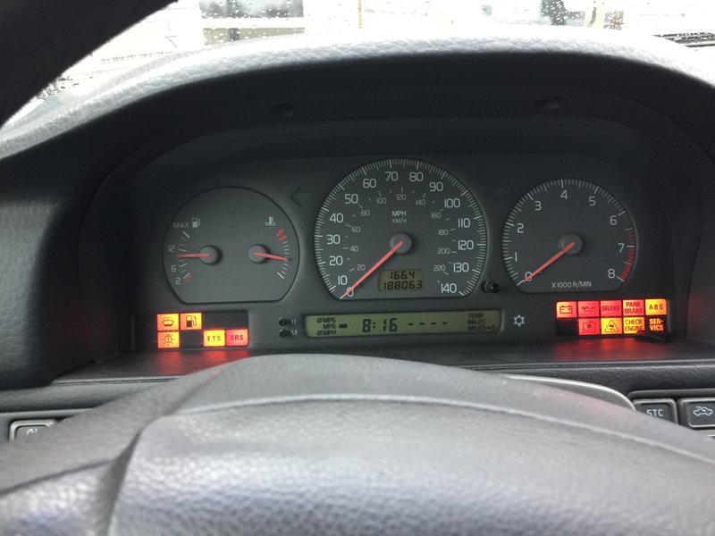

Pictures to document the correct protocol for key POS II
All lights in the lower two rows come on on key to POSII
After 3+-1 second, the ABS SRS and ETS lights go out.
Note the cruise bulb does not illuminate - I don't think there is any way to diagnose a bad cruise bulb from cruise INOP, unfortunately.
1999 V70 T5M dashboard light protocol documentation
