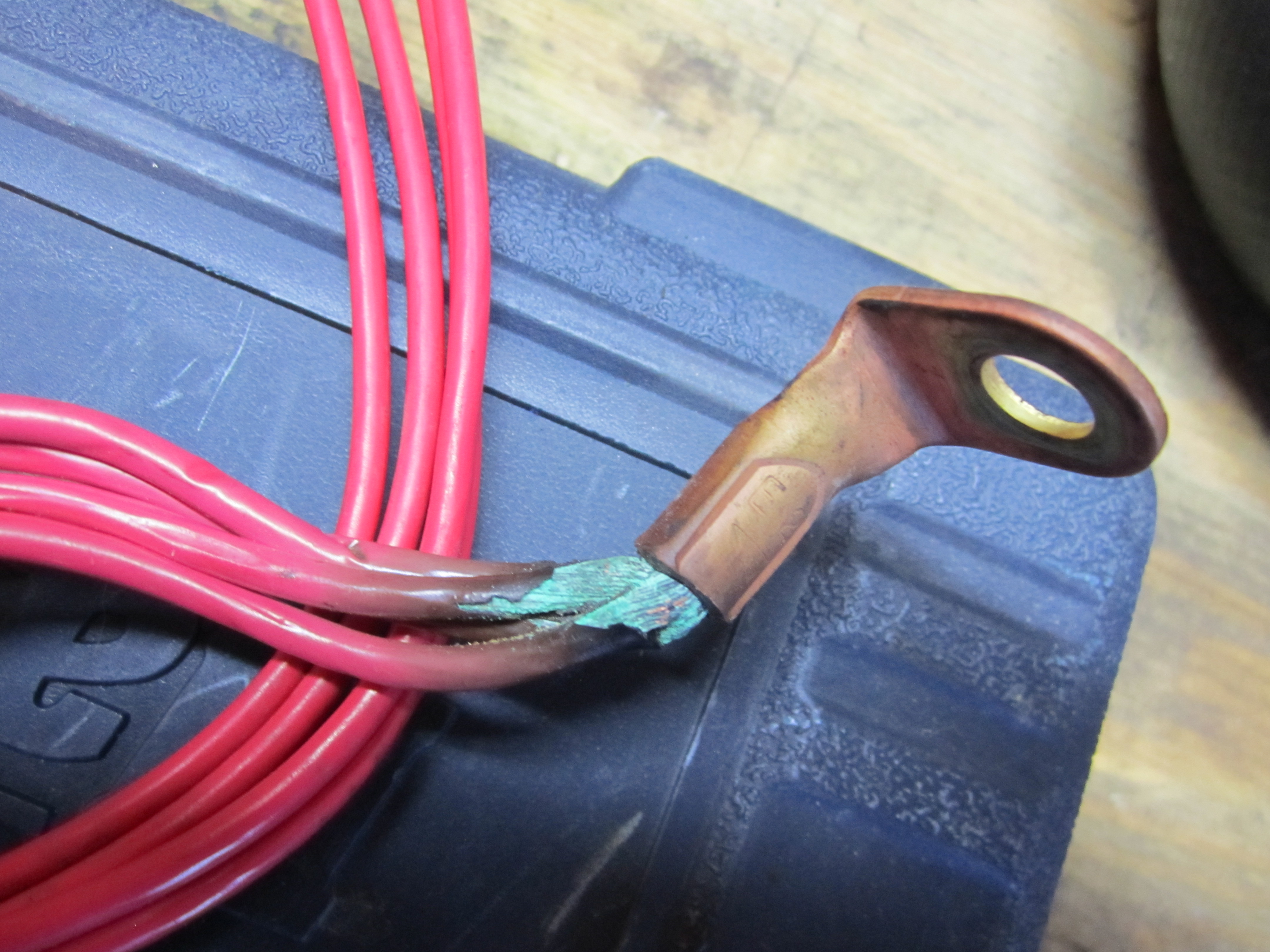

There is another possibility worth checking on. I have seen a couple of times where there has been shorts happening under the fuse box where the fuel pump relay is fitted in front of the drivers side windshield wiper (not the kidney shaped main fuse box in the engine bay). The wires in those cases had crumbled and the insulation had fallen off and caused various shorts to occur. It may explain how the car ran without the fuel pump relay in place. Also, a less likely issue is to check there is no issue with the B+ cable in the main fuse box. Check the nut and the cable end are nice and shiny, but also look carefully under where the cable bolts down as mine had melted all the insulation in there!
