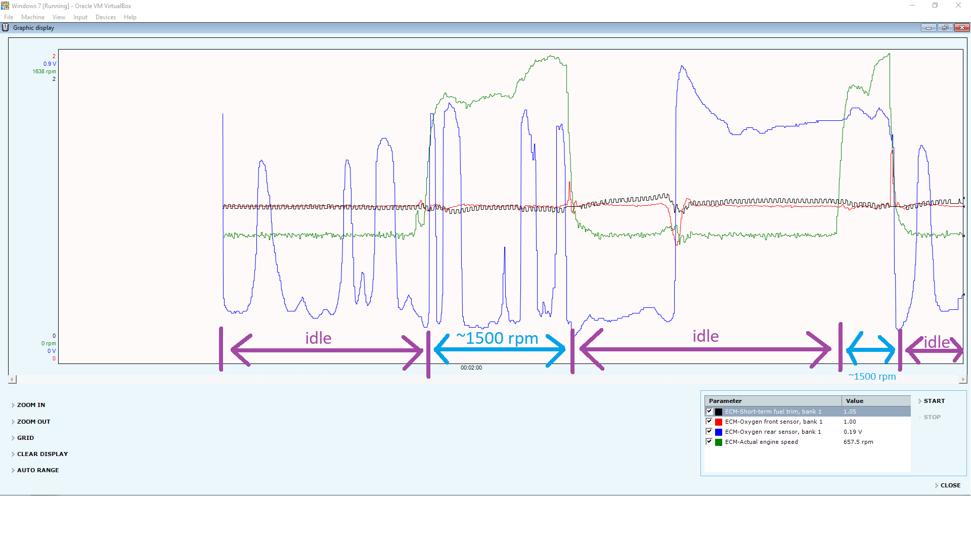

I was also fooling around in vida and I found that the rear oxygen sensor is going all over the place. Here is a graph I got from almost warmed up car:
Is this normal? Vida says that the voltage should be around 0.6V. I plan on checking the cat when the car cools down.

For the rear one, try unscrewing it, put a fresh dab of conductive anti seize on the threads and torque it back. I've seen a rear O2s work itself loose before on a VW with wild fluctuations like that. If that doesn't settle it down then the sensor itself is probably bad. The rear on only monitor the cat and isn't used for fuel metering. Surging is consistant with the front O2s failing, which is used for fuel metering. If you found nothing on the smoke test @120,000 the O2s is a pretty safe bet.
