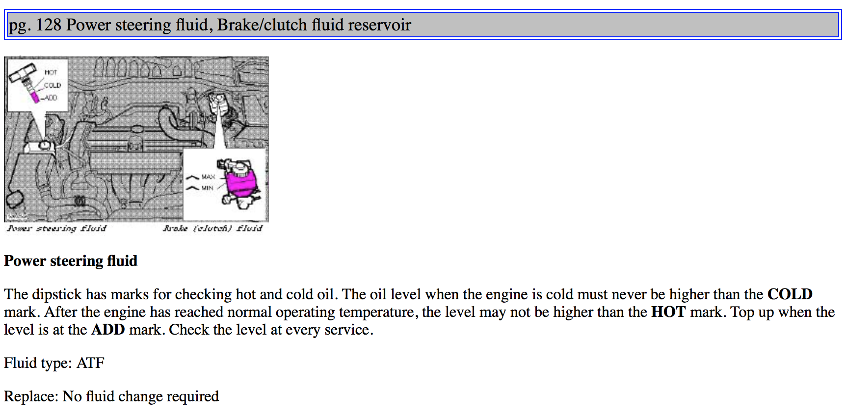

Owners manuals online free here
http://www.volvocars.com/us/own/owner-i ... rs-manuals
From page 128
From page 128

abscate's source is correct of course. However the manual is pretty vague in ATF type, and the idea of never changing it is right up there with the wisdom of a "lifetime" transmission fluid.

I have just sucked out all the power steering fluid from my 2000 V70 base. The hand book is incorrect for the 2000 year in both fluid type and capacity. It lists the capacity as 0.9 litres, but my turkey baster removed 700ml from the header tank alone. Can't believe the rest of the system only has 200ml!!! I think the capacity is based on the older tank on pump design.
Fluid type is not a standard ATF, Volvo uses Pentosin which can't be mixed with ATF.
