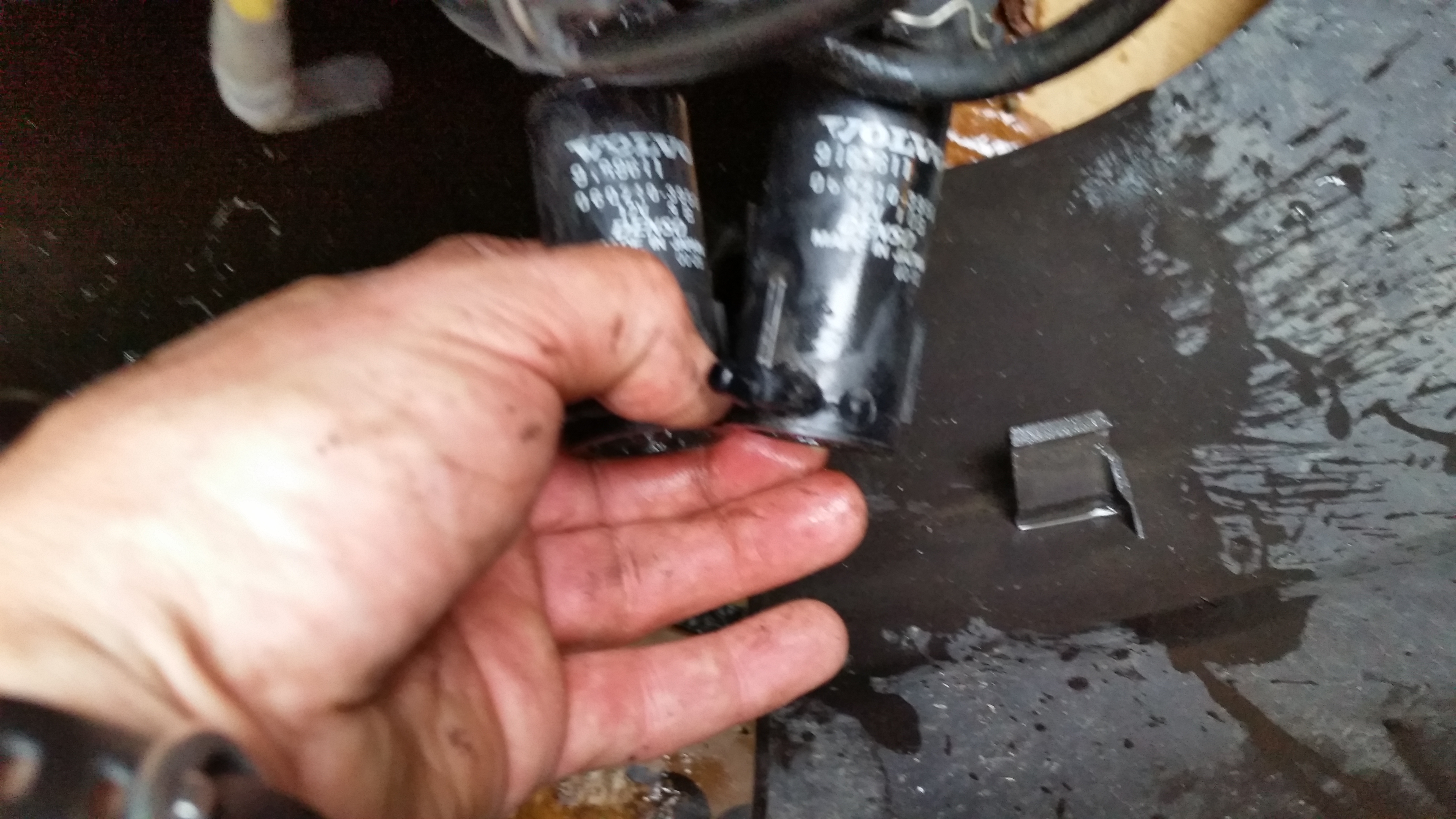

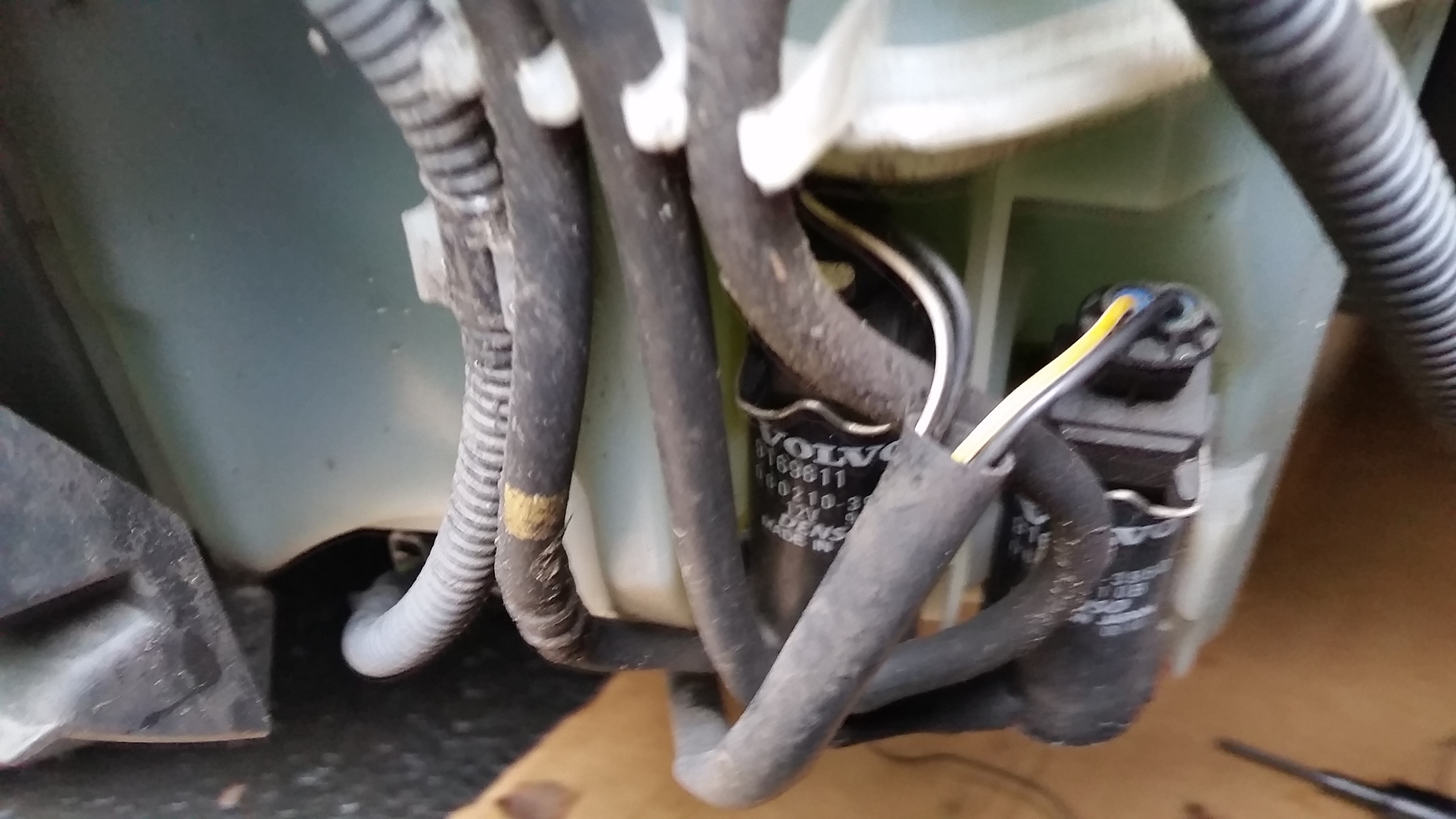

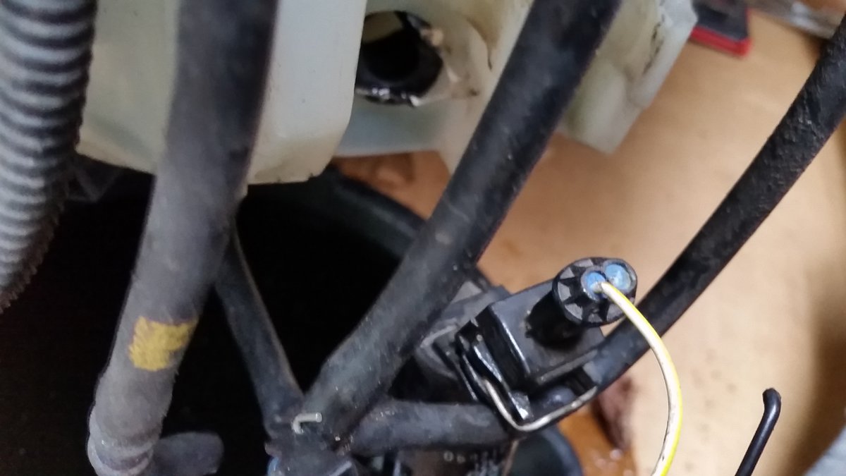

Hey Sommerfeldt and scot850, my issue was almost exact opposite scot's: there are indeed two pumps, nestled in cavities formed in reservoir, and my front pump failed...I suspect due to more use than rear pump. I started to physically swap both, and abandon rear washer (car has 185k miles on it, and who uses rear washer anyway?) when I realized it would be ghetto easier to just switch the wet tubing and use the rear washer switch to activate the front washers. That was when the front pump black wire broke, confirming my decision...how does that wire go into what looks like a solid plug??? Hopped in car, verified that rear washer switch produced fluid from front washer nozzles (albeit with rear-wiper activation, no biggie), and buttoned up all the front bumper/undercarriage gear.
Got in car satisfied all was well, and now nothing. No noise, no spray. Fuse is good. Searching the google for washer wiring harness.
One thing about Volvo: all the random gremlins HAVE TO be good at keeping senility at bay!

The wire is crimped onto a connector that goes into the black plug, which is later filled with hard epoxy like glue to make it water tight. If it was me, I'd try with a very small drill bit to carefully get about 1 cm of the blue stuff out from around where the wire broke and hope the copper wire in the plug can take a bit of solder... If that's the case, it should be easy to mend the two. For kicks, try disconnect the wire harness from the pumps and put a 12v supply directly on them to see if the fault is in the wiring or the pumps. Seems weird to me they would both just go out like so. Could be a small blockage in the hoses or maybe the filter at the bottom of the resevoir is jam-packed with debris that would cause the pumps to work much harder to pump the fluid through to the nozzles.

Nice job getting some pics of that stuff - I've never seen a pic of that mess down there. I'm no help in finding a new harness, but best of luck to you. And those pictures are sure to help someone out some time!
