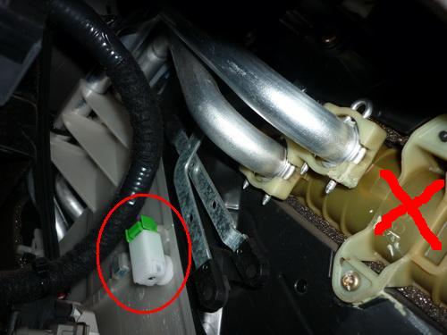

Is it possible to check evaporator for leaks without taking the whole dashboard out? I see UV dye on receiver drier, but want to double check that the evaporator is good.

I think you can see the side of it from the drivers side, if there is a leak, it might show at the bottom of the plastic case

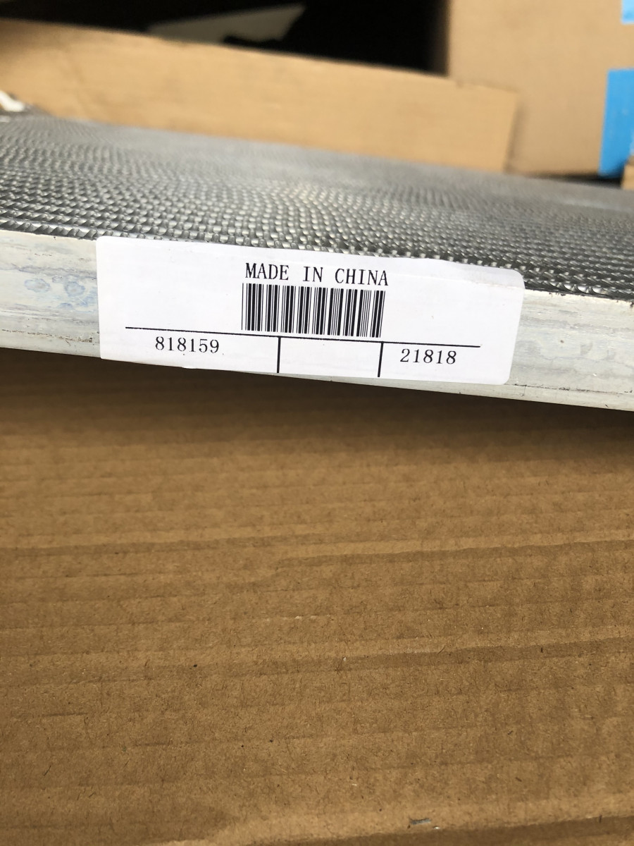

Here's an update to my update on this thread... the OE for my '02 V70 XC is Valeo, so I spent a little extra (okay double) on another Valeo over the Behr, but I was after quality so I didn't mind. Both brands are sold as the dealer recommended part number 30676602 (ref. FCPEuro.com). Note the Valeo part number is 818159 as shown in the picture.

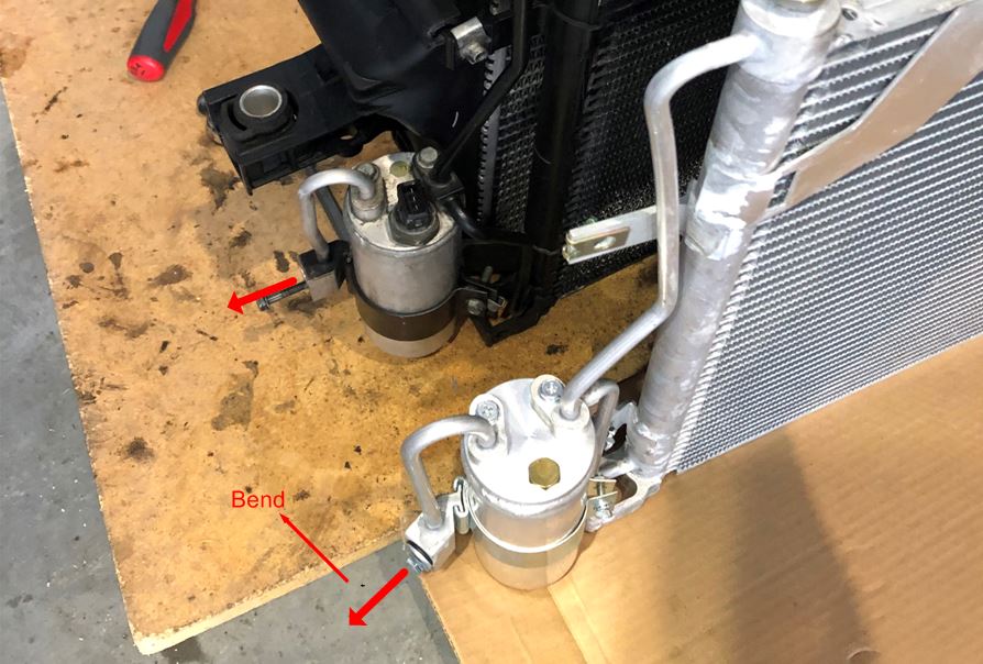

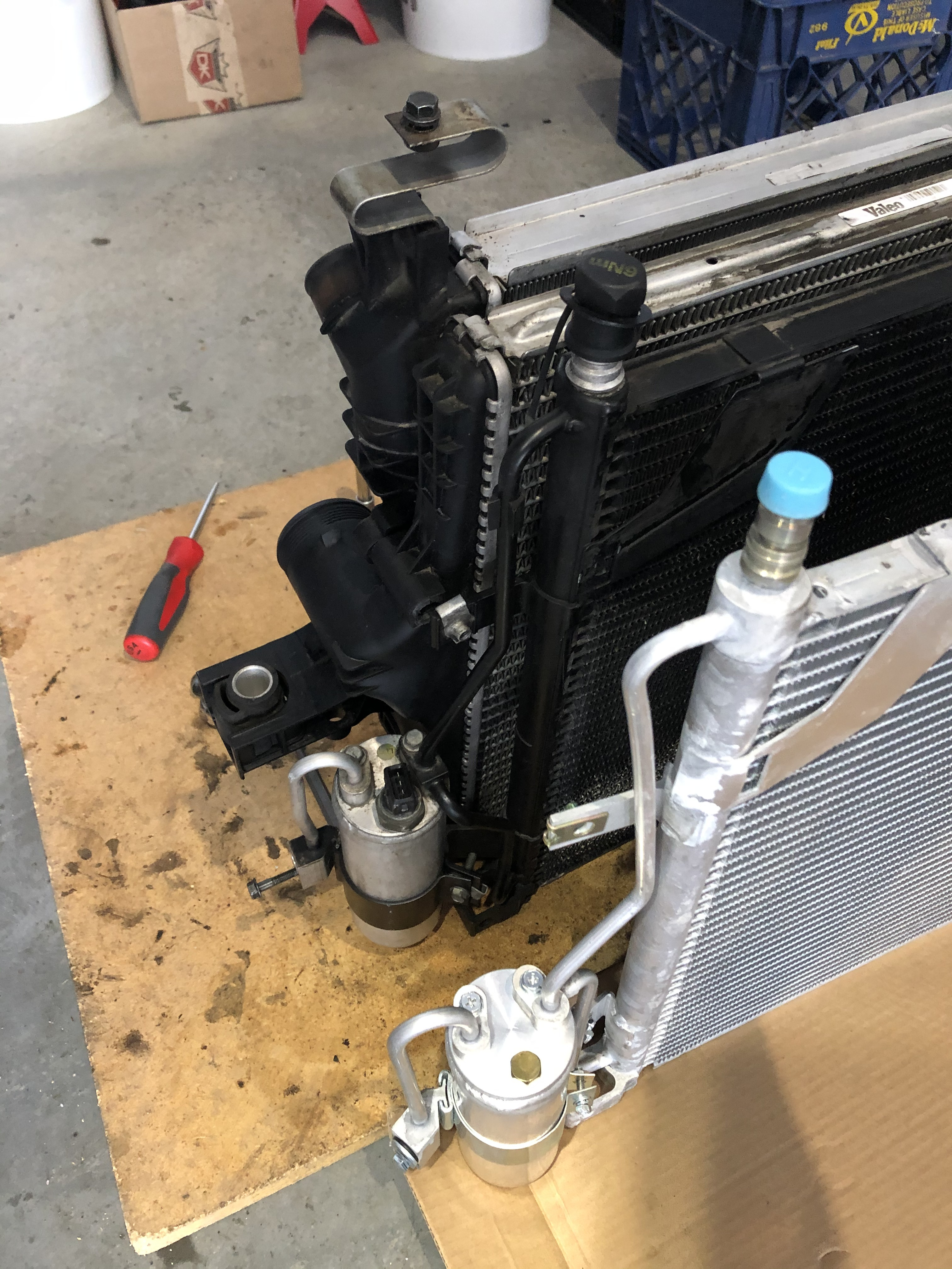

At first I was baffled by the angle of the dryer (see picture) but I think it may have gotten bent during shipping. The packaging was absolutely minimal. I removed the dryer and bent the welded bracket towards the rear to match the angle of the original part. Note also that ALL the spring nuts were installed backwards. Not a big deal but, in my mind, it speaks to the diminishing quality of Valeo.
