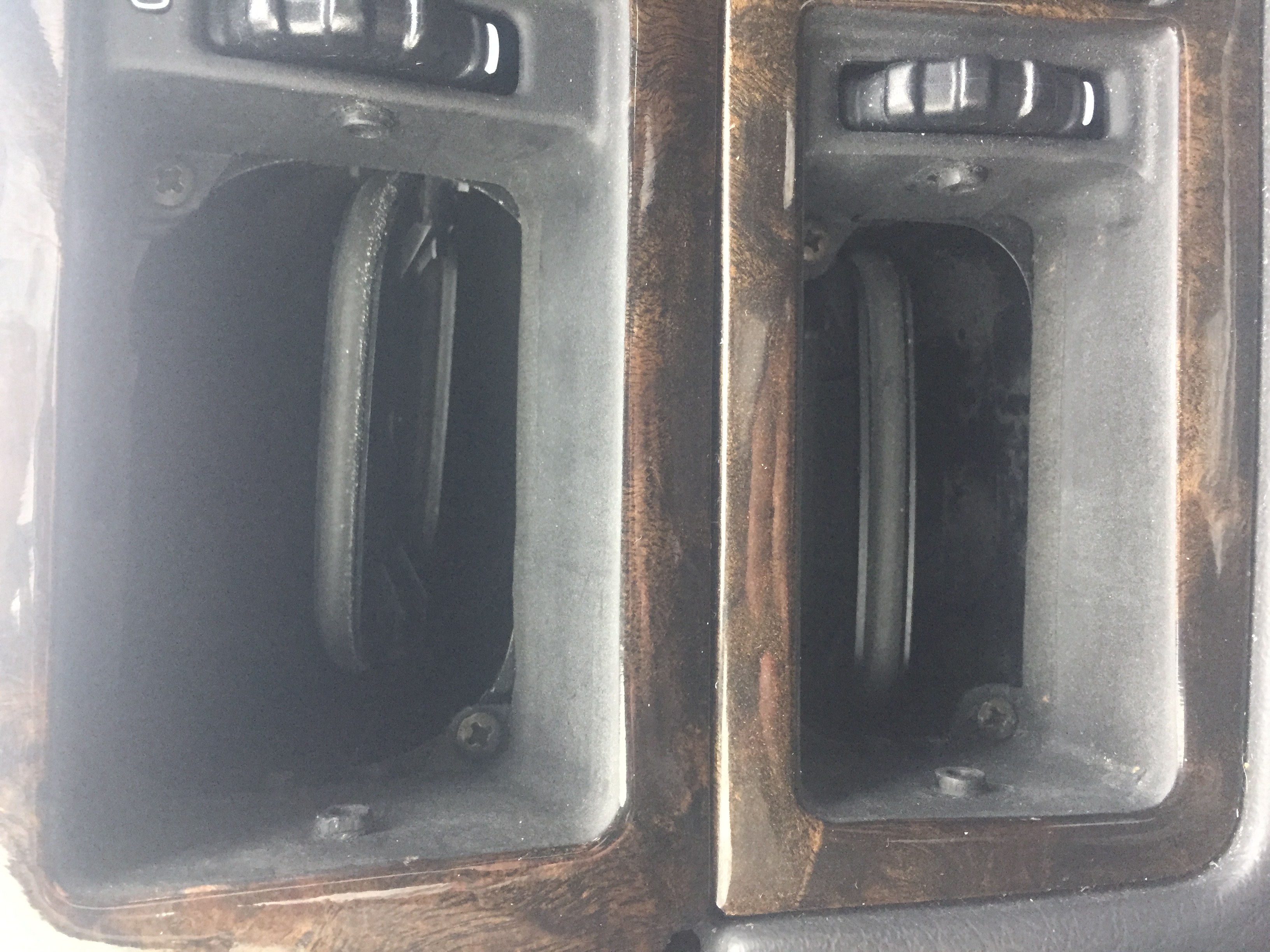

I can't recall the vents on an 850. Can you pot a picture of the offending item and we might be able to advise from there?
Hi,
So found the culprit and not sure the vest way to take care of it. When you take the vent out where the flapper connects to the turning wheel, if you put your finger there, the squeeking stops. I don't want to spray anything since I don't want to breathe it in being where the ac blowes out of. Any suggestions? Or would some spray be the best option or somehow figuring out how to remove.
