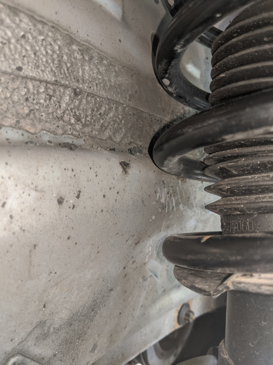

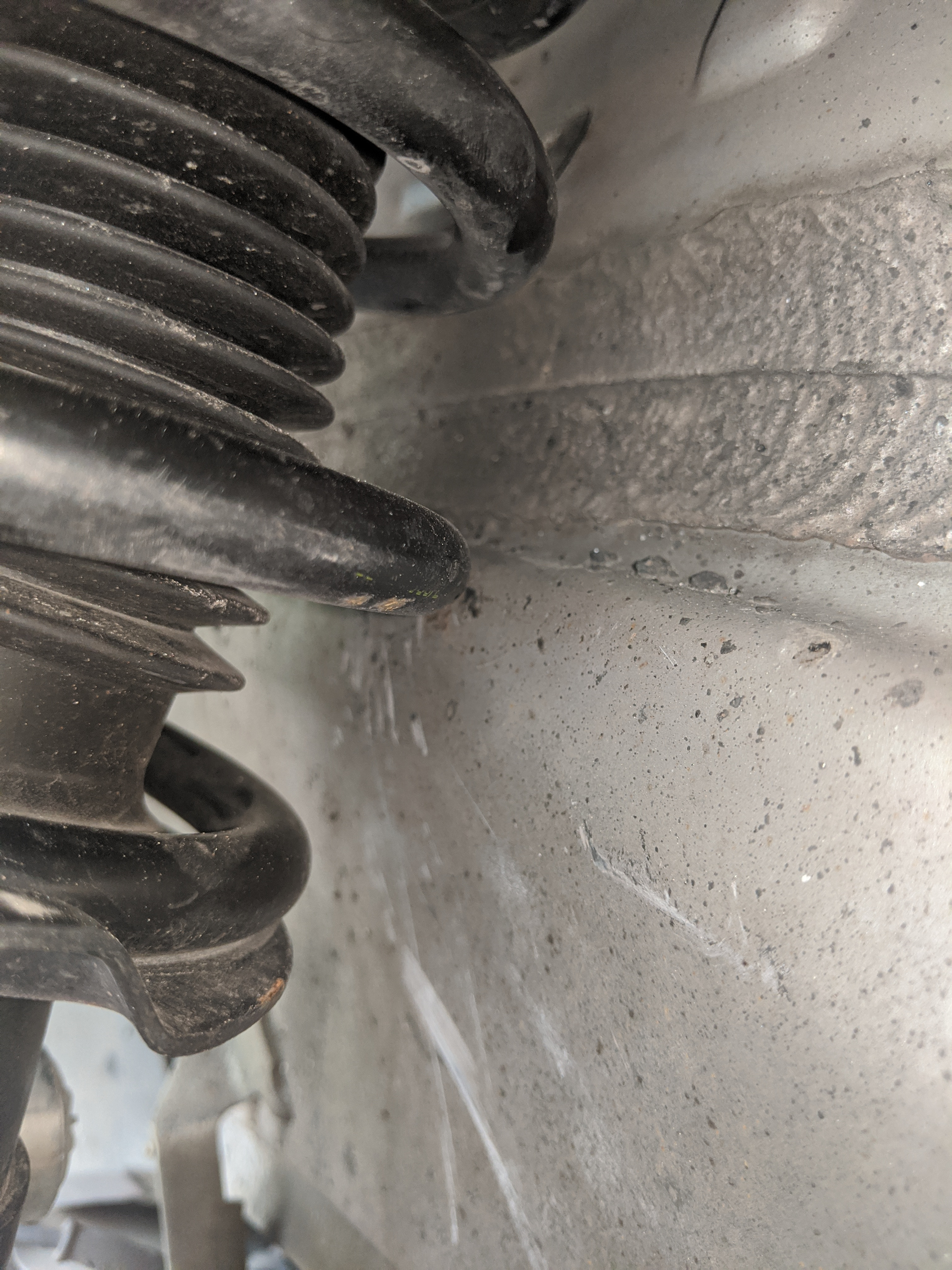

Can you take a pic of the rubbing? Is the wheel liner in place on all of the mount studs?

Weirdly enough I just checked with the wheels on the ground and it's not rubbing straight on. I'll take some photos later, of the springs and the subframe bushings as well.

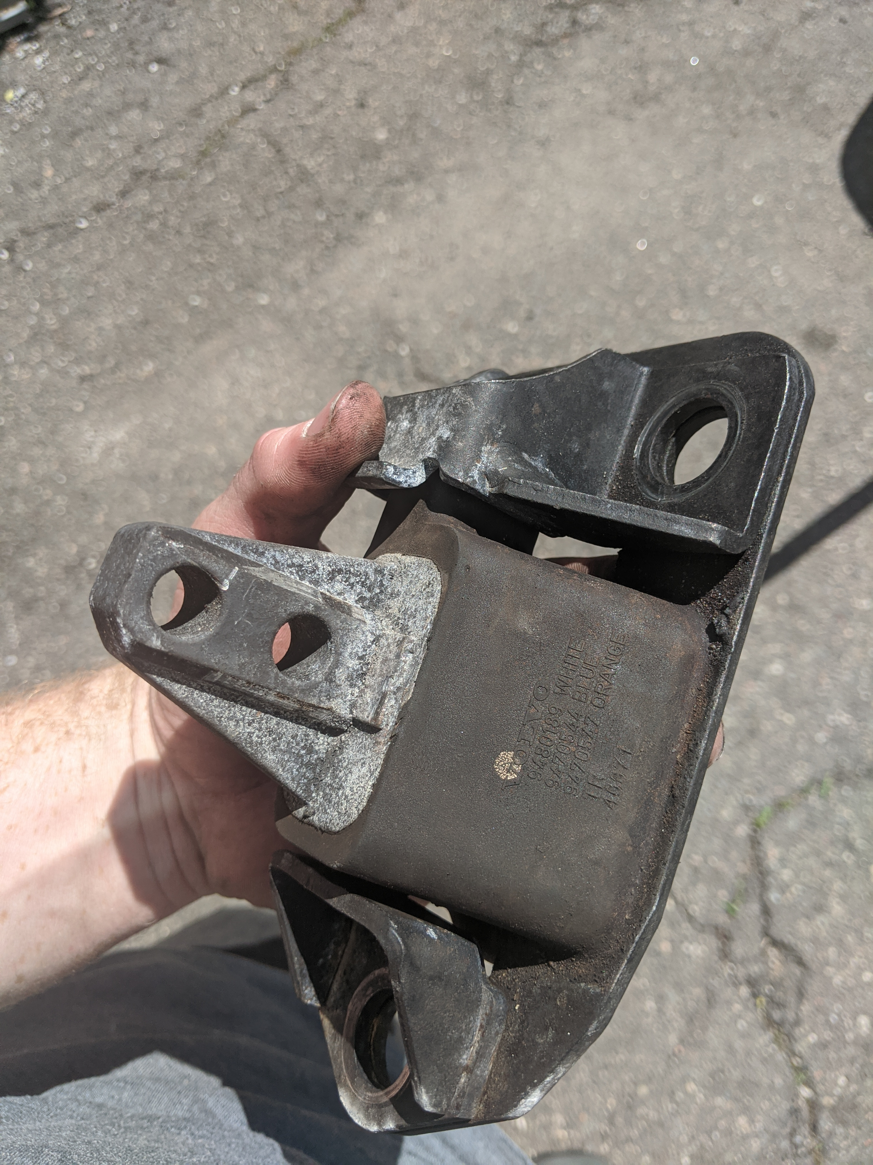

I'm thinking it's the lower right motor mount, which I might've pried at weird angle during the oil pan job. The sound does seem to come from the right side, and the engine moves alot when I push on it

That is exactly the same issue I was having. Turning the steering puts sideways pressure on the sub-frame mounts ( yes the 4 in each corner of the sub-frame that mount it to the body) allowing the torque of the wheels turning to move the springs toward the inner fenders. The springs also tend to twist and deform when the steering is turned which exaggerates the twist of the spring inwards towards the inner fender.

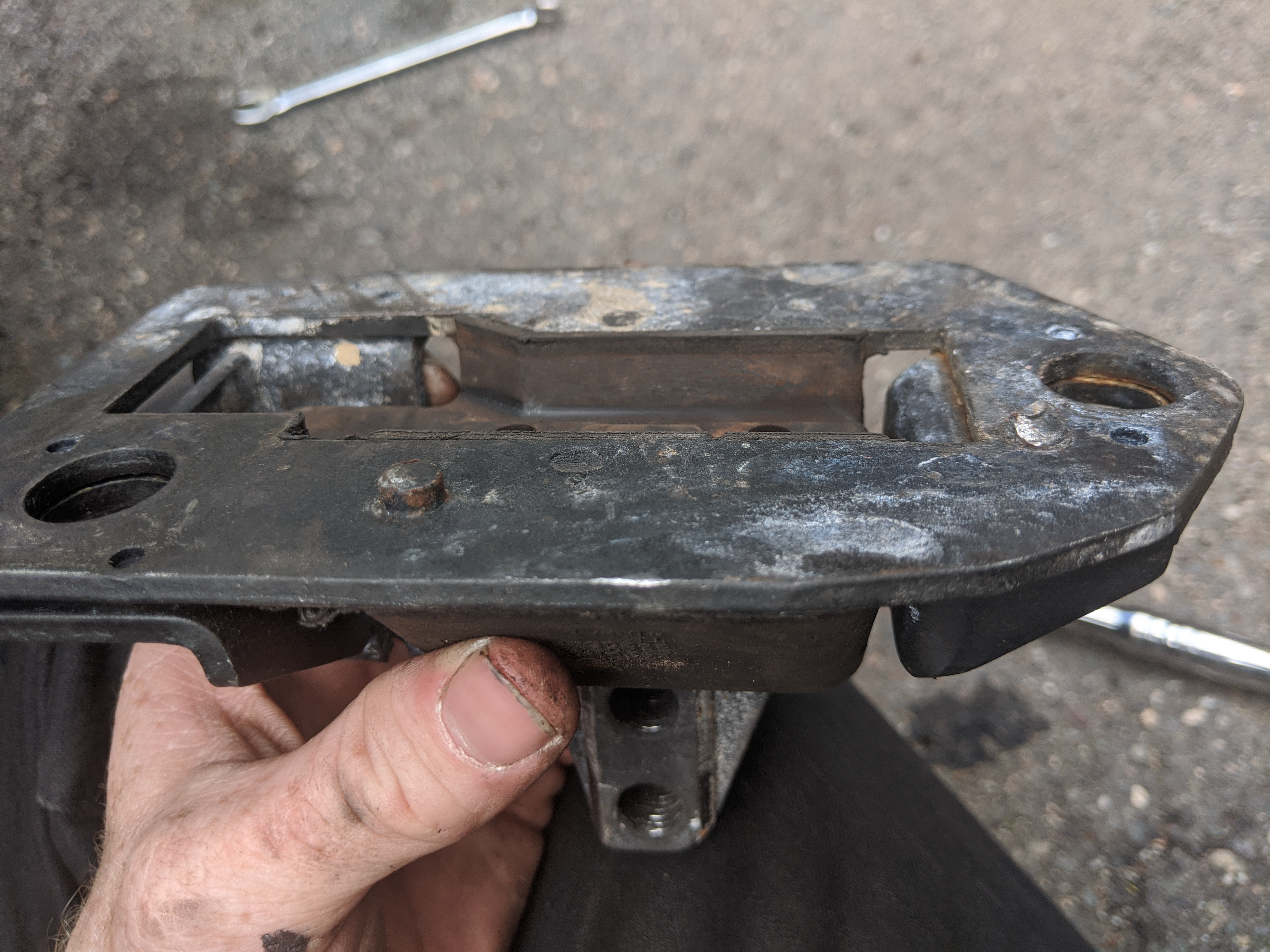

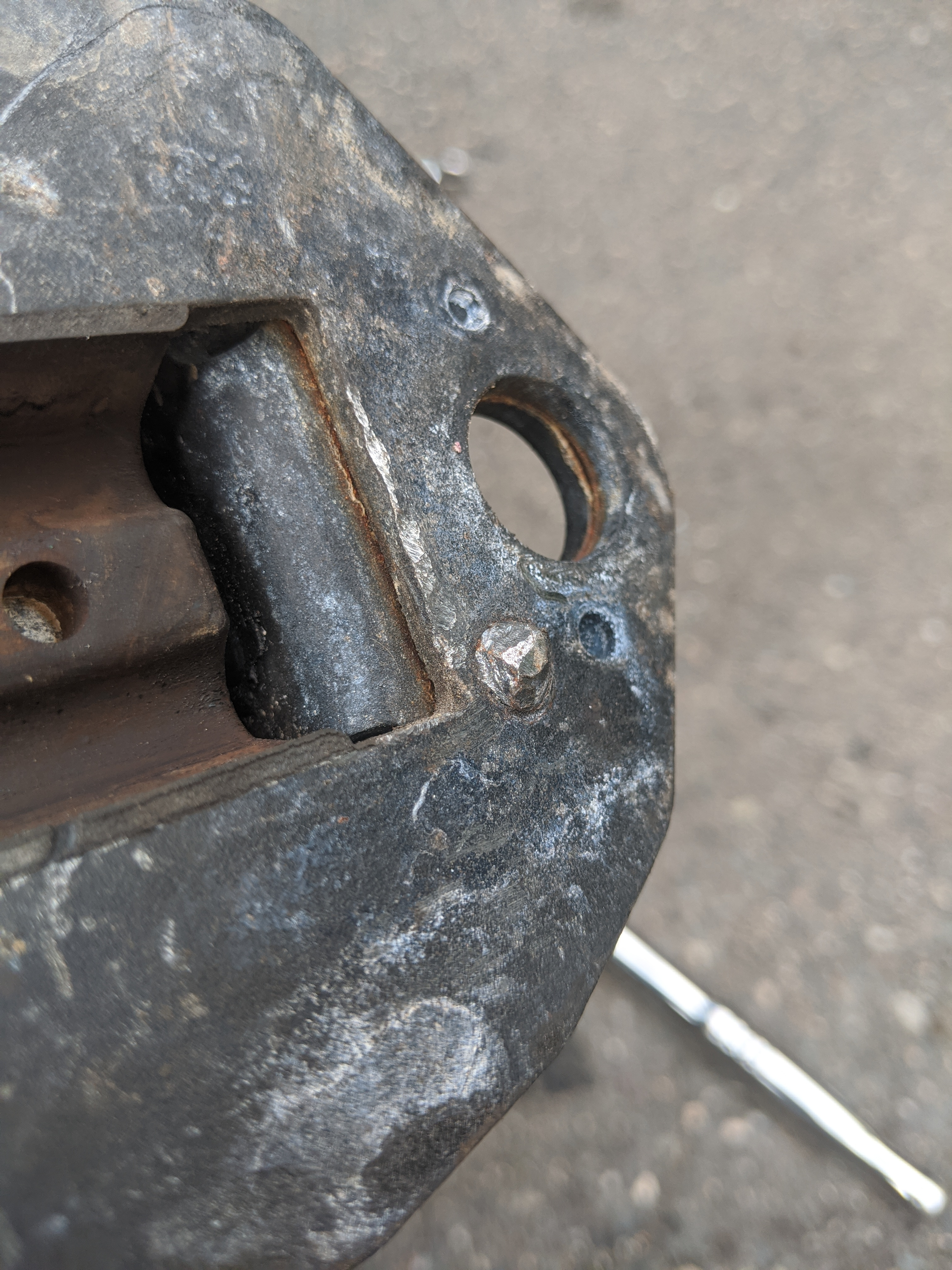

I'm fairly confident it's not the motor mount, only issue I can see on it is this little nun that seems like it makes the mount sit in the right spot for holding the motor. Looks like it's been pushed crooked, maybe from when I was trying on the mount to make space for the oil pan. I tried to hammer it back straight which obviously didn't do nothing. Otherwise the mount looks good

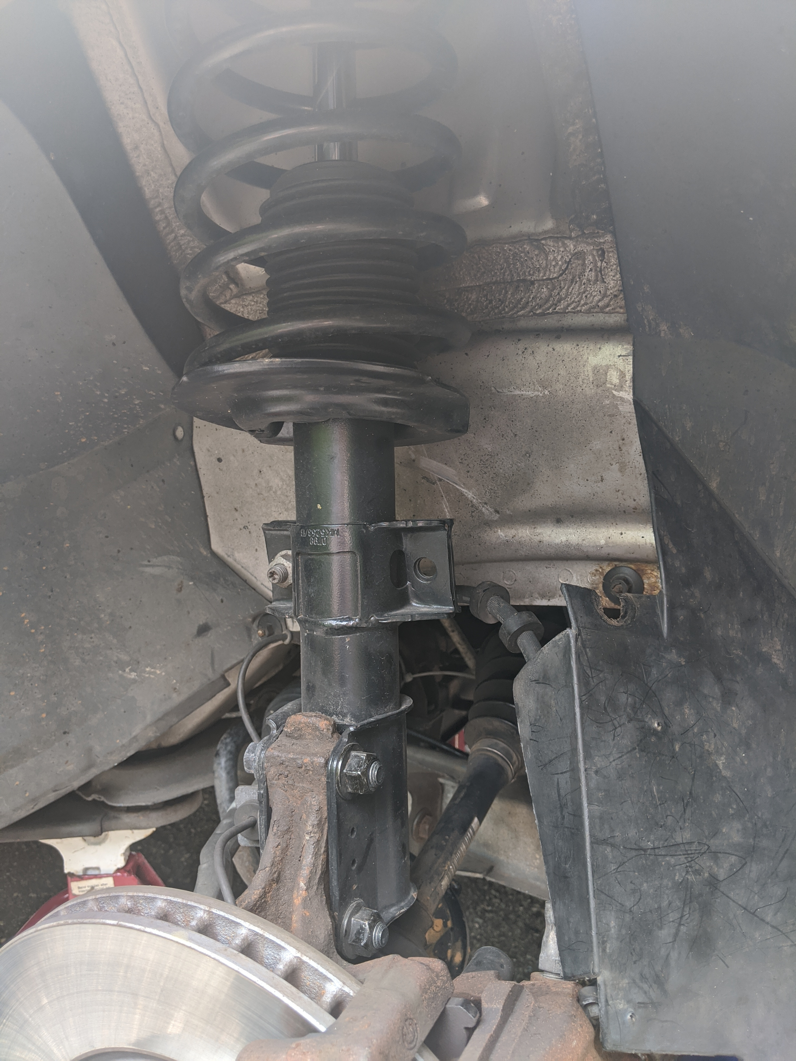

Otherwise the struts.. it does look like there's some rubbing marks.. this is the right side strut with the wheel off and on Jack stands
