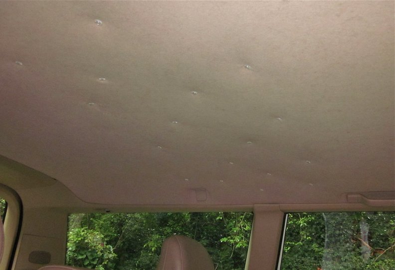

I too had a headliner that was starting to sag over the passenger seat. I know the way I fixed it wasn't up to a professional standard, but it only cost about $5 and took me about 10 minutes to pin the fabric in place with upholstery twist pins. So far, it has been holding up pretty well and is not too bad of an eyesore.
Upholstery twist pins used to hold headliner fabric up against the underlying fiber board.
