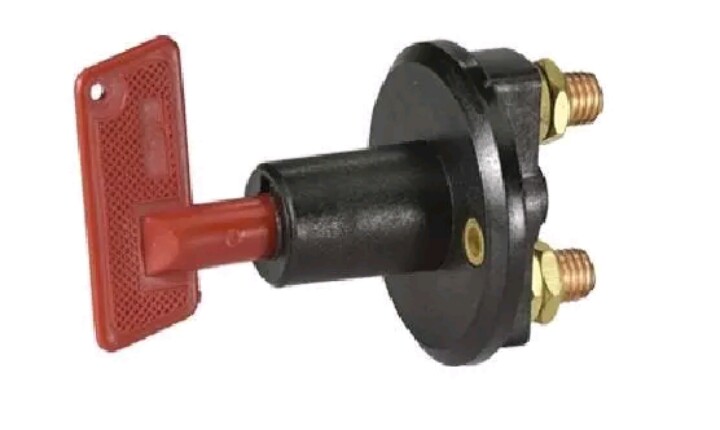

To answer the question you can install a cutoff switch on the red cable on the way to the starter on a P2 because it branches off at the jumper point to fuses and the rest of the system. The solid red cable only serves the starter system on P80s as well so a switch in series with this cable is fine and will still allow power to computers and ignition systems.
You would need heavy terminal lugs and a crimp tool to fit the type below.
The switches that go on top of battery terminals aren't suited for the reasons Abscate mentioned above.
