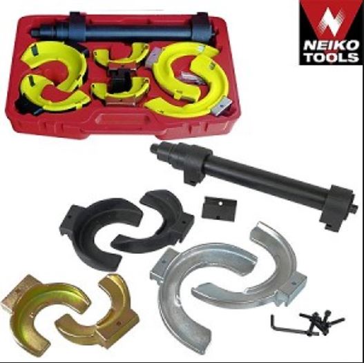

All those are useless and potentially dangerous. I used to have one like 'DN-B1005' pictured by oragex. I didn't feel comfortable using it (only once). About the time I bought the Volvo I did some research and purchased the Neiko 50613A, for about $100 off either ebay or amazon.
Worth every penny.

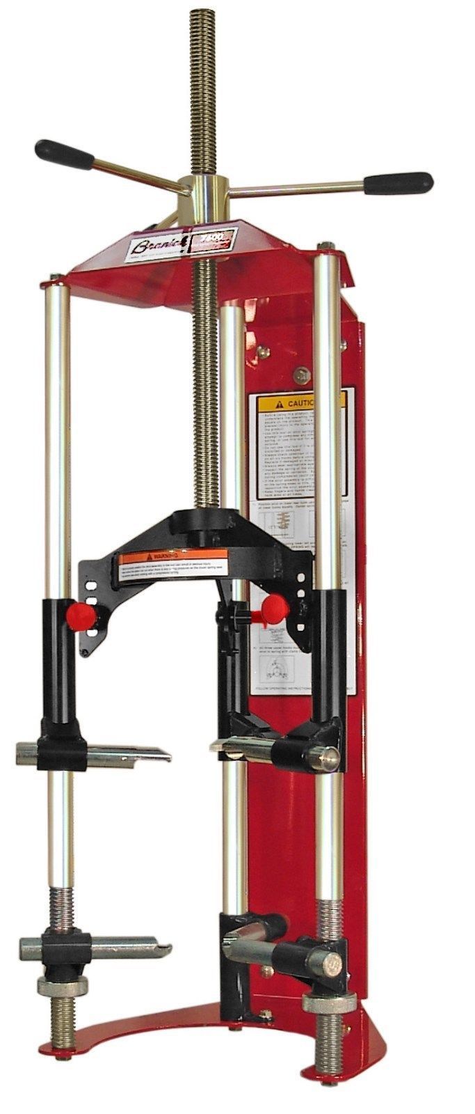

If you check around the gas stations here in Fairbanks,
several have the wall mounts in-shop and their labor rates
are generally MUCH more reasonable than any dealer.
A buddy of mine has this model at his shop and it's awesome!
Branick 7600 Coil Compressor.jpg (103.46 KiB) Viewed 1342 times

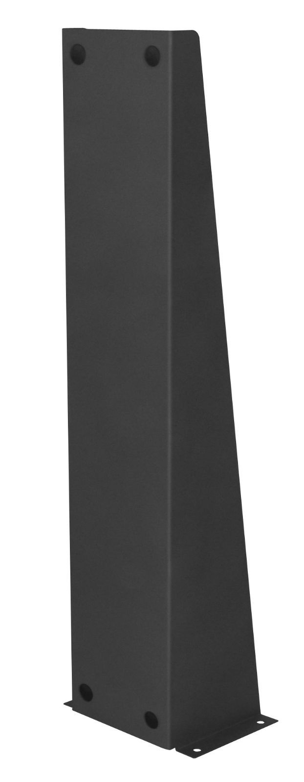

You can add the bench mount for your place, Neil... :)
Branick 7600 Bench Mount.jpg (28.98 KiB) Viewed 1342 times
