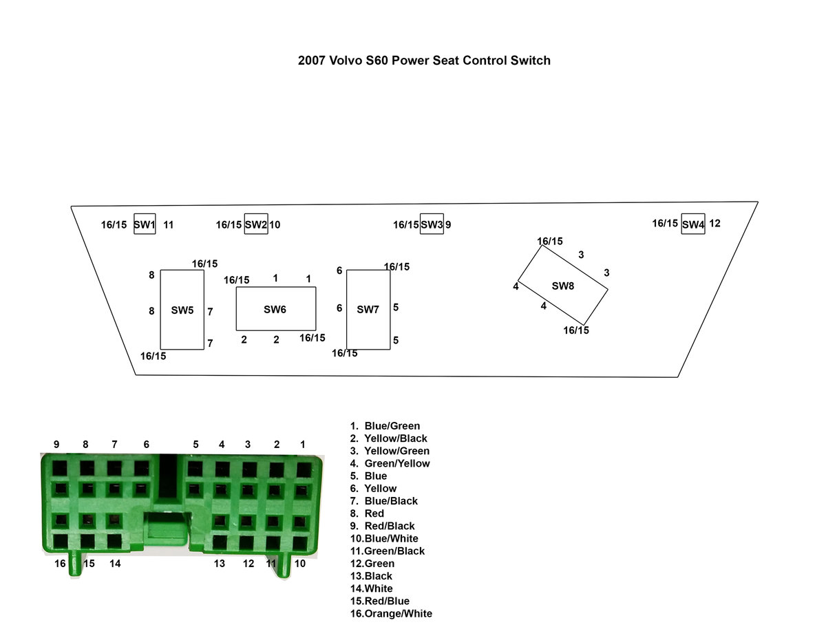

I'd also like to get the drivers side working. After poking around with the meter this is what I came up with.
pin 13/Black & pin 14/White are common but I don't see anywhere else on the board they are connected. Jbeebo, or anyone else, know how to get this working without rewiring the motors?

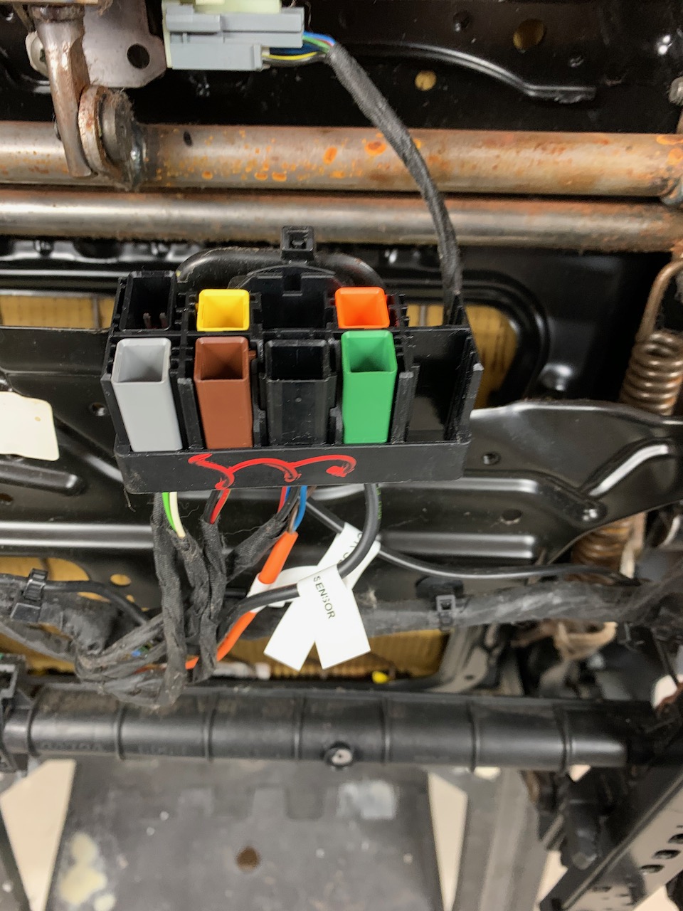

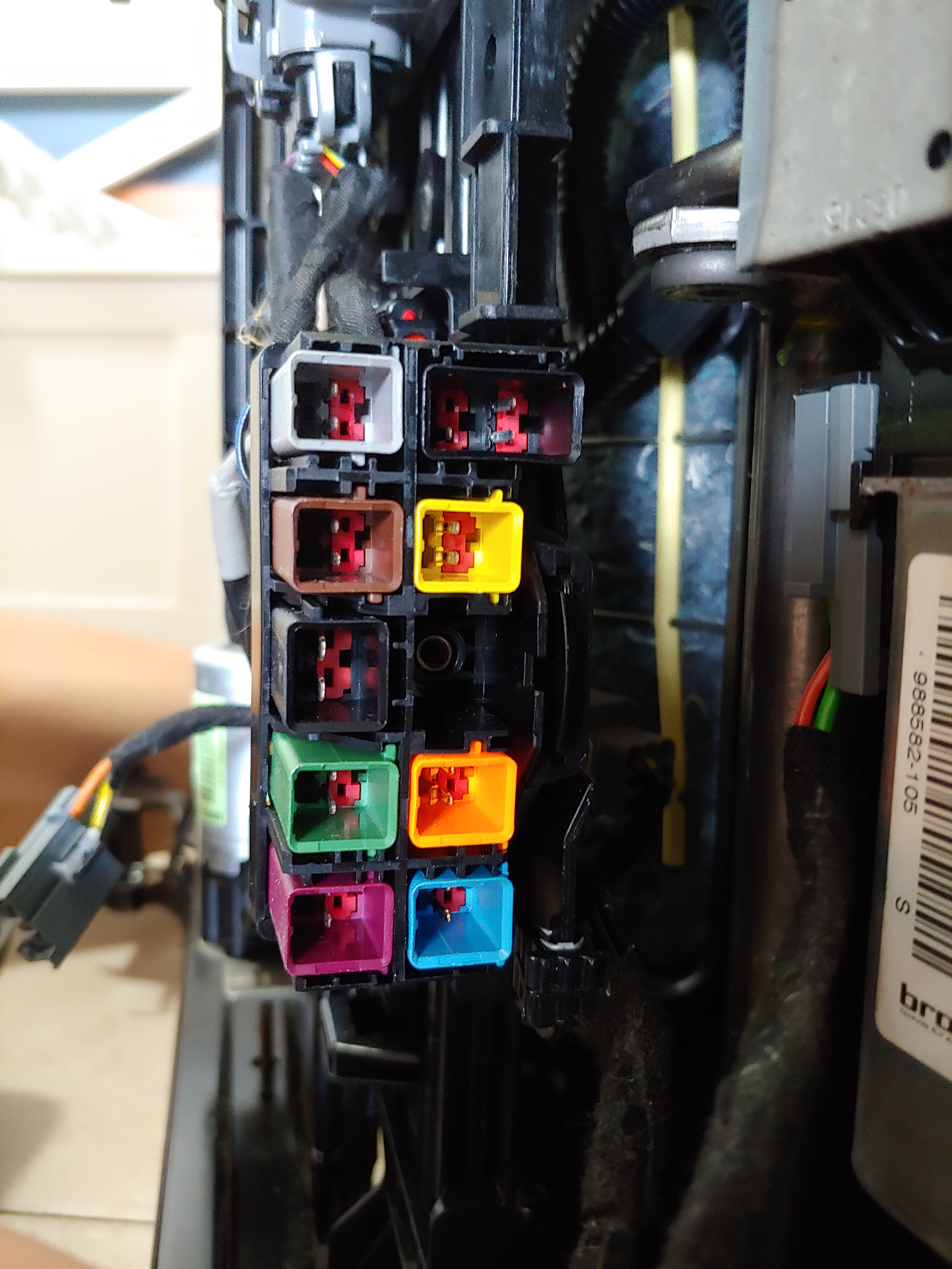

I have a vintage 1969 Volvo 131 that I am preparing for an enduro rally. I want to install seats from a 2008 C60 that I purchased - car was a mess but seats were good. Attached is the driver side underseat plug layout. I just need power to run the motors for the seat functions. Is there an easy way to do that by tapping into one of these plugs? Not concerned about the memory function. Thanks!
It appears that orange is side airbag (not needed), yellow is a seat slide sensor ( I assume on impact) (not needed) , green is the seat belt latch sensor (not needed). THe others I'm not sure of.

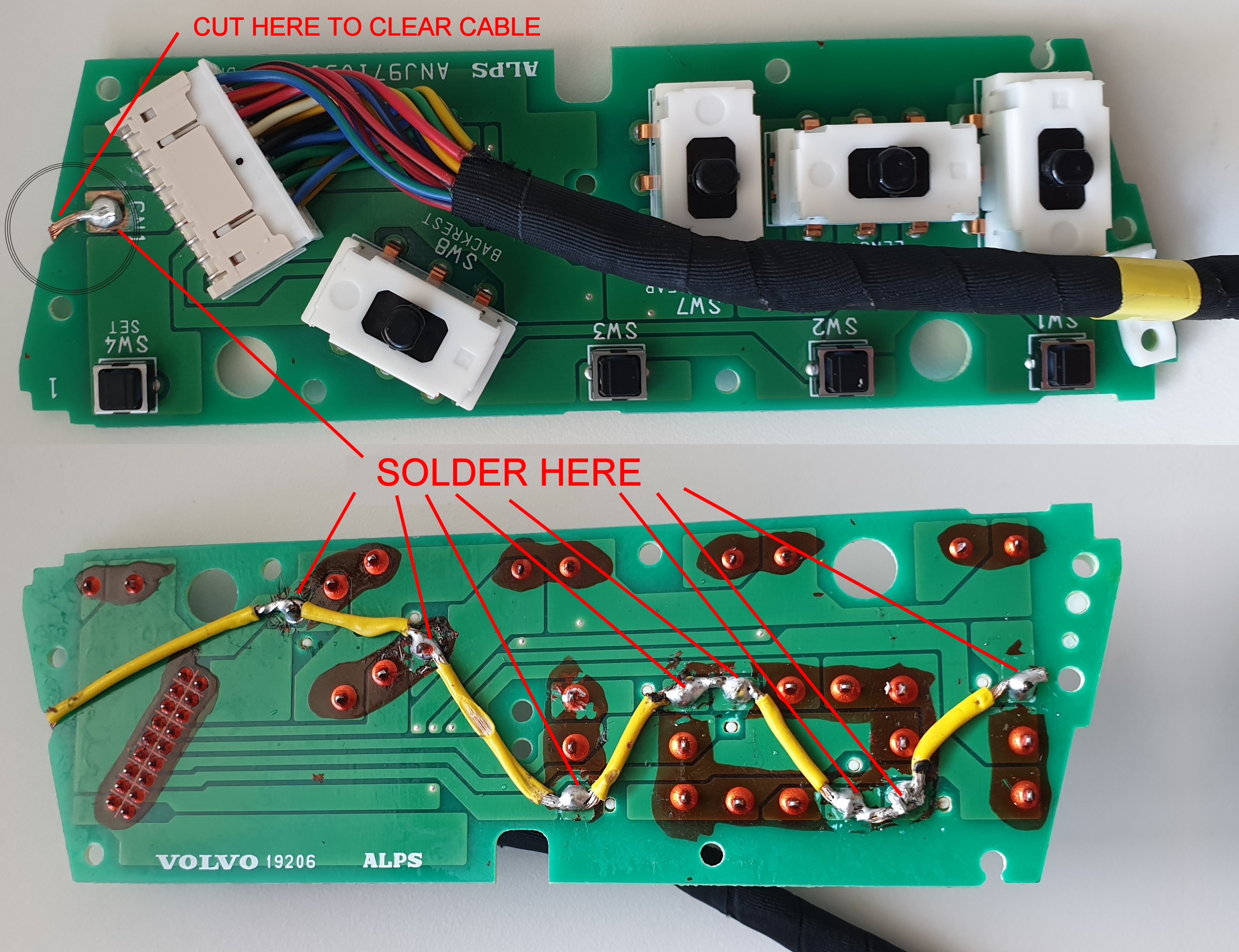

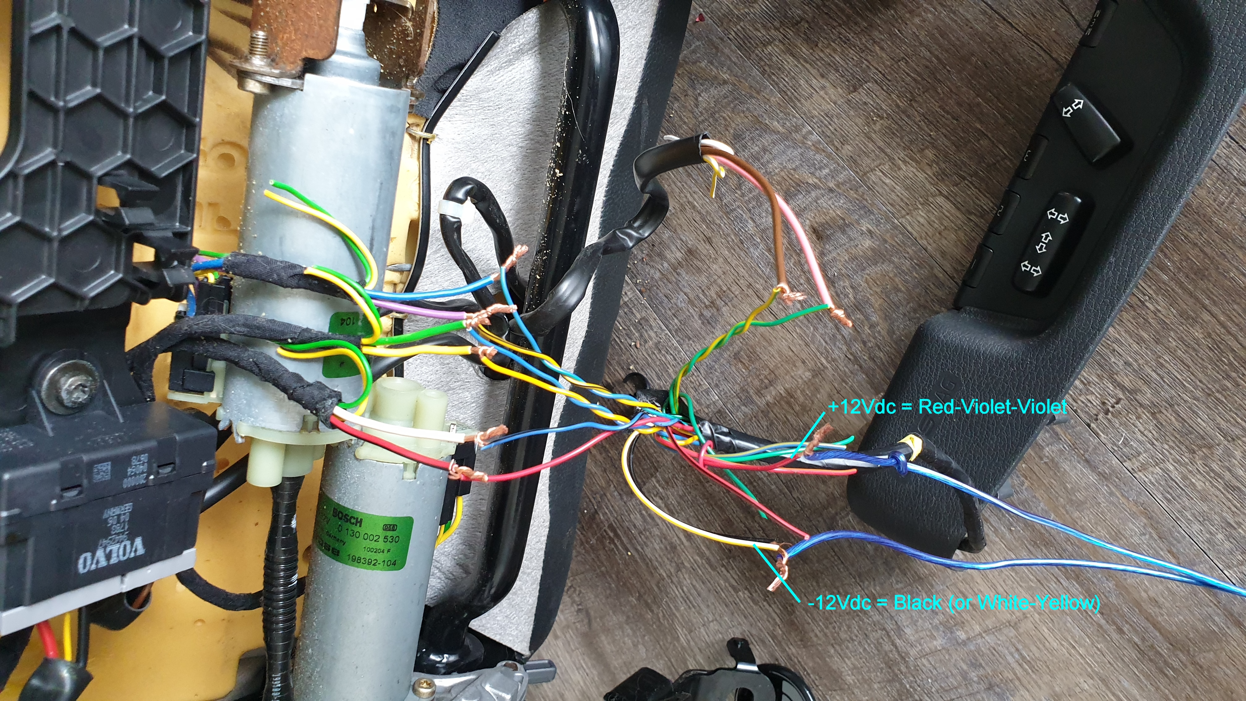

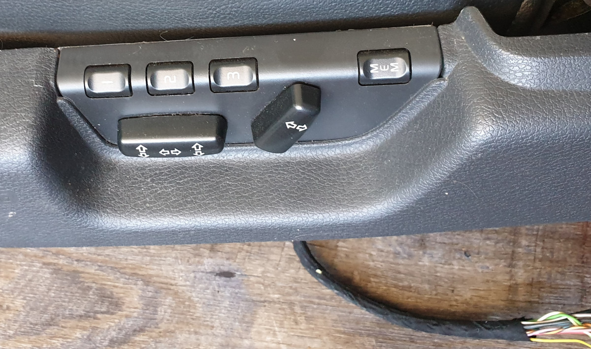

For the 2003-2004 seat model, see the following pictures.
You will only have to connect motors and battery to the freshly cut switch cable, as shown in the last image.
Mathew, thank you for this site.

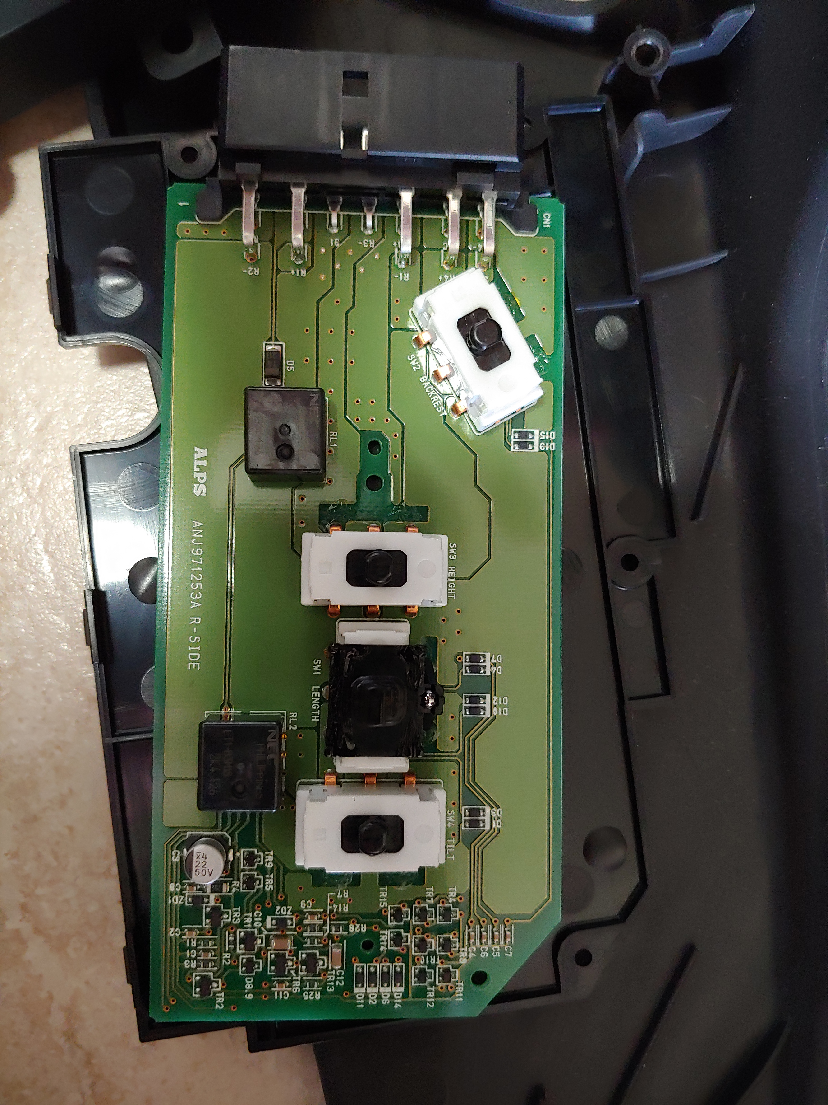

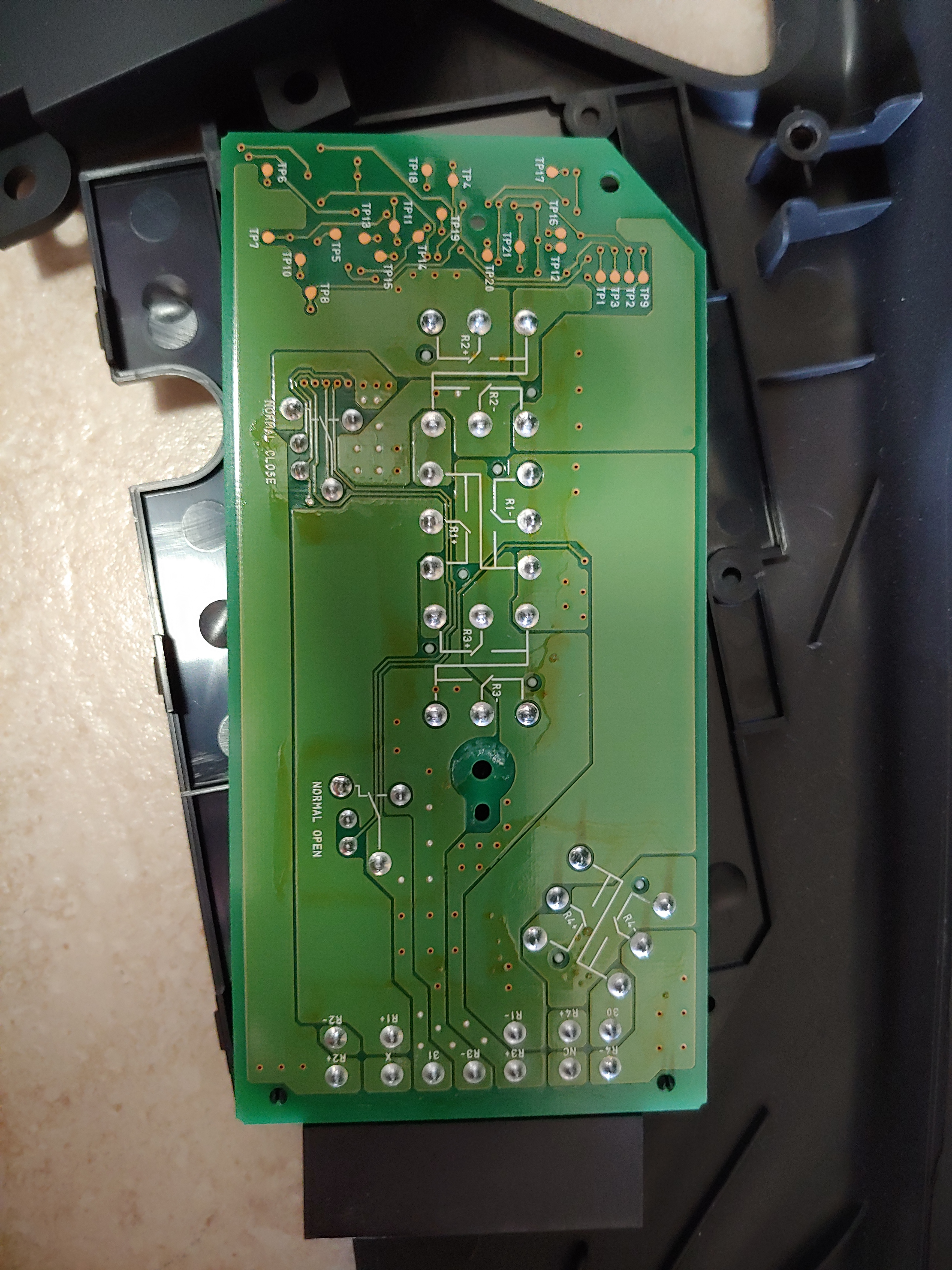

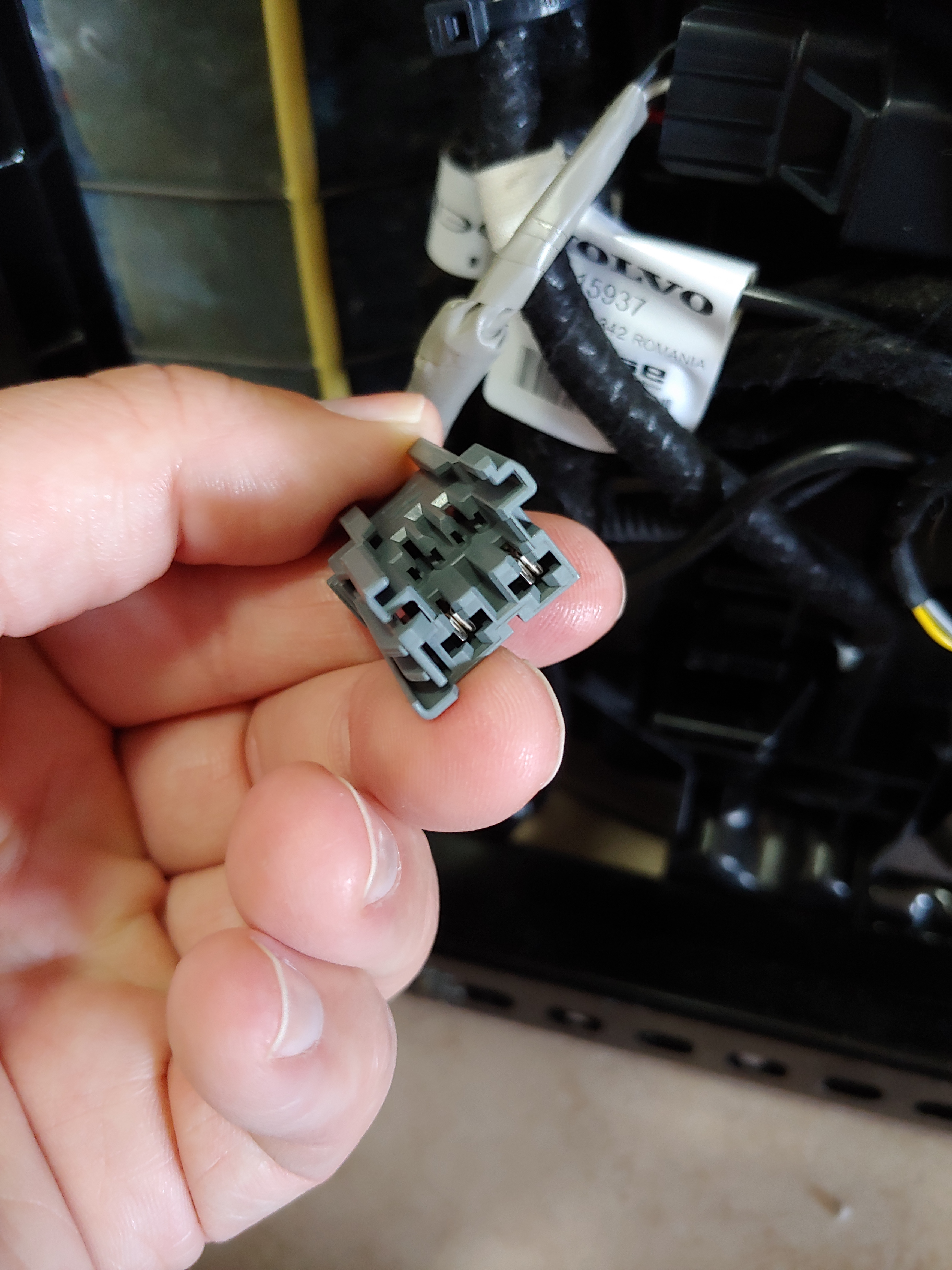

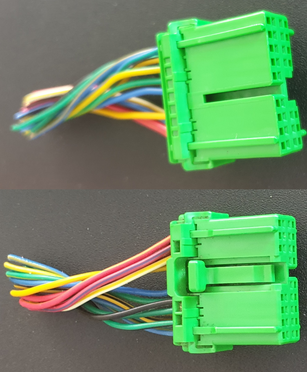

Hi all, came across this while also looking to turn a seat into a computer chair. I have one from a 2012 xc60. The board is similar it seems but the contains are embedded. I was wondering if the bypass work around world of connecting the ground to terminal 2 switch 2 would still work? I'm attaching images of the board and connectors to the chair. Hope this is enough info happy to do whatever necessary to figure it out.
Bogdan
Posts: 5
Joined: 24 May 2020
Year and Model: S60 2.5T-AWD 2007
Location: Burlington, ON
Has thanked: 2 times
Been thanked: 2 times
Post by Bogdan »
It appears the switches are the same.
Yes, you can do it.
R1+, R1- will go to Motor 1,
R2+, R2- will go to motor 2 and so on.
All you need is to provide 12V on 30 and 31 and make sure you have + and - in an "X" pattern for each switch.
