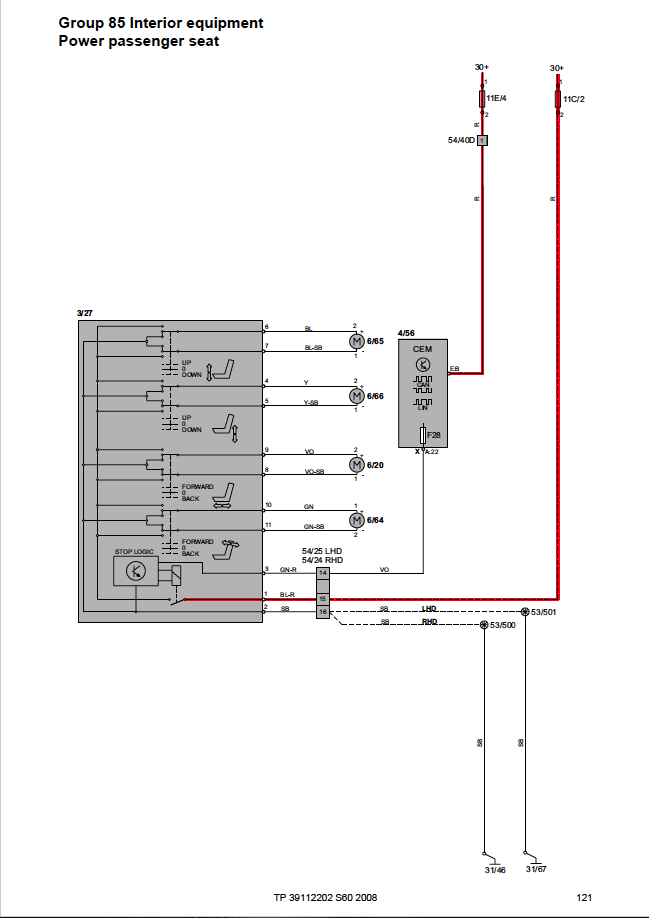

I have a strange request for assistance on getting 12V power to a 2009 S60 passenger side seat. I am using the seat in an Obutto gaming cockpit that I use for race simulation. I would greatly appreciate if you can let me know what I need to run 12v from either a battery or a 12V power supply.

Thanks jbeebo ... I am usually pretty good with Googling but kept hitting a dead end with diagrams associated to this website. I am good with finding the BL-R and the SB on the connector (in the pictures). I am having an issue with finding what I need to do with the 4/56 and E-B thats in the drawing. It appears the 4/56 is supposed to be on the car under the dash of the car. I do not have the car so I am lost as to what I need to do for the 4/56?

You just need to put fused 12 volts on the green. And green black on the motor to move it. I can't see the colours on the other one but just trace the same motor wires in the forward/back and it should be intuitive

I think you should be able to use the seat switches ...can you find the bigger picture wire diagram and post here so we can noodle it?

Thanks again abscate. This is the full picture of the diagram that I found from the link jbeebo. Again .. I appreciate your willingness to help me out!

I think there's a solution, but will require modification of the seat switch module. It looks like you'll need to bypass the "Stop Logic" circuit in the switch module. It also looks like the switches themselves control the high current for the motors.
I'd open up the switch module, bust out your soldering iron and take the 12V signal directly to each switch.
