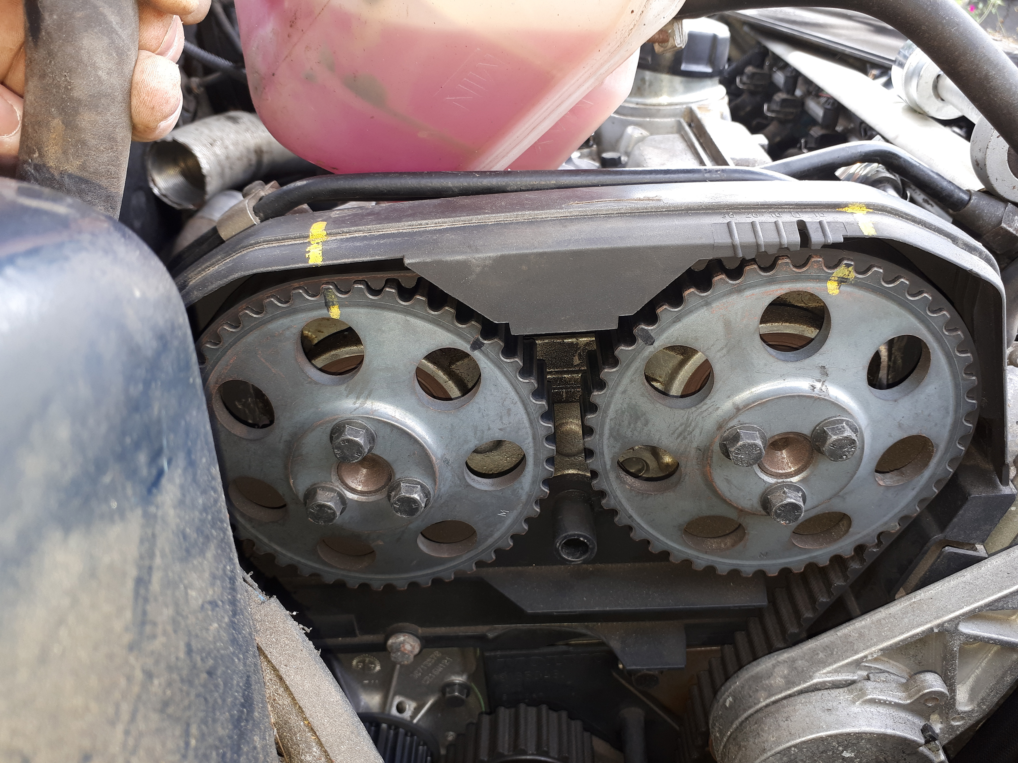

I had to wait for a week for the new CPS to arrive, spent 10 mins to take out the old and put the new in and about 3 seconds to realize replacing it didn't do the trick, apart from clear the code.
I took off the timing belt cover and the timing marks I used when I replaced the timing belt are all right on the dot.
I couldn't get a good picture of the crankshaft mark, but it's where it's supposed to be.
