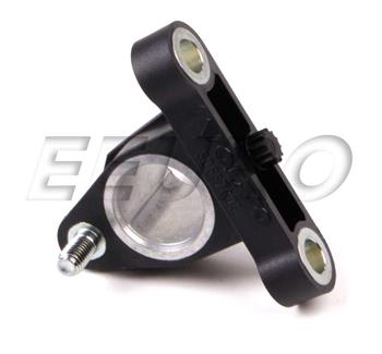

>See Pic of Crank position sensor
Crank Position Sensor (new)
crank position sensor.jpg (4.6 KiB) Viewed 13534 times
>See Pic of Crank position sensor Mounting Bracket top side showing alignment post
Crank Position Sensor Mounting Bracket
crank position sensor mounting bracket.jpg (10.73 KiB) Viewed 13534 times

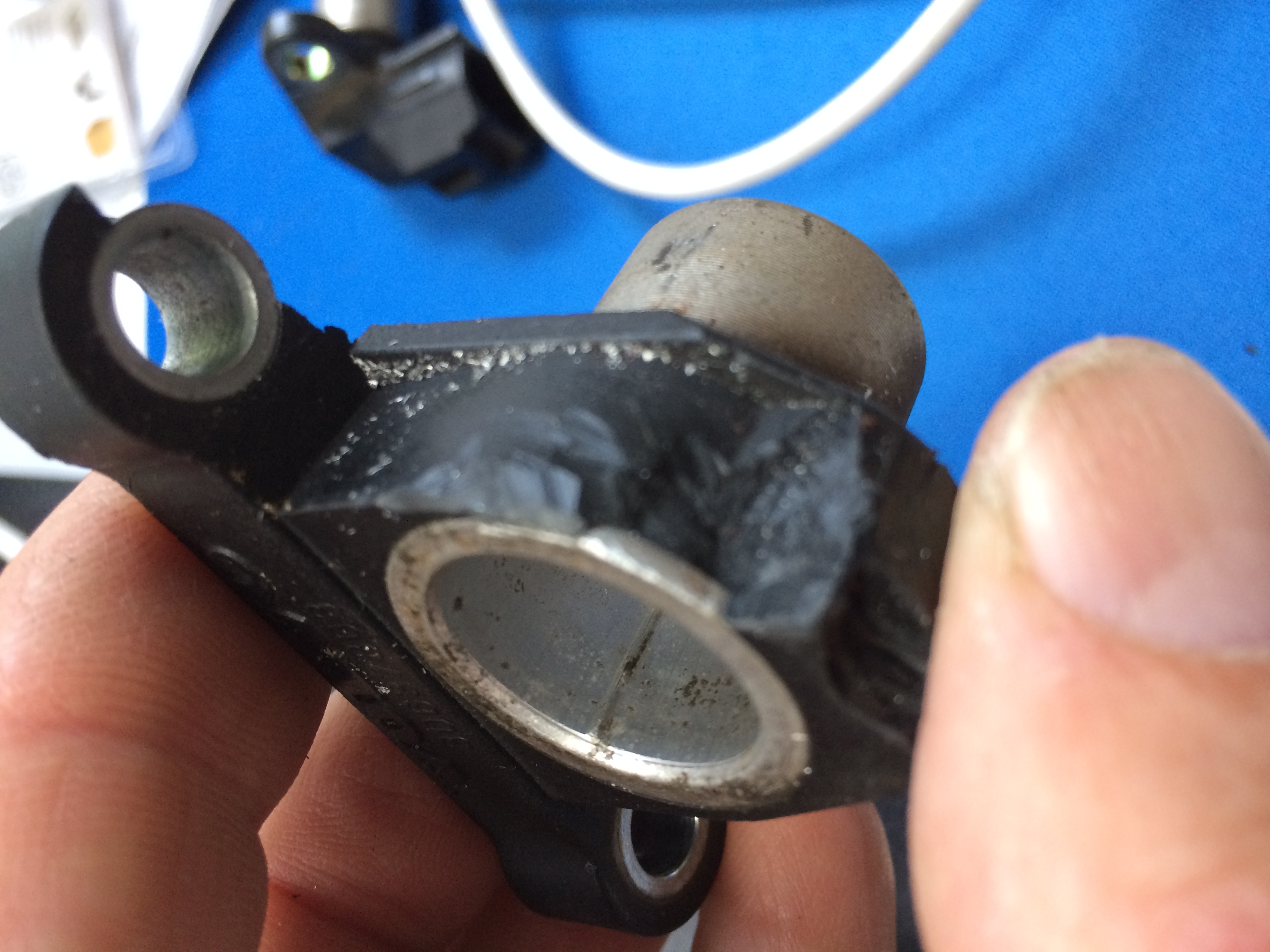

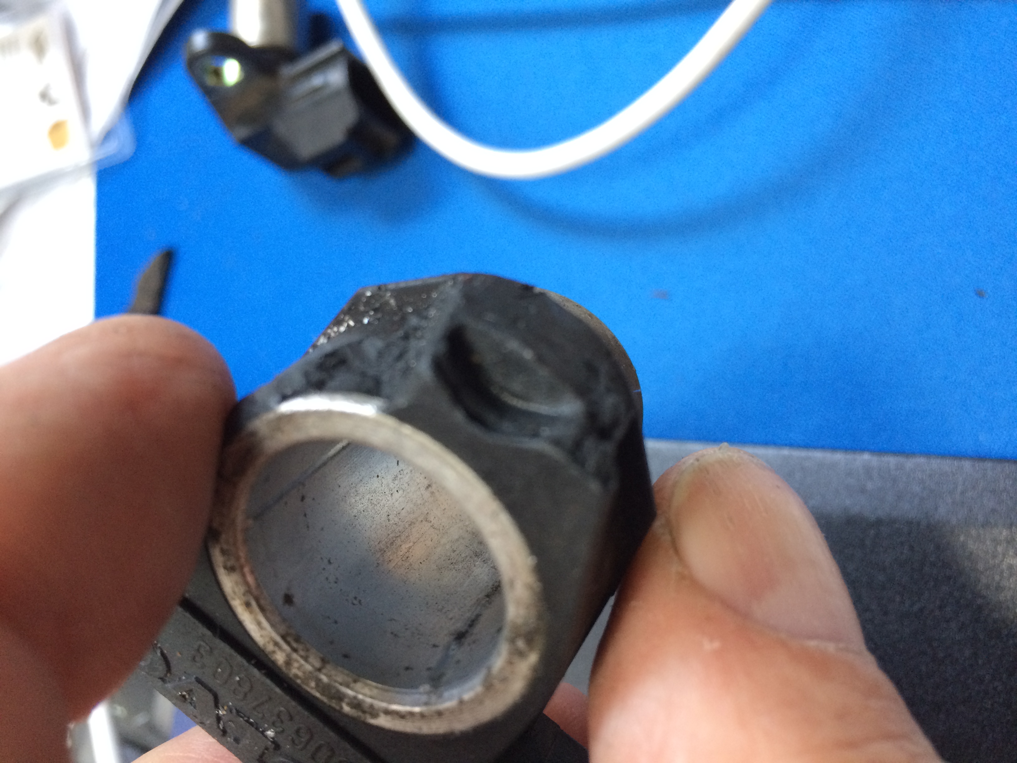

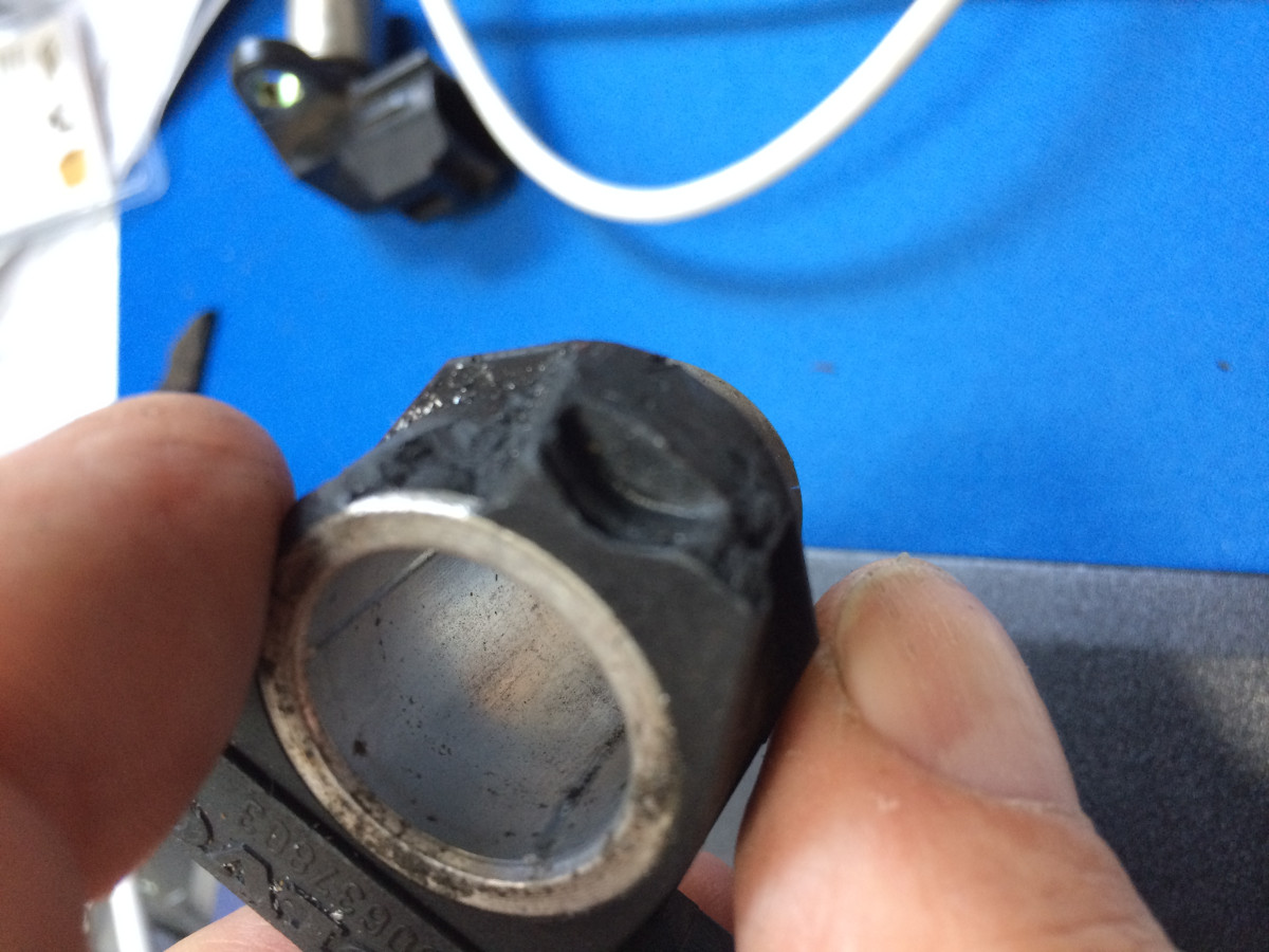

>See pics of broken crank position sensor due to failed bake lite plastic
Note failed Bakelite on Mounting Bracket
Note failed Bakelite on back of Mounting Bracket
Note filed Bakelite that used to hold the 10mm hold down bolt
How? Basically, without the hold down bolt and nut the Crank Position Sensor can float in the Crank Position Sensor Mounting Bracket and be affected by engine vibration. Typically, during a cold start, the engine vibrates enough so that the floating Crank Position Sensor misses detecting a flywheel tooth and throws a P0017 code. The reason that the hold down bolt breaks off is age, heat and vibration related failure of the Bakelite plastic that holds the hold down bolt to the Mounting Bracket.
Pic of Busted Crank Position Sensor Mounting Bracket (note the lack of hold down bolt)

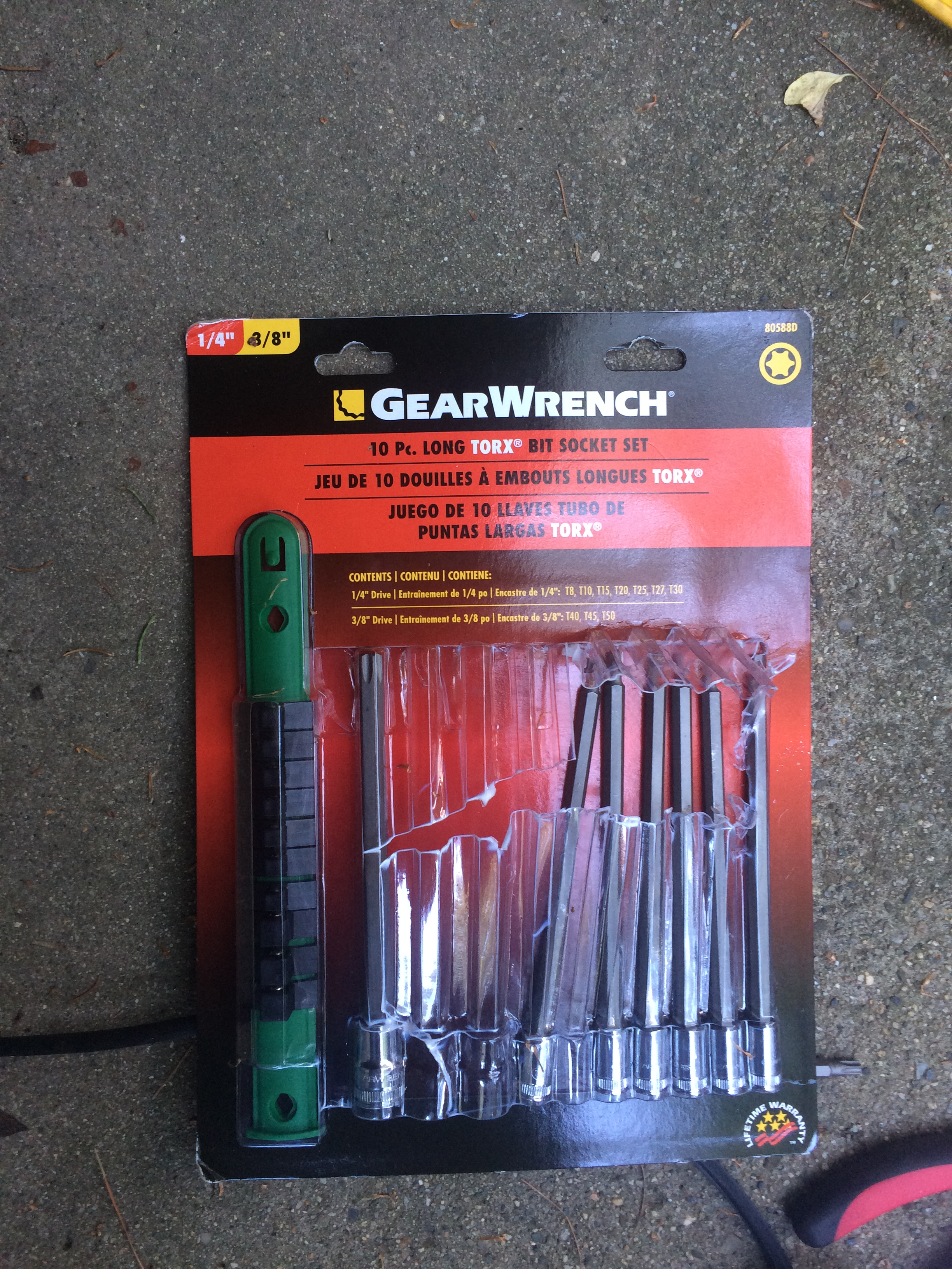

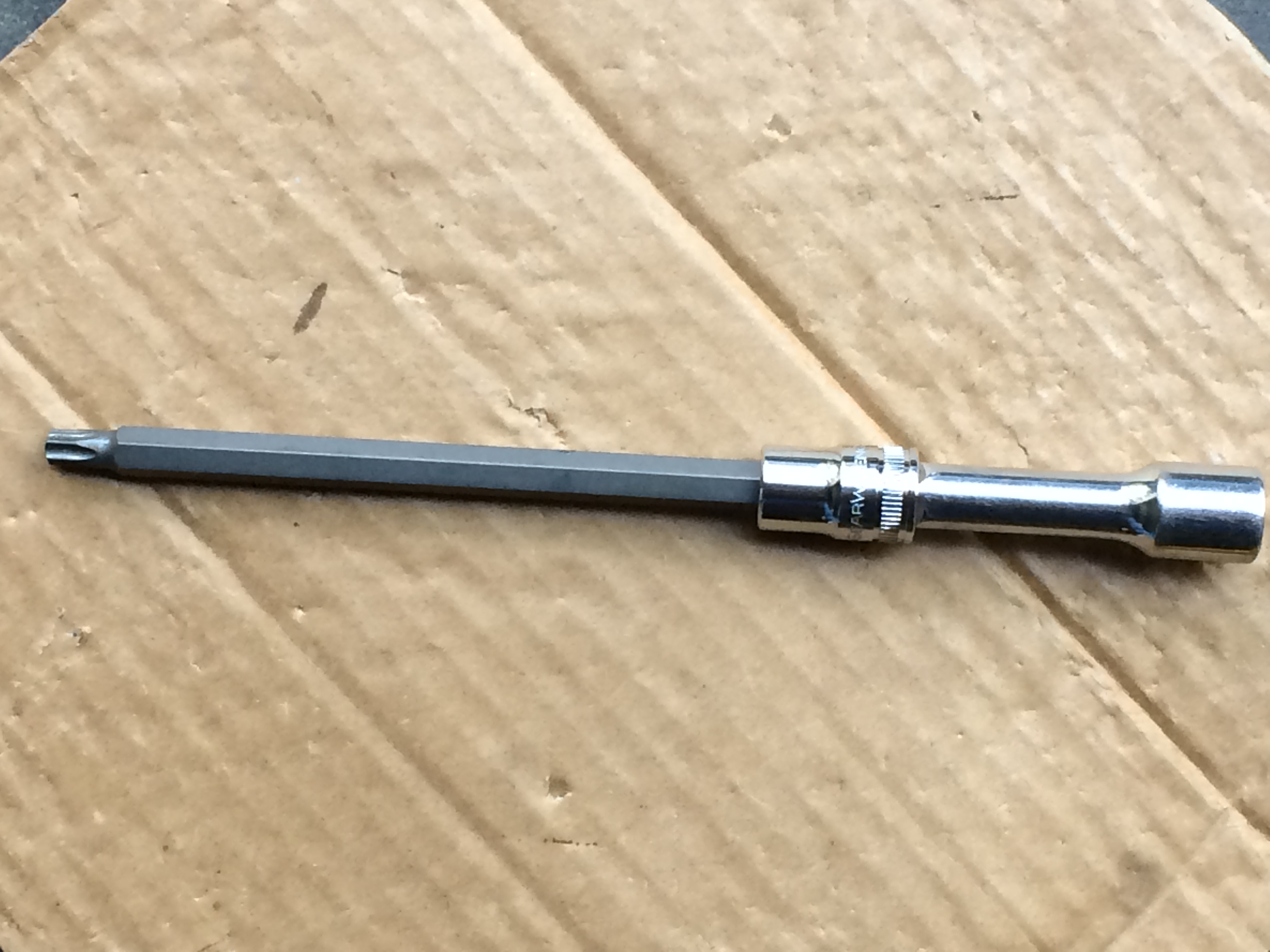

_T40 Torx wrench with 8” long hex body and 3/8” ratchet fitting (Gear Wrench model from Advance Auto)
>See Pic of T40 Torx wrench with 8 in hex extension on 3/8in ratchet fiting
T40 Torx Wrench w 3/8" extension
Gear Wrench Torx Wrench Kit (Advanced Auto)

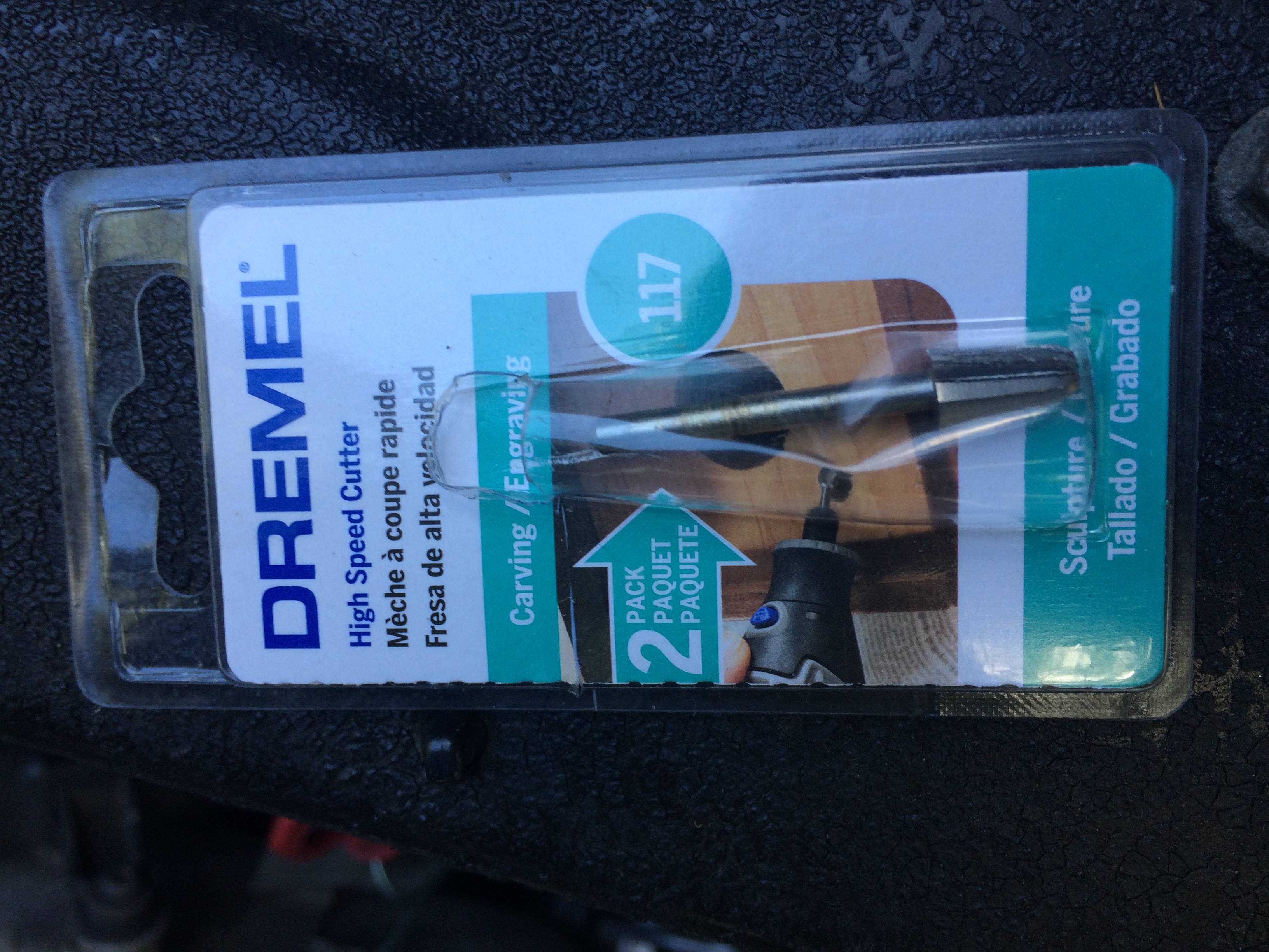

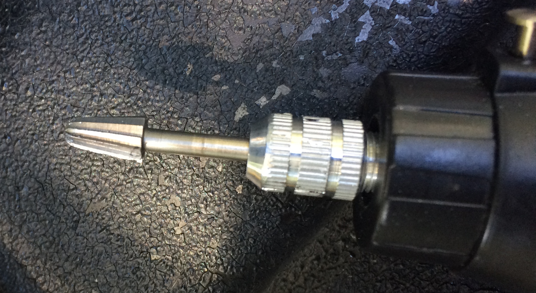

_DREMEL tool with High Speed Cutter Fitting No. 117 (Carving / Engraving)…Home Depot) see pic.
Dremel High Speed Cutter No 117
>See Pic of High Speed Cutter bit mounted in Dremel tool
Dremel Cutter Bit fitted to Dremel Tool

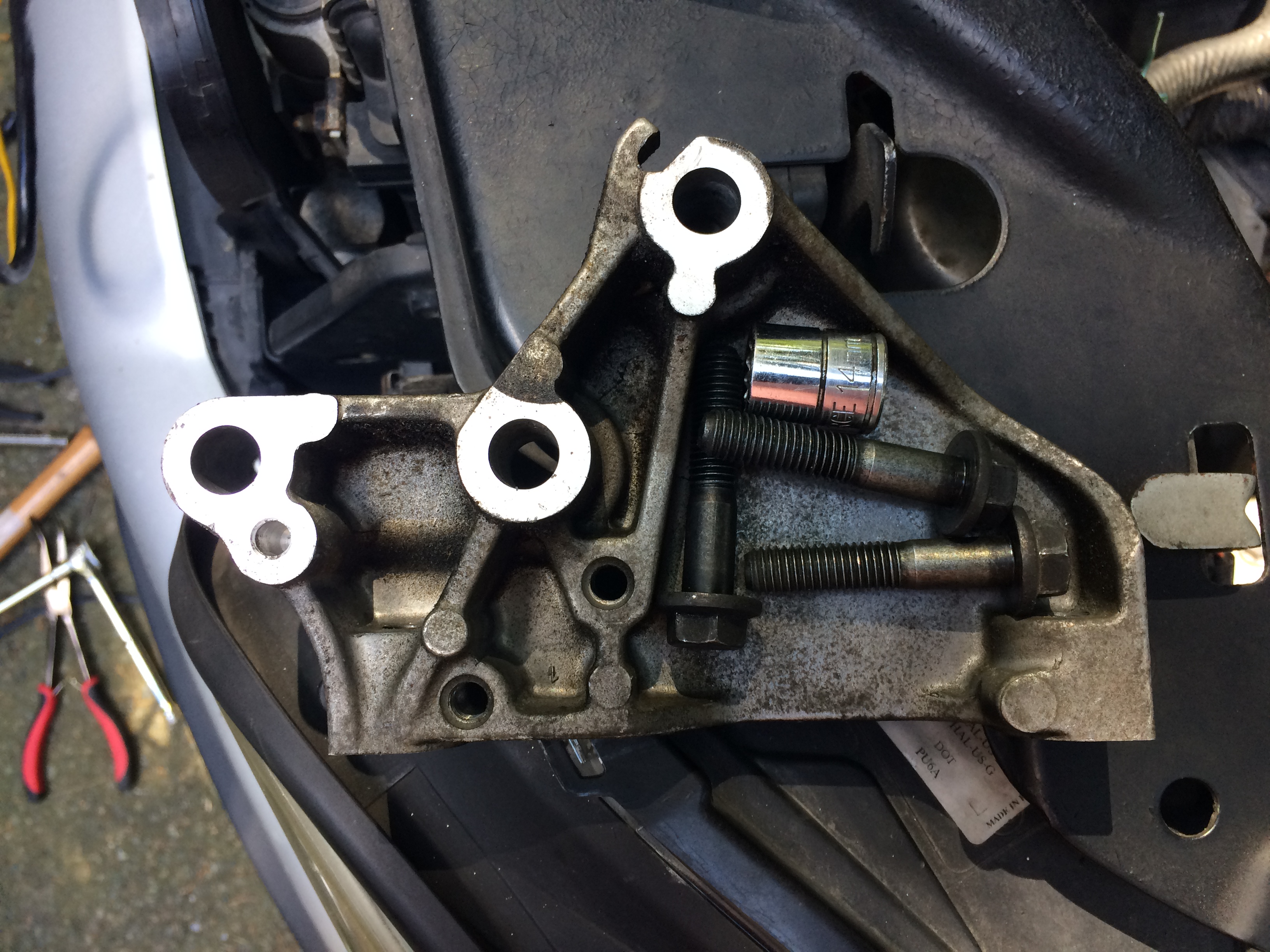

Remove aluminum bracket between engine torque mount and passenger side engine block
- Using 14mm ratchet, loosen the 2 bolts mounted vertically from the engine torque mount down into the bracket…driver’s side.
- Using 14mm ratchet, loosen the 3 bolts mounted horizontally on the driver’s side of the engine block…these bolts hold on an aluminum bracket.
- Remove all 5x 14 mm bolts and slide the aluminum bracket towards the driver’s side…may pry with screw driver but must move horizontally to get bracket of alignment pins.
- Remove bracket and 5 x 14mm bolts and set aside and out of the way.
>see Pic of Aluminum Bracket view facing driver's side
Aluminum Engine Bracket view facing driver's side
>see Pic of Aluminum Bracket view facing engine block
Aluminum Engine Bracket view facing engine block
>see pic of Aluminum Bracket showing bolt positions
Aluminum Engine Bracket showing bolt holes and alighment

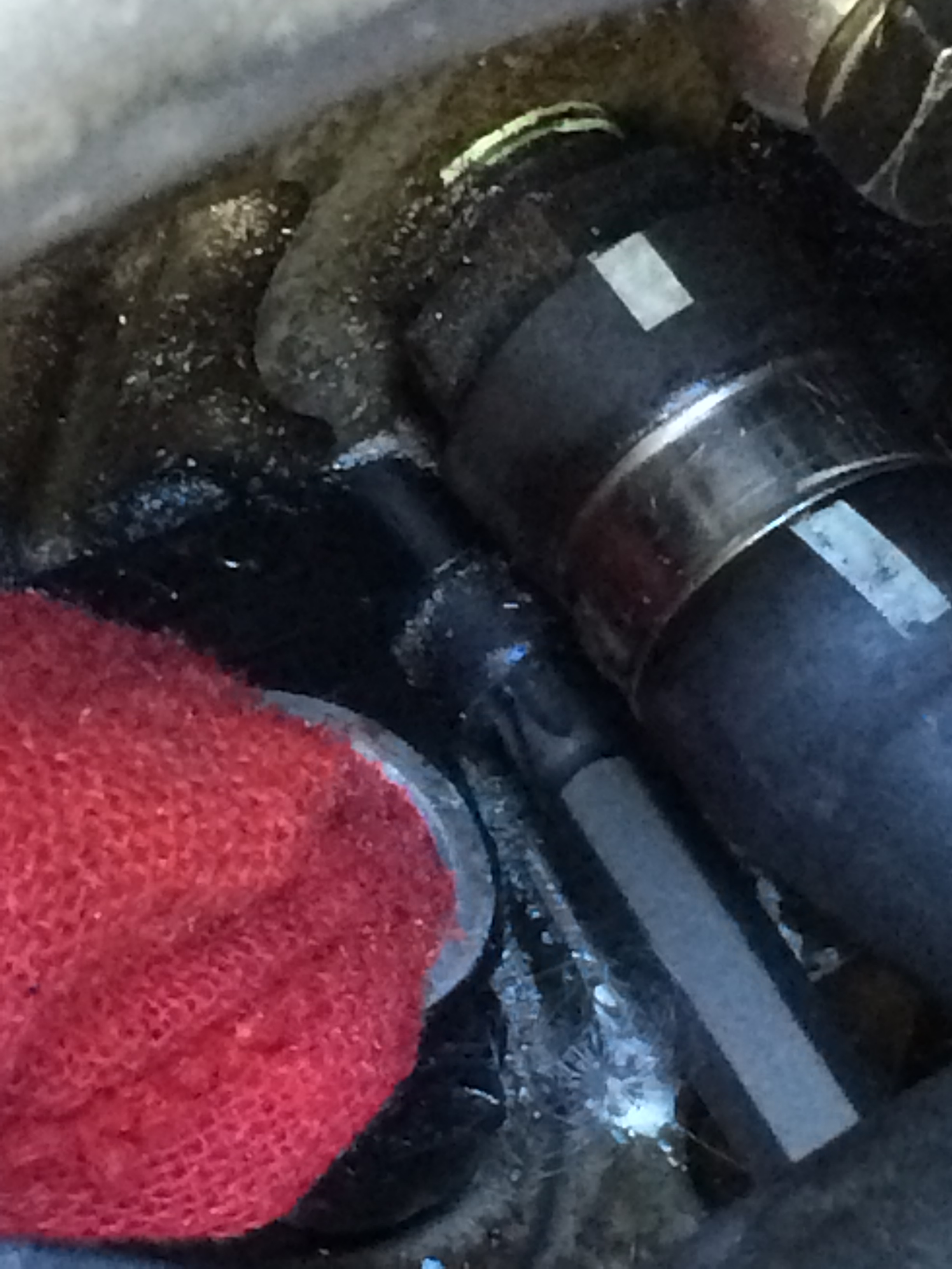

Grind off the interfering aluminum on the adjacent Transmission Bell Housing
- The old mounting bracket should still be in place ... you could get the aft T40 Torx bolt out yet.
- Cover the sensor hole with lint free cloth
- Carefully use the Dremel tool and 1/4" round rat tail file to Grind off a portion of the aluminum feature (on the transmission bell housing) that is adjacent to the aft T40 Torx bolt and interferes with your ability to fit a Torx wrench into it
- Using the DREMEL tool fitted with the bit, grind off the curved trough of aluminum that interferes with the removal of the aft bolt on the mounting bracket.
- Take your time.
- Slope the grind and keep it curved so that the head of the bolt can be accessed by the Torx wrench. The trough will be passenger’s side to driver’s side.
Use the vacuum cleaner and clean cloth to remove aluminum filings

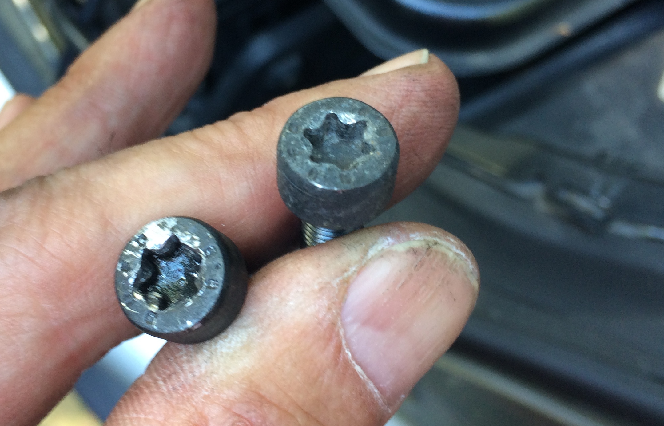

>See Pics of T40 Torx Bolts
T40 Torx Bolts
T40 Torx Bolts

- Reinstall the aluminum bracket onto the engine block
Install the Aluminum Bracket onto the engine block and Transmission Torque Mount
- Install the bracket by setting on the alignment pins moving from passenger to driver’s side at correct orientation.
