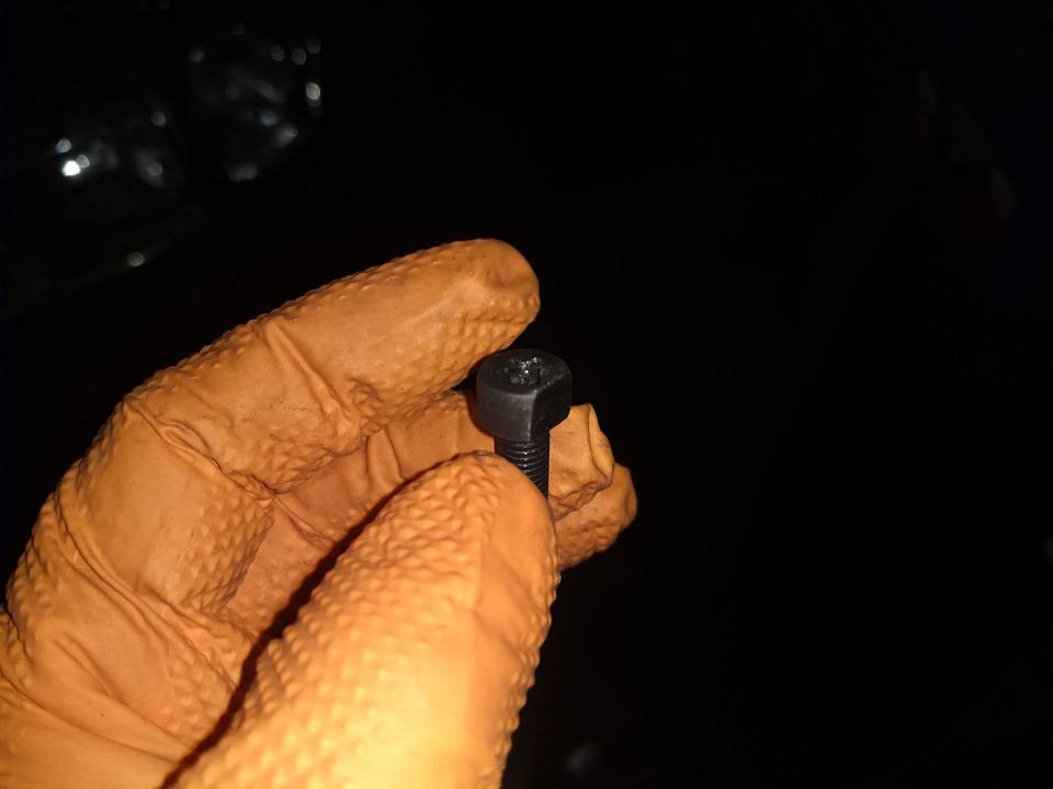

I don't believe it's such a difficult job, it can't be. But I ordered a brand new mount. Same thing happened to me. Except I went in to screw the CPS and the screw itself snapped from the casing.

I managed to get it out and the new one in without serious modifications. To undo the bolt that is partially obscured by the transmission you need to use a chisel made of steel or a material stronger than that. Then you need to remove the water nipple at the head to clear the space. Then you hit the bolt head with the chisel and a lot of force, but not in the middle, but towards the position where it will rotate to unscrew. Then use a flat-head screwdriver to unscrew it. Then you use the same chisel and gently start hitting that corner of the transmission(taking care not to crack that part of the transmission as it is thin) that prevents the bolt from easily sliding in. Then you insert the bolt in the new mount BEFORE you install the mount, but only halfway and then you insert the mount, continuously re-position the bolt in a way as to not get caught in the transmission cover.
Use flat-head screwdriver to tighten the bolt.
