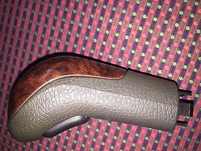

I was thinking about something like this: I just need to pull the old one UP hard and click push the new one in...right?

I've seen that video on youtube before.
Thanks...it's crystal clear now!

Yes the video is a great help! Turn the leather/vinyl boot at the bottom of the shifter knob to release the boot from the shifter. Make sure that the plastic ring does not get loose as it only fits back one way around. By that I mean if it gets turned over then it will not snap back in onto the replaced shifter (as I found out!!). Otherwise as rspi says it is easy, although sometimes they can be a little (no make that very) reluctant to come loose!
