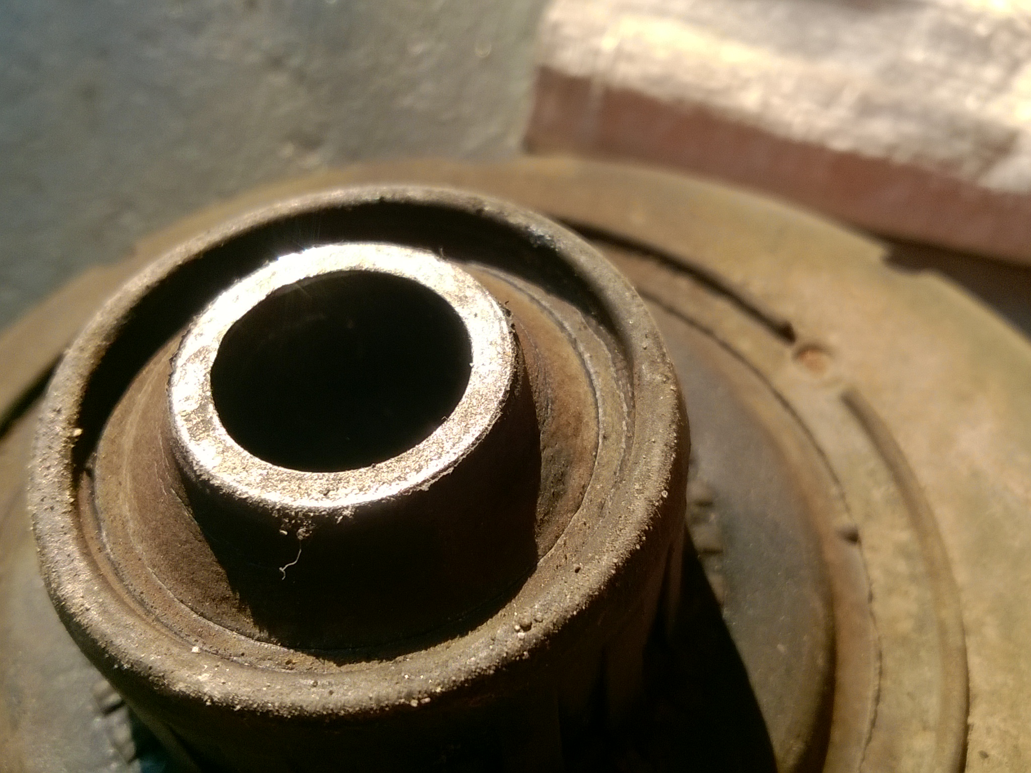

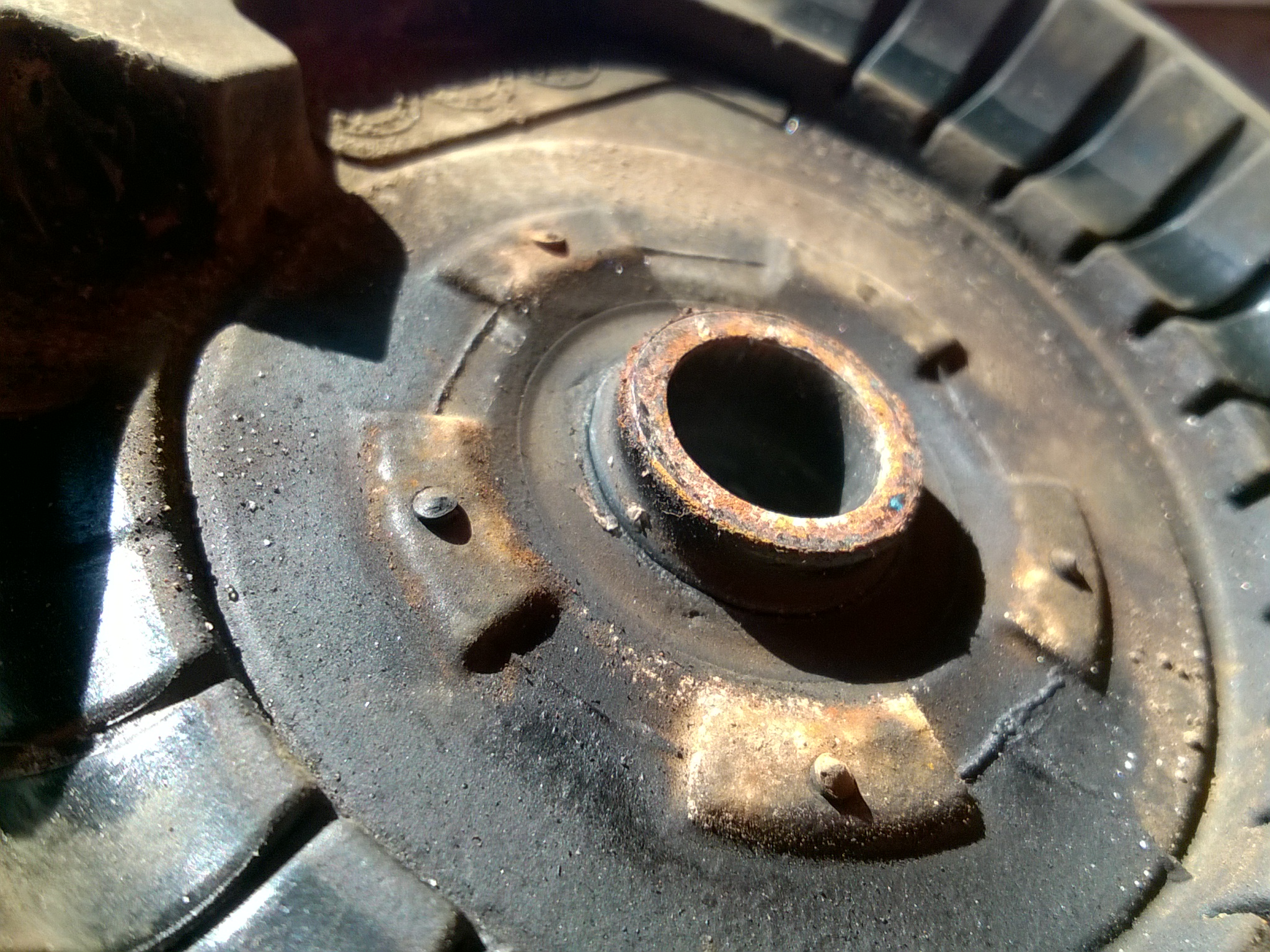

Pulled the spring seats today.. this is how it looks. There is like a 'ring' on the rubber near the sleeve on both sides, but it's not a crack (yet). About 7000 miles on them

Sheesh... I can't wait to see what my Gabriel Readymount spring seats look like... So are you thinking about spraying them down with silicone spray before you install them?oragex wrote: 12 Sep 2017, 21:15 Pulled the spring seats today.. this is how it looks. There is like a 'ring' on the rubber near the sleeve on both sides, but it's not a crack (yet). About 7000 miles on them
