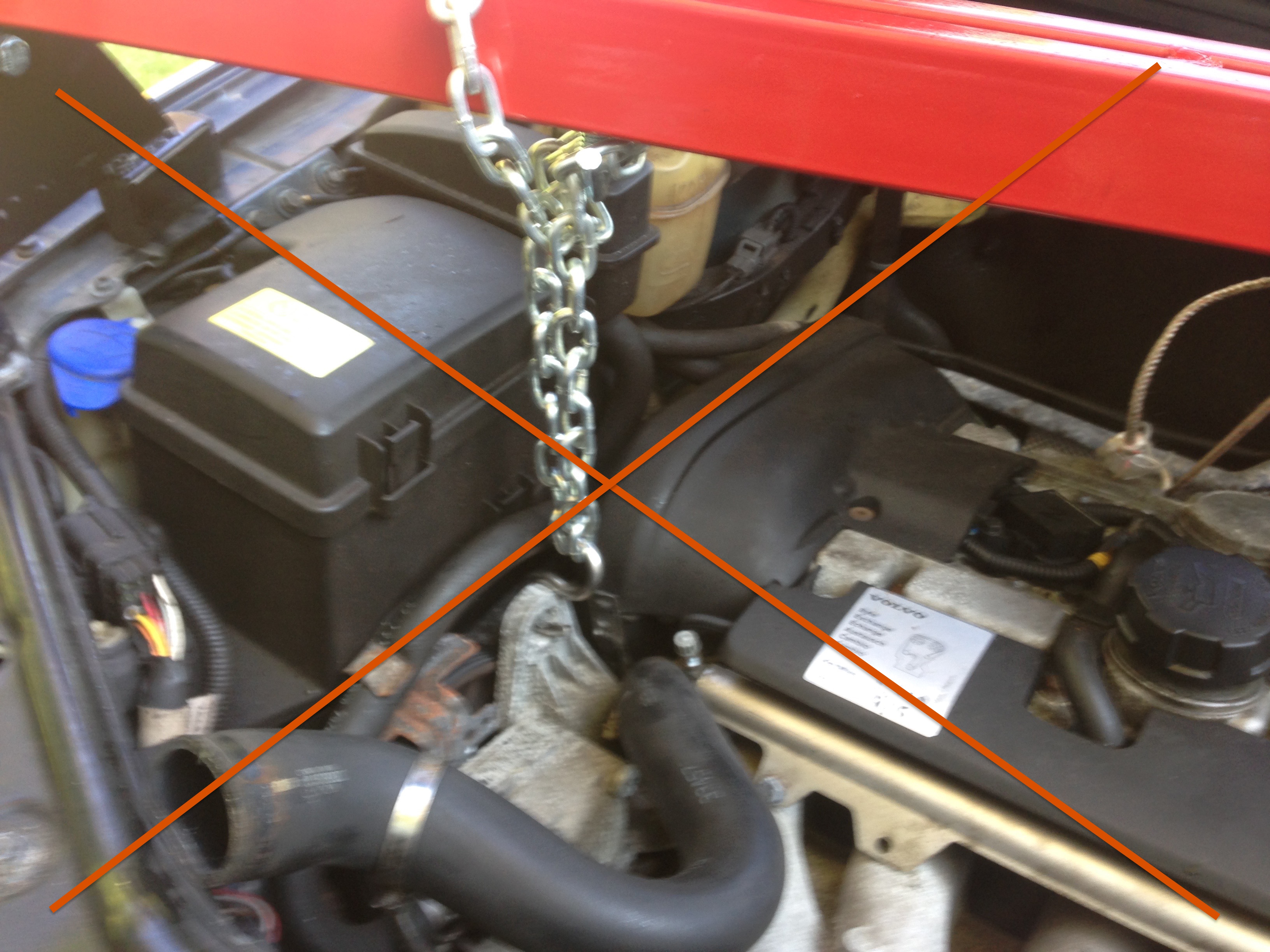

Pictures to come, but nothing gory. I dodged a big bullet with this one (for damage, not safety)
One would thing with my experience attaching, tying down and loading I would not have made such an elementary mistake, but its the last time anyone here will make it.
The hook slipped off and luckily I had lumber under the motor so it fell about 1 inch, and was also slowed by a pinched hose. I since positively attached it to the links with chain and threaded bolts with lock nuts

Thanks for posting that as a safety warning to others. S hooks aren't rated for holding much. You need a closed shackle to pick up any appreciable load safely. S hooks are widely available and cheap so they're tempting.

Those S-hooks have never looked dependable to me. I wonder if that's why EricTheCarGuy uses old seatbelts? Glad you're OK, my friend. The last person to tease me for having too many jacks under the car when I was messing around lost out on free labor. The Volvo life is amazing. But a long Volvo life is even more so.

When I started the load the S hooks were nice and vertical, but as you can see they quickly worked around to horizontal, and then slipped. The chain with the HF engine bar is a bit small for the app,I couldn't find a good shackle that fit the chain and the engine mounts.
I'll be loaning this tool out with bolts and lock nuts that do fit, though
