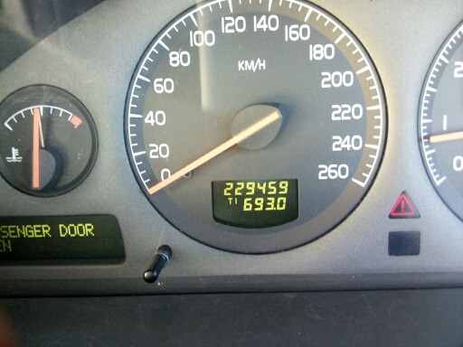

Post by precopster »
OK pic 1
I started today's driving with 680.1 on the trip meter.

Post by cuhfs »
Took some wiring and a satellite technology hack, but as shown above the live stream odometer cam is on :o .
