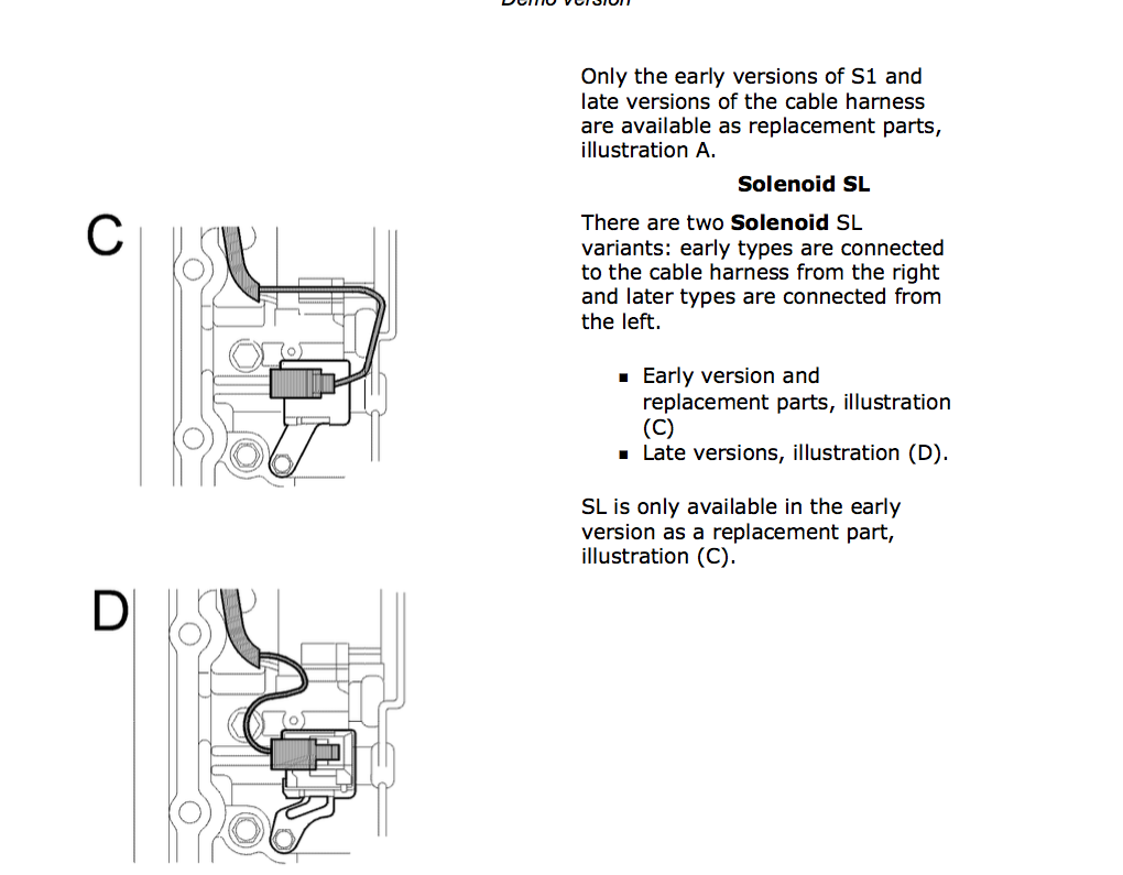

Hy Mr DETAIL,
I've read the entire post, found it interesting. Because this question about keep or junk it is a question I've asked myself recently, that I've concluded by "keep". You speak about solenoids. Do theses pictures may help ?
I may have more informations by MP if needed.
Best regards.
ManovloV
Best regards.
ManovloV
