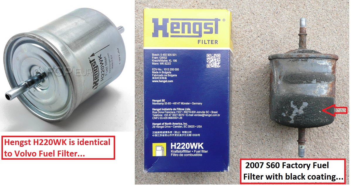

- So Volvo recommends fuel filter change every 105K or so...
- I am the 3rd owner of this 2007 S60 2.5T with 115K miles.
- Search the web or FCPEuro for proper PNs as they change with different chassis.
Volvo just complicates things for nothing.
Also, look and measure (the length of the fuel filter) what you have in the car first.
- Hengst fuel filter is about $14 at FCPEuro.
Tip: do NOT squeeze the plastic tabs too much, just enough to remove the connector.
Do NOT use pliers, just your fingers are good enough.
Squeezing too much can damage the plastic tabs, creating a much bigger headache!
1. The Hengst Fuel Filter is identical to Volvo.
I removed the rust on the Volvo Fuel Filter but could not find the name of the mfg.
Might have been Mahle, Mann or Hengst, I don't know.
Anyway, Hengst is a good name, made in Bulgaria...
2. See autopsy photos at 115K miles.
- Filter element is mounted on a plastic cage.
- Simple design, fuel flows in via the serrated edge of the plastic cap ---> through the
filter element (itself not too bad at 115K miles) ---> to the inner core ---> outlet ---> engine.
- No 1-way valve seen.
- The wall is ~ 1mm thick, good enough to survive 15 yrs/115K with some surface rust but
no leak bc of rust. You can always spray some primer paint before installation if you wish.
