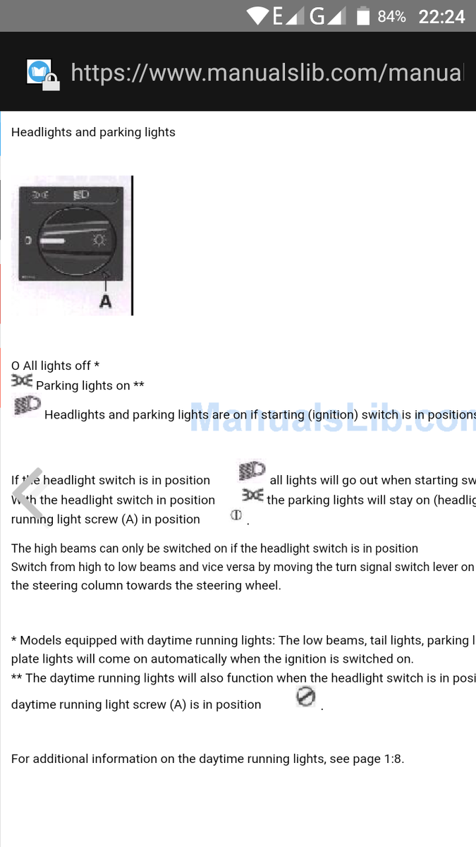

Yes we have!
All explained in user's manual.

Maybe go back to the JY and find a switch that does have the "A" screw, misha pointed out?watchmaker_of_death wrote: ↑10 Dec 2017, 09:54 I changed the switch with one from the junkyard, because I thought it was it the issue. Same problem.
It's in my car too, and I live in Denmark.
