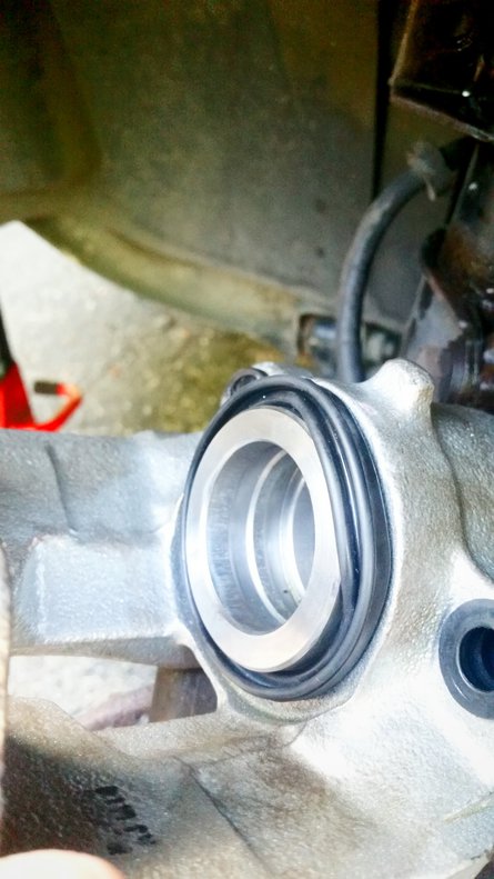

Hey guys, I'm replacing my front brake calipers today, and got some reman from FCP. Looks like the piston boot/seal isn't seated properly on the front right one. I'll attach a picture.
If I go ahead and install it, will it reseat itself or am I just asking for trouble?
Is there a way I can reseat the boot before I put it all back together?
New front brake caliper, bad piston seal??

Is there a way to push out the piston without an air compresser?
I reconnected the caliper to the brake line to stop it from leaking. Can I push it out using the brake pedal?

Well, good news is that I reseated the piston boot.
The bad news is that I can't for the life of me loosen up the top bolt on the caliper bracket. I'm on my way to get a torch and hit it with some heat. It's soaking in WD40 right now, but if this fails, I'm not sure what I will do...leave the old bracket on? I'm so close to rounding the bolt.
