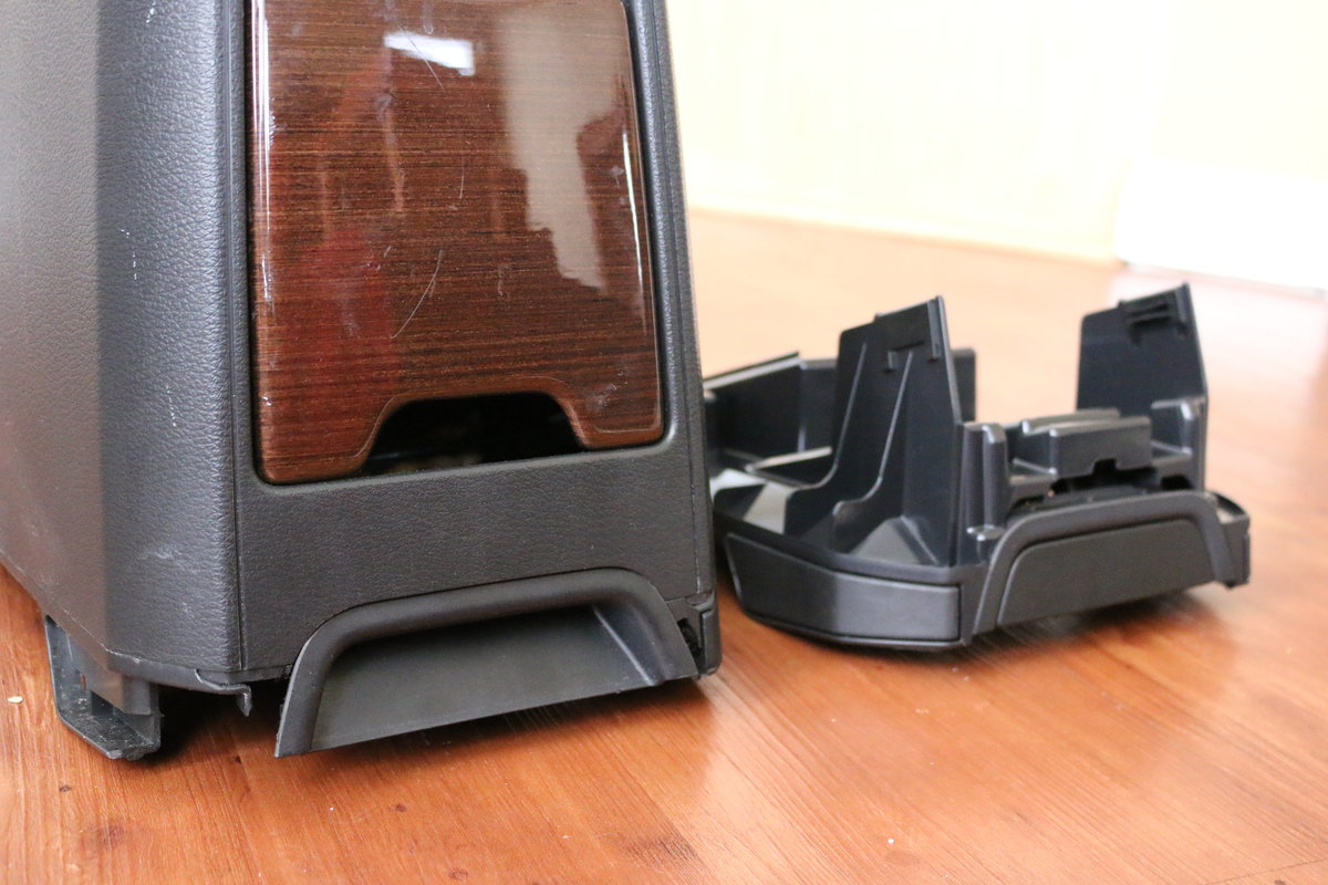

There are different part numbers depending on your model year and interior color. You are looking for the bottom panel of the rear console, which contains the spring mechanism and latches that hold the rear section to the floor. I have a 2006 2.5T with a black interior, so my part was 39853012. Here’s a photo for reference:

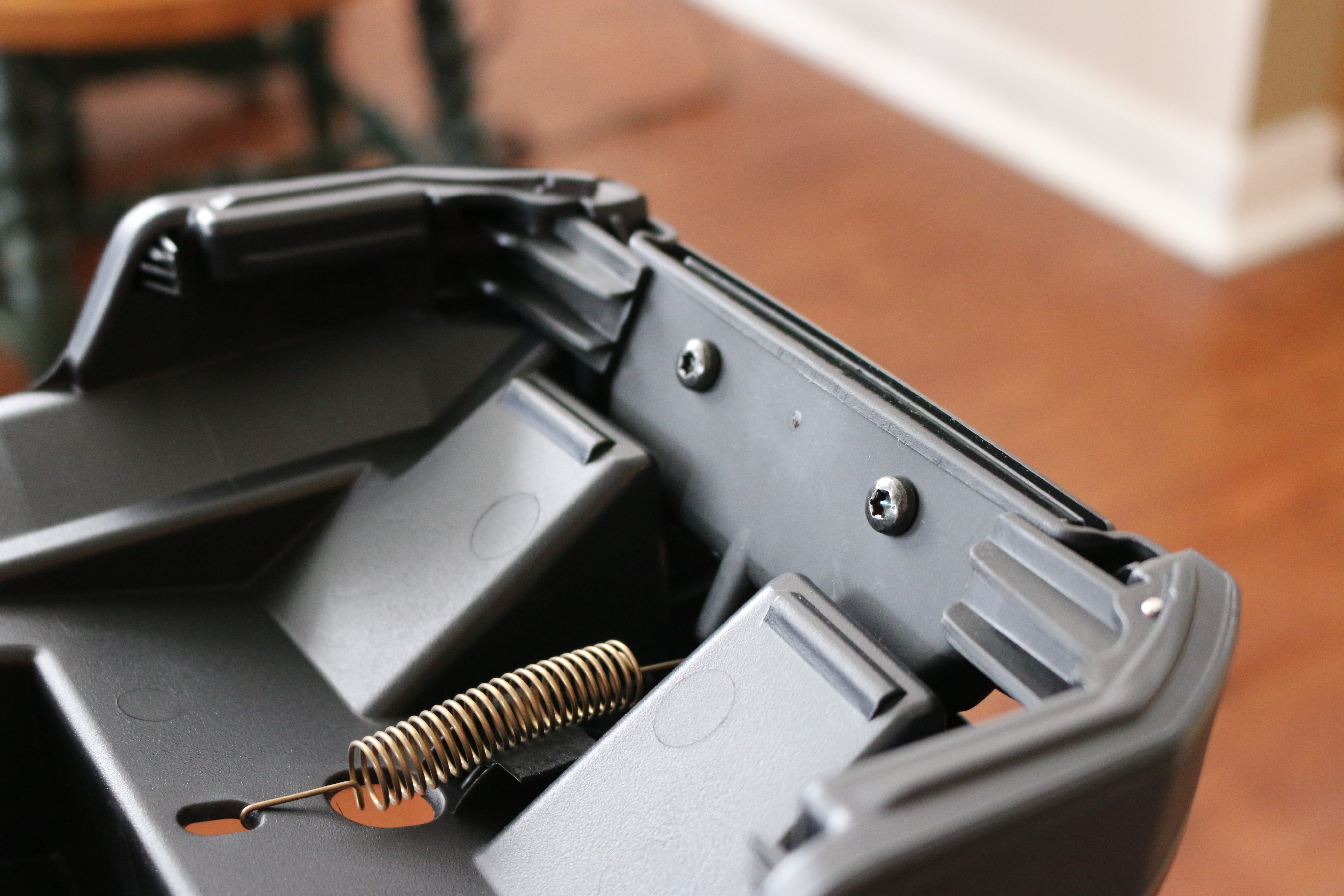

The cost was about $100 for a new part. Hopefully that will provide enough info for others to find the right part. When getting the new part, first thing to do is unscrew the 2 torx screws in the cap that covers the console release handle and protects it in transit. If you don’t do this before installing, the rear center console will be permanently locked to the floor. Not so bad, you may say, after dealing with this thing breaking. Well, if you lock it to the floor you will also prevent future access to the panel that allows you to service anything in the front half of the console, so not recommended:

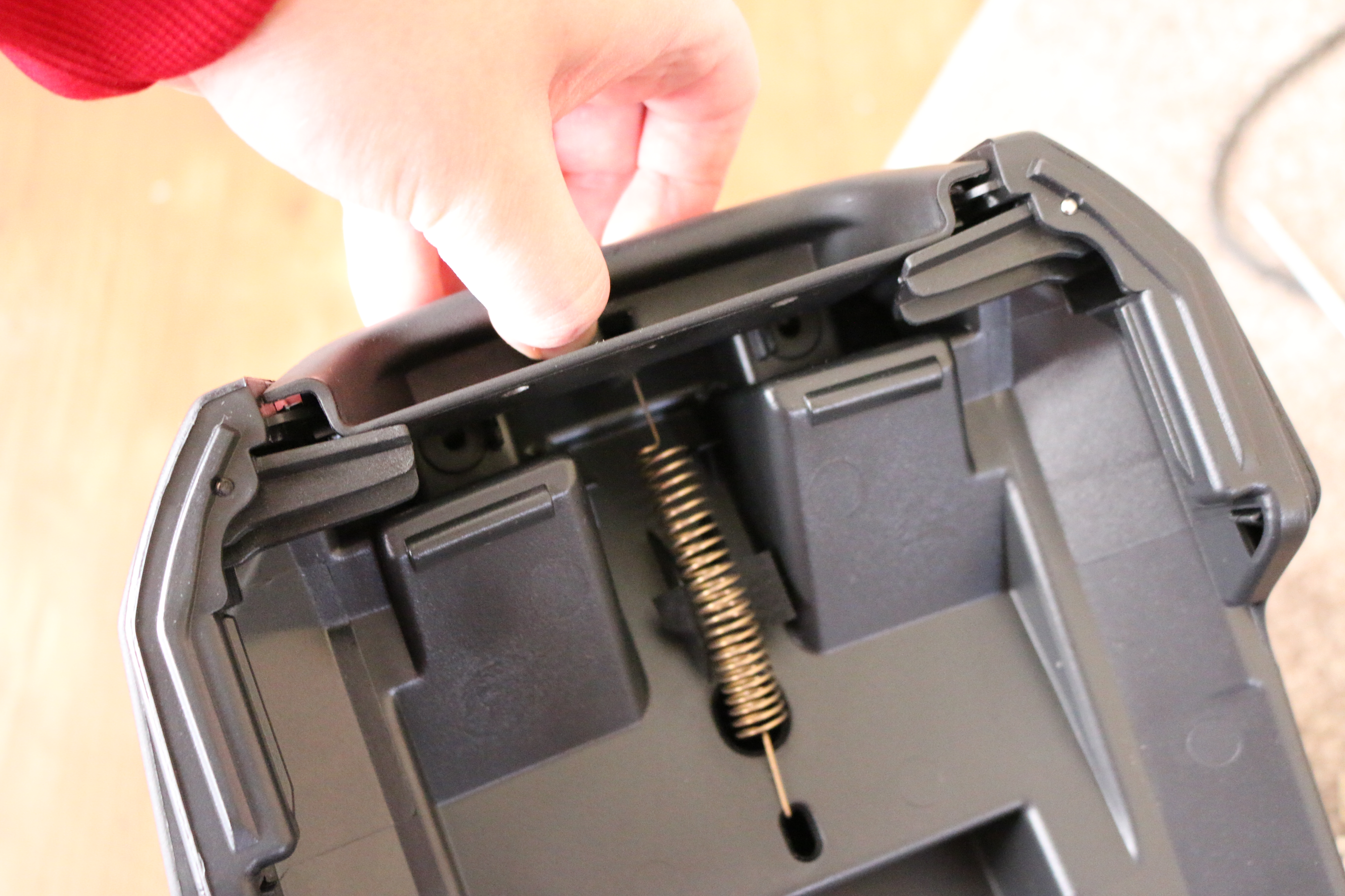

Now, flip the old console to get to the base. It is a quick 6 torx screws to remove the panel. However, two are in a bit of a fiddly spot just under the release handle:
Once you remove these, the panel is nearly free to remove. Note that this bottom panel also holds the track/guide for the cupholder mechanism, so you need to slide out the cupholder and as you do so, take quick note of how it slides into the track/guide on the bottom panel:
Now make the switch. Insert the new part and replace the old cupholder into its track/guide. Secure your 6 torx screws and you’re back in business.
