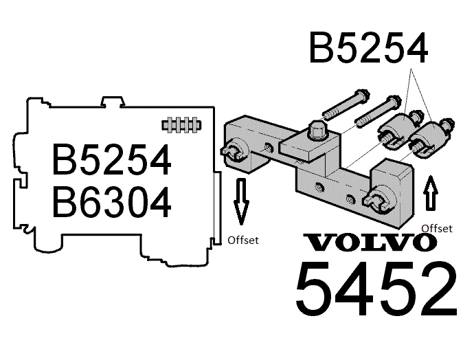

Wizechatmgr- everything I have read and my Chilton manual says you have to put back in same place, I was thinking because of wear? RSPI no I did not use assembly grease I used a little oil does it make a huge difference? I have not installed the belt and I haven't touched the crank since I took the timing belt off three months ago when I started. Richhaleparker- I alligned the cams with the cut marks In the back of engine with intake label down parrelel with engraved marks and exhaust up lined with engraved marks.i haven't looked back at crankshaft since taking off timing belt. Well I will take back off and use assembly grease- what is difference in solid lifters and hydraulic? My Volvo is 99 S70 non turbo fwd 2.4l base

Did you at any point have the cam's sprockets off? If so, did you use the cam locking tool for reinstallation?
If you look at the alignment cuts on the back of the cams, your see they are slightly off center. Both should be installed with the alignment cuts horizontal. The intake alignment cut should be offset above center and the exhaust alignment cut should be offset below center.
