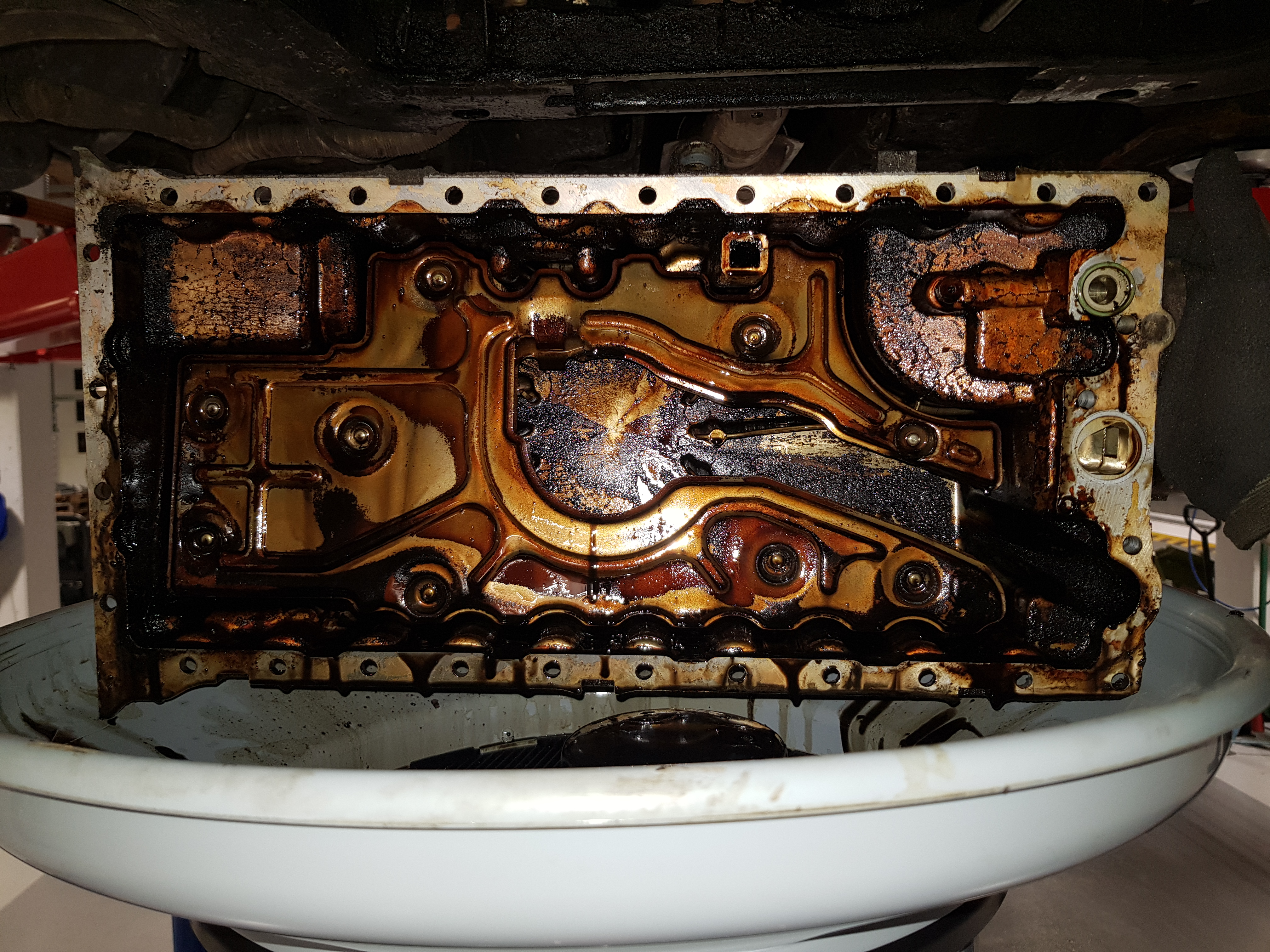

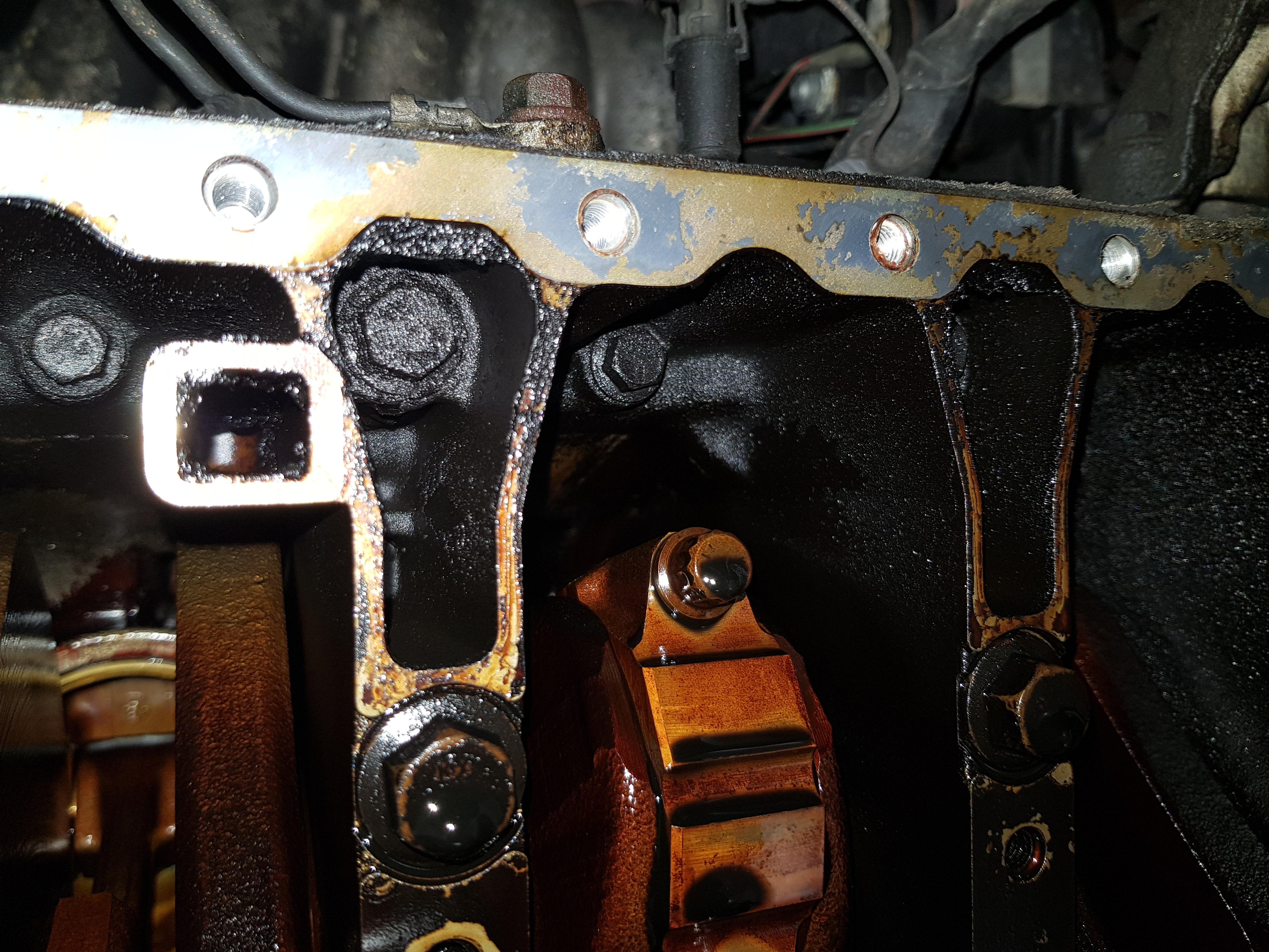

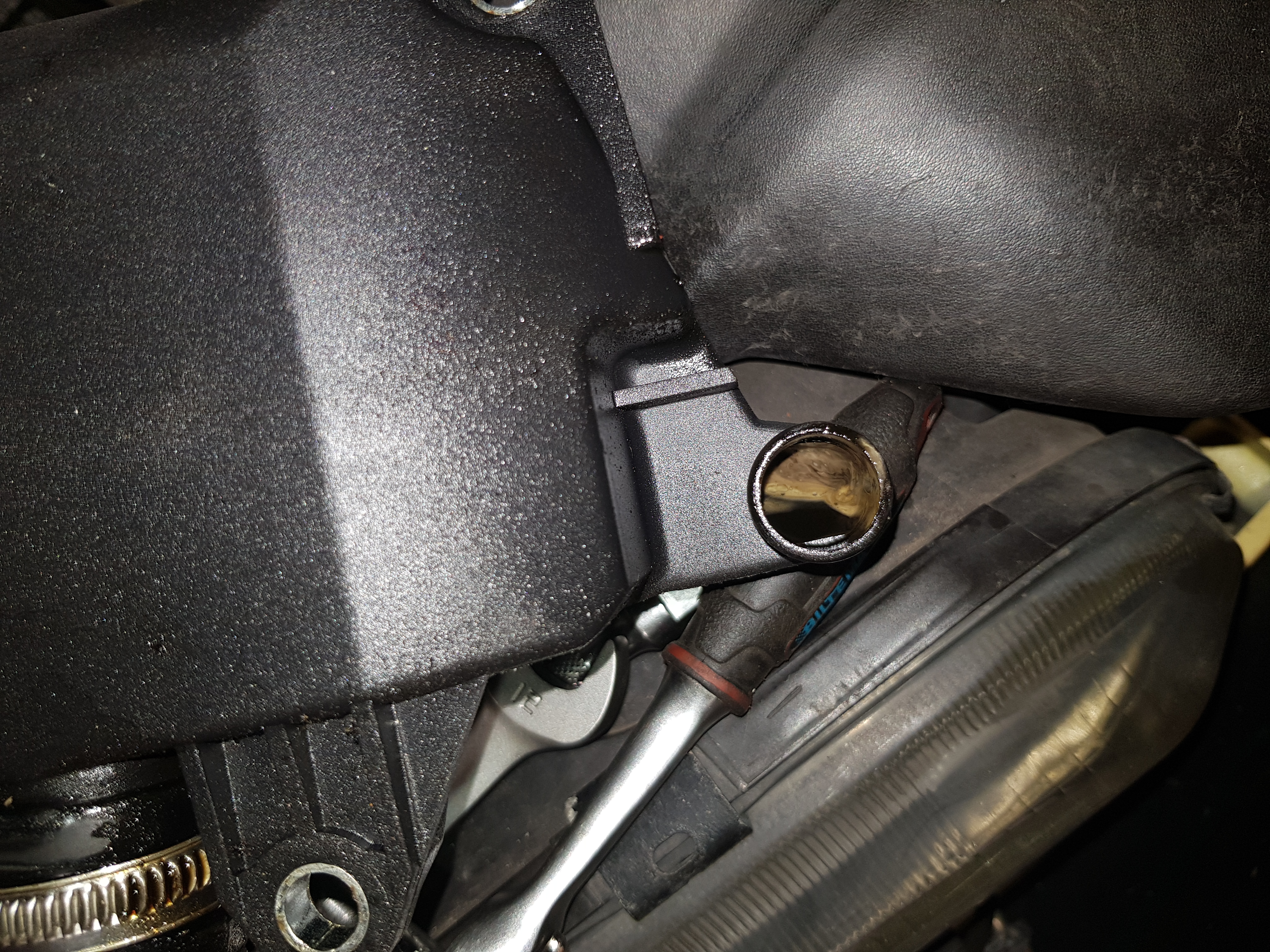

Quick update:
Got the car on a lift today and removed the oil pan - more trouble than I thought it would be.
However, there seem to be a fair amount of burnt oil in the pan which I will clean out tomorrow. But the lower PCV port was about 25% clogged, where the block meets the pan (no pictures, sorry). In my opinion, this wouldn't be enough to create that much pressure in the crankcase.
Tomorrow I will remove the rest of the PCV system to see if anything else i clogged and provide some pictures.
Could the oil cooler lines be clogged and therefore increasing the pressure?
- Ras

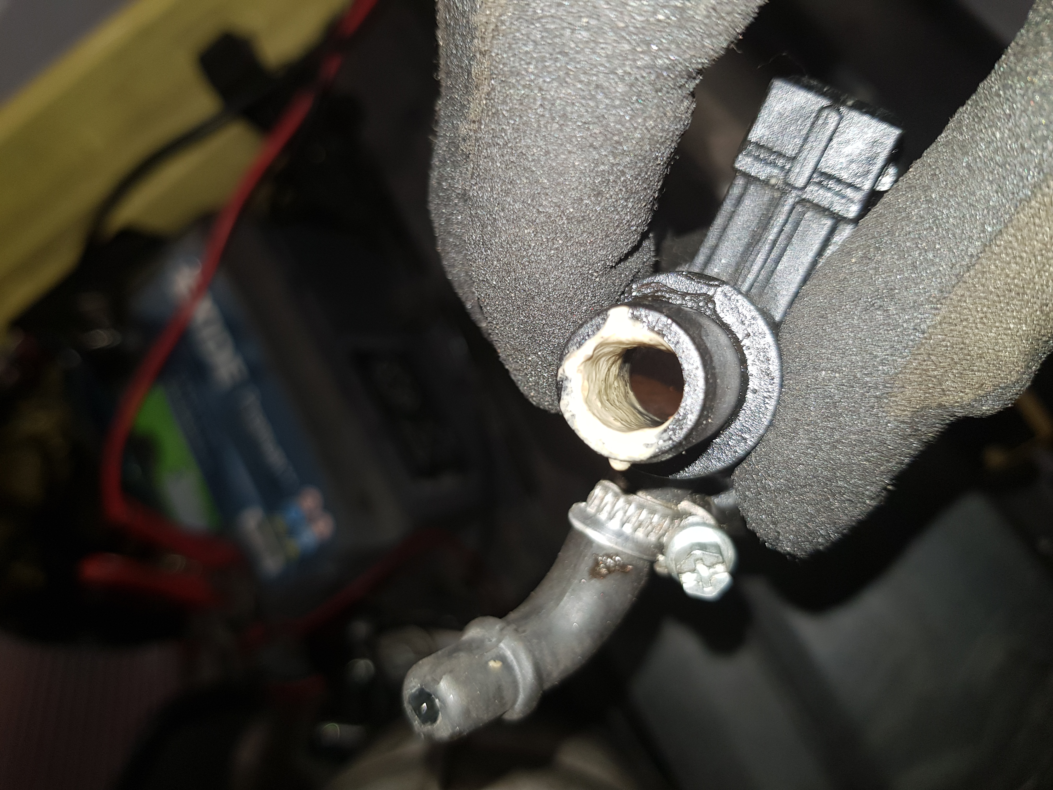

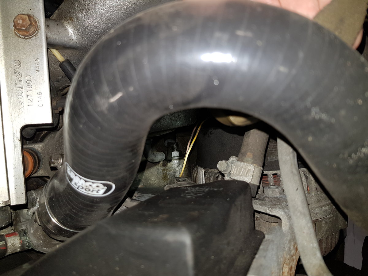

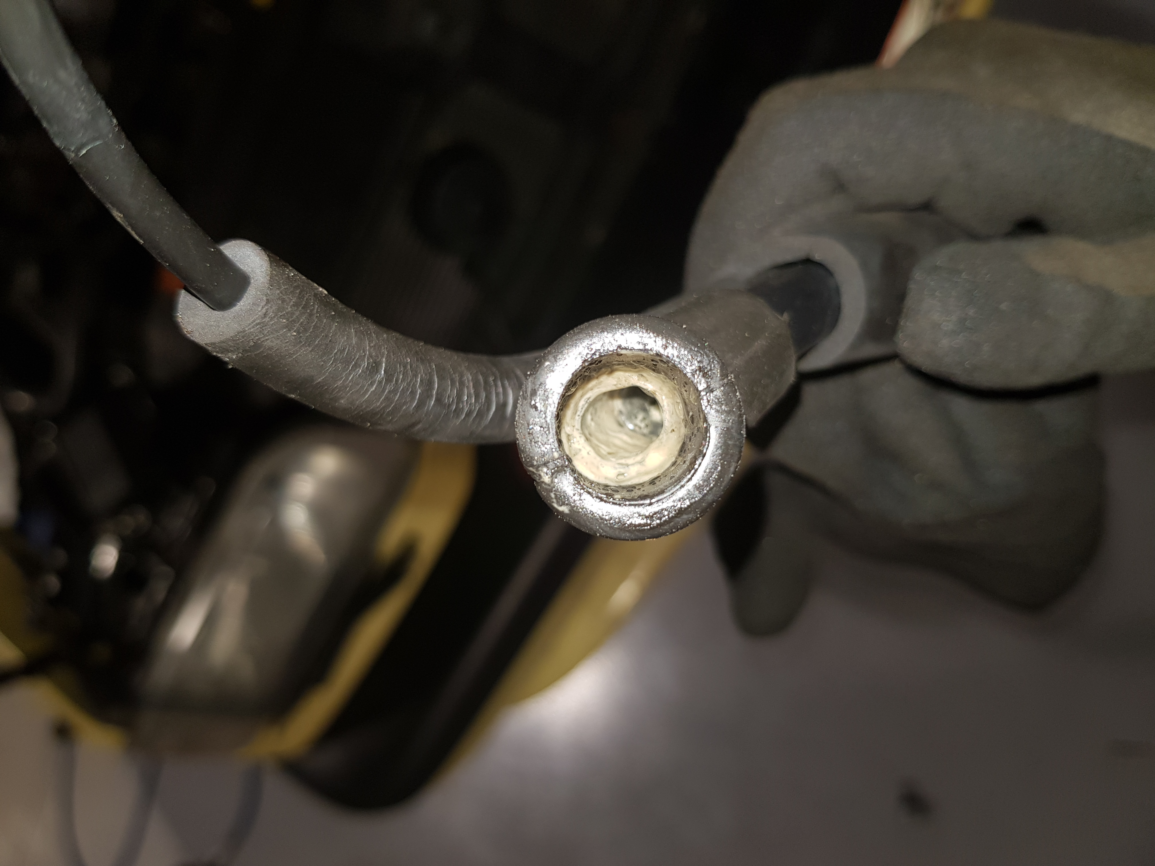

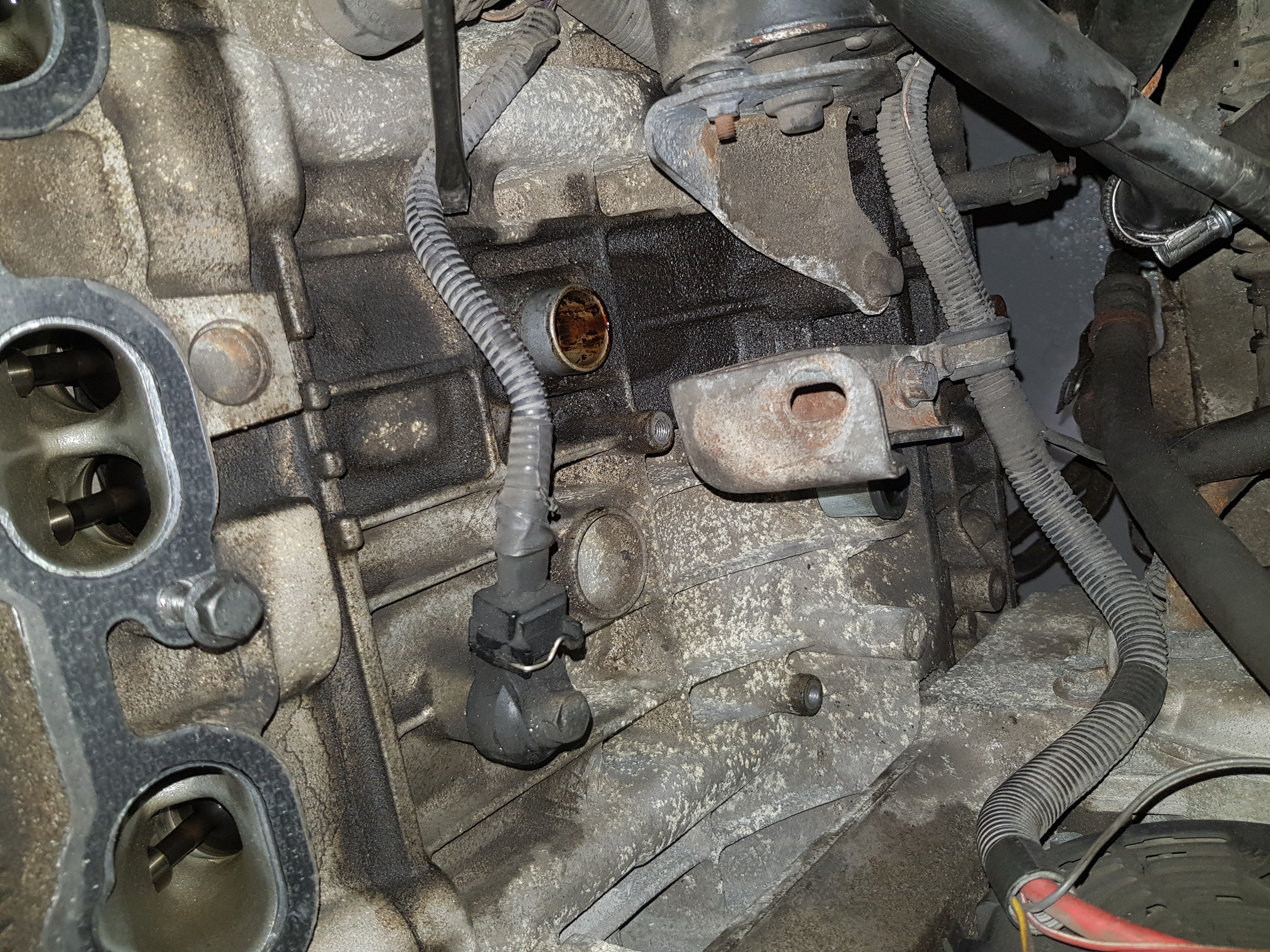

Okay got the rest done today, and here's some pictures:
However, with all this done, the Lamdba light in the dashboard turns on. Tried to reset it, but it return instantly.
I did the glove test - rubber glove on the oil filler, and it inflated, still...
However, the car does not seem to smoke as much, in ilde, as it did before.
I'm at a total loss, I have NO idea what is causing pressure in the crankcase, or why the old PCV system had white oil in it.

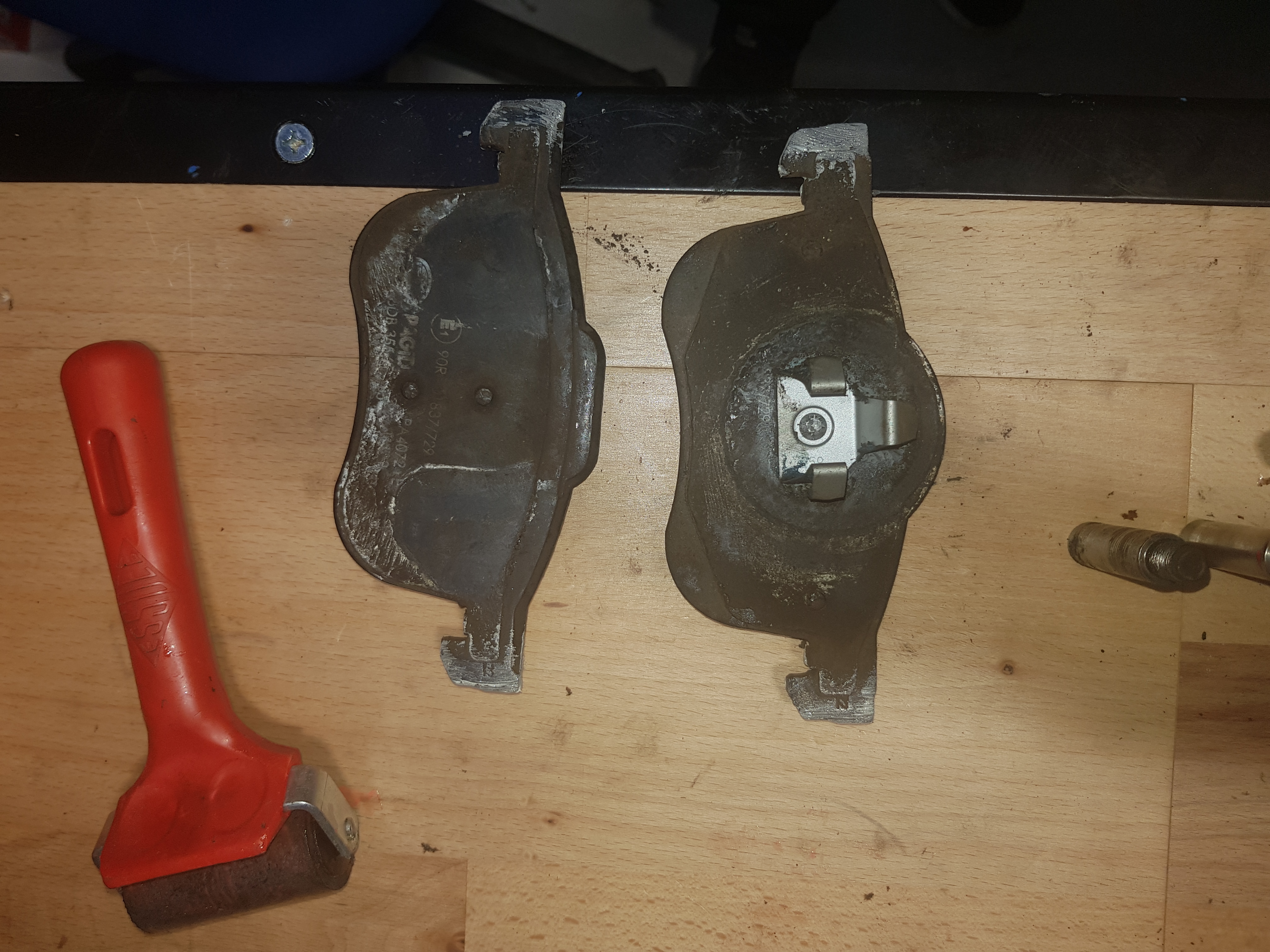

These brake pads were on my front brakes. Brake rotor was a 320mm, while the carrier was from a Volvo V70 2nd generation. I'm quite sure the caliper is from an 850 (compared with other pictures), but the new pads I ordered specifically for 850 does not fit (look at 2nd picture).

Bonus question:
