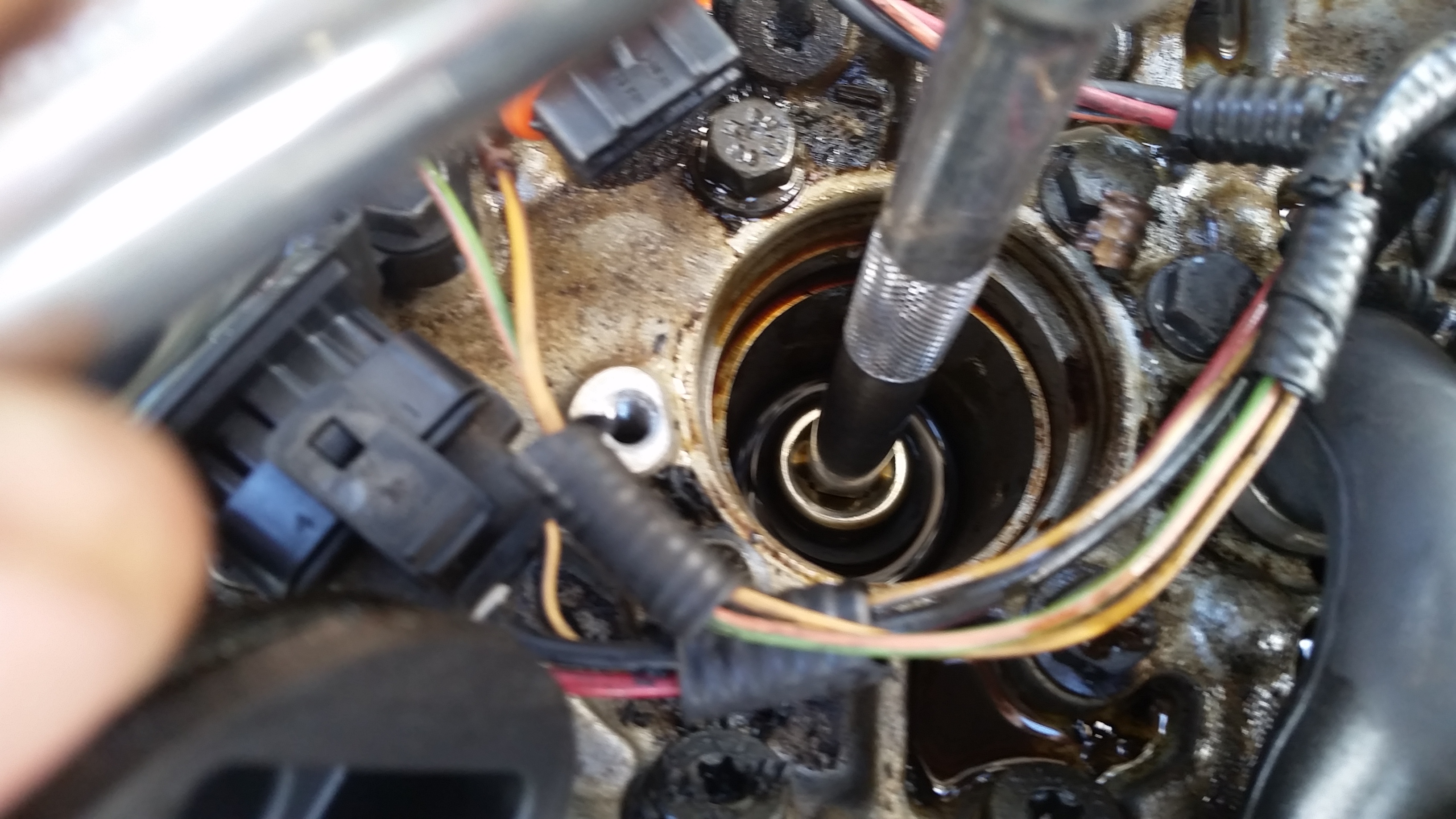

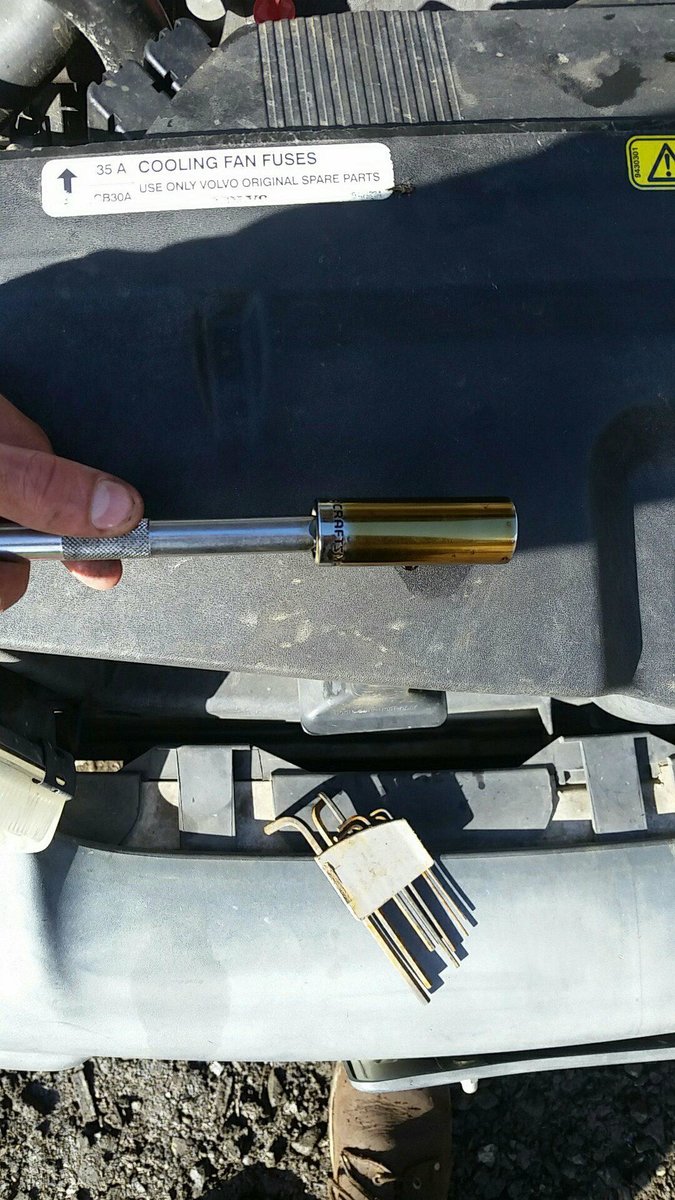

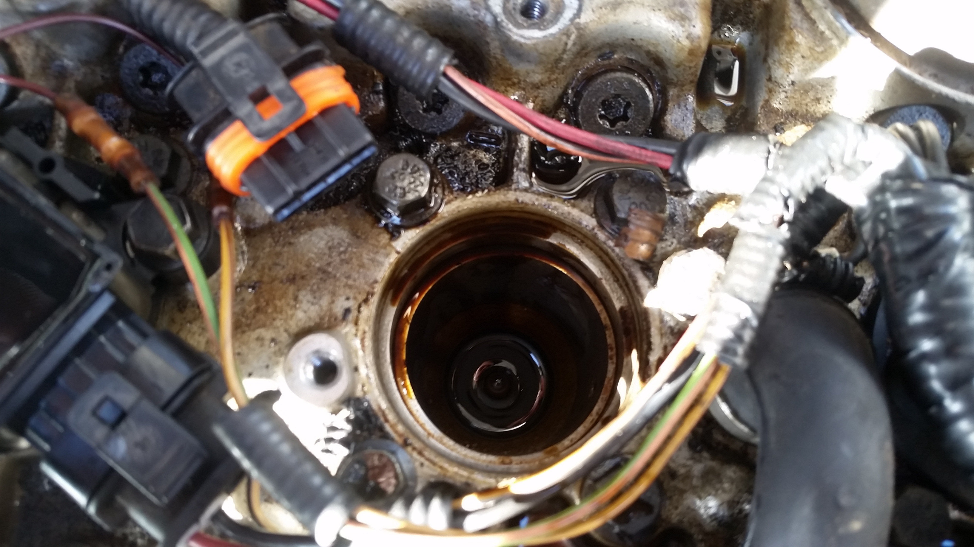

I got a mechanical question...So when I went to do my tune up on my 2000 v70xc, one of my cylinders was full of oil up to the top of the spark plug. And it was starting to happen on another cylinder but not nearly as bad. Any ideas on what needs fixed? I tried getting the best pictures I could, thanks in advance.

This can be one of four sources.
I would wash off the oil at a car wash, add trace dye to the oil, then use a Ultraviolet (UV) lamp to trace the oil back to the source.
- 1. The gasket on the oil cap.
2. The O'Rings around each Spark Plug Well.
3. Spills when doing a Oil change.
4. Lifter adjustment ports.

You have a leaky or overloaded PCV system or oil cap gasket. - look at the oil on top of the cylinder head cover. That area should be dry.
On a 1999+ on, you can also leak oil from the CVVT solenoid(s) nearest the timing belt cover

I had this problem on my '01 V70, and the spark plug tube seals ended up being the culprit. I replaced them and re-sealed the cam cover, and since then all the oil has stayed where it belongs. I was able to find this by cleaning up the top of the camshaft cover VERY thoroughly, then starting the engine, letting it idle, and watching the cam cover until I saw some oil start to seep from under one of the ignition coils.
Prior to this I had also replaced the oil cap gasket and replaced the PCV system in an attempt to stop the leak (for the PCV system I also had other symptoms including smoking oil dipstick tube and inflating rubber glove test on the oil filler neck).

Hold a latex glove over your oil cap, if it inflates it's your pcv blocked up. quick and easy to test first

Im an optimist and think you just have top cylinder leakage - I think the O-ring failure is pretty rare on these cars...prwoods car was just reminding him it wanted attention after a big cross country trip.
Oil on the plug threads is good.
