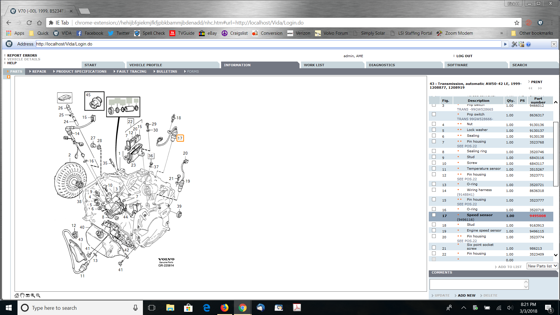

With all the work you need to do, get Volvo Vida+DiCE.
Check the wiring and connectors between the speed sensors and the TCM.
#17 is the Transmission speed sensor and is Volvo part number 9495008.
#19 is the Speed sensor and is Volvo Part number 9496115.

437: TCM-0020 Vehicle speed sensor. Faulty signal. Permanent fault
Diagnostic trouble code (DTC) information
A4300697 Condition
The automatic transmission control module (TCM) receives speed signals from the vehicle speed sensor (VSS) on the transmission. The transmission control module (TCM) uses the signals to select the correct gear. The control module derives and compares the transmission speed with engine speed (RPM) at the transmission. Diagnostic trouble code (DTC) TCM-0020 is stored if the control module registers that transmission vehicle speed signal does not correspond to the transmission speed (RPM).
Substitute value
None.
Possible source
  • Contact resistance in terminals.
    Open-circuit, short-circuit to ground, short-circuit to supply voltage in power supply.
    Open-circuit, short-circuit to ground, short-circuit to supply voltage in signal cable.
    Defective vehicle speed sensor (VSS).
Fault symptoms
General orange warning lamp lit.
Malfunction indicator lamp (MIL) lit.
No lock-up function.
Harsh gear shifting.
Hint: Harsh gear shifting can be caused by:
No adaptation of the gear slippage times at high altitude (High Altitude Compensation).
No reduction of line pressure when shifting.
No reduction of line pressure when moving the gear selector between positions P-R, N-R and N-D.
No torque limiting request to engine control module (ECM) when shifting.
