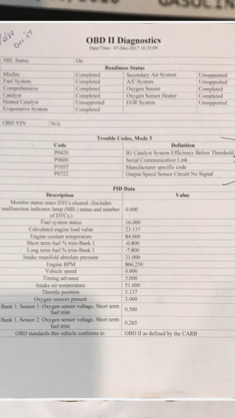

Okay so the codes-
P0722
P1057
P0600
P0420

All lights coming on can when starting can be 2 or 3 issues. ABS module may be failing and that can affect many system warning lights as well as random speedo and odometer function.

My biggest concerns before I take this car are-P0420, is the catalytic converter gone?
P0420 Possible sources
- Air leakage in the exhaust system
One or more damaged injectors.
Damaged catalytic converter.

The ABS units are a known failure problem at old age, but the fix is only$100. You can open it up and butcher it or send it to mattymoo at midwestabs for a good fix.
These cars read the speed using the ABS module and the transmission needs the speed of the car to know when to shift,,,so I'm guessing the abs stone will kill three birds, if you have lead a clean life.
